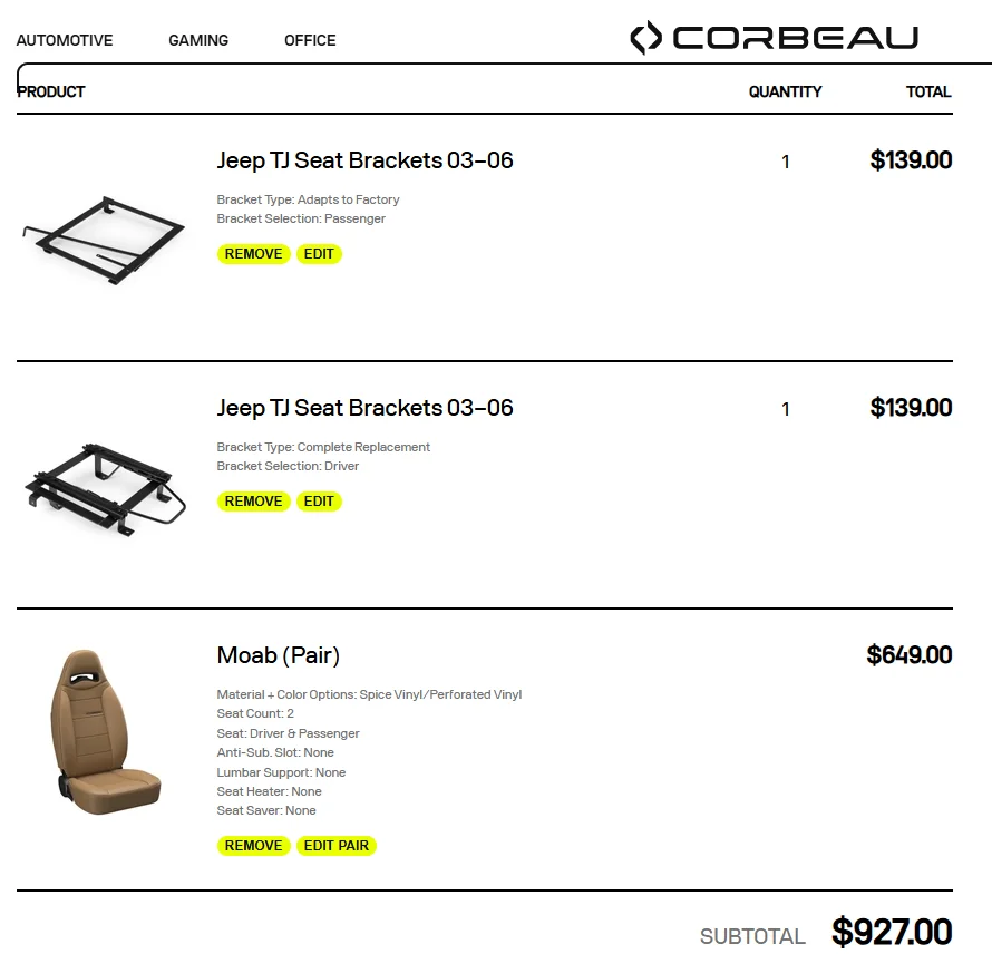

I've been looking for a little while now, couple notes I've gathered from the forum and reviews.
Unless you want to fab it yourself (which doesn't look too bad) you'll need brackets whether you want to retain tumble and fold or not. If you retain tumble and fold (keep the stock base bracket) it adds about 2" of height. My current thought is to do a slider replacement bracket for the driver side and a tumble/fold for the passenger.
The brackets aren't cheap, so make sure you include them in the budget when you are shopping.

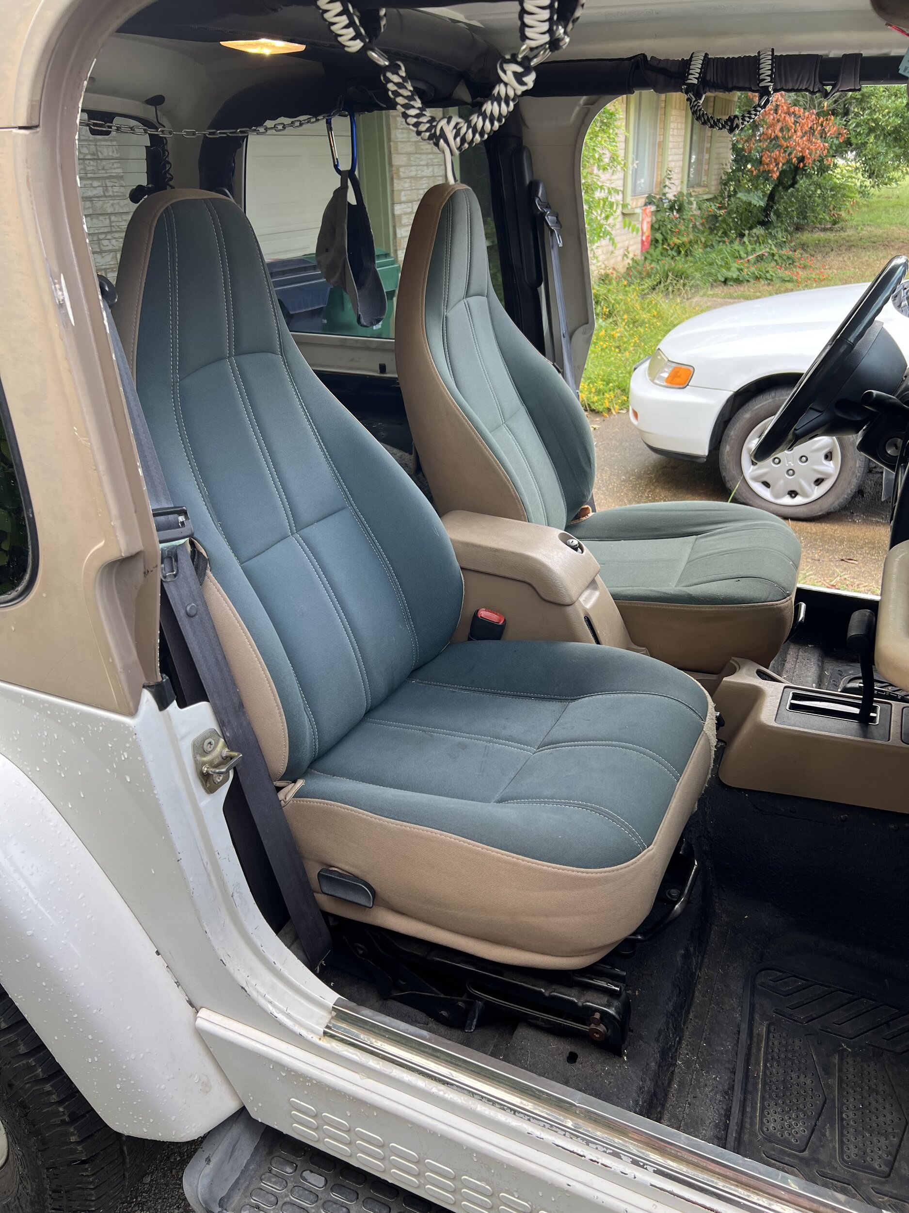

my white '01 Sahara came w/ BLACK Bestop vinyl seats when i got her this past summer
BLACK vinyl seats in Texas are BURN YOUR BUNNS HOT
they did not have the fold butt did have the tumble feature since they were mounted on the stock tumble frames by means of adaptors which are $$$$ in the catalogues
my upholstery guy is also a TJ guy as is one of his employees and they both strongly suggested i go back to
stock seats which are wider than the Bestop seats
in addition they recommended the above mentioned SUMMIT replacement foam bottoms
i sat on their seats and had to agree w/ the quality of the new foam
after a coupla road trips i was able to acquire enuff seats to provide them with/ all the framing and stock upholstery to recreate a full set of stock appearing factory Sahara seats only needing to replace the seat bottom foam w/ the SUMMIT products
had i desired the vinyl seat covers i would have been able to gather them from closer sources and for le$$ than the stock green cloth ones that came in the Saharas which i like
i maintained the stock fold n tumble feature and now have a set of seats that look like a low mileage vehicle might have
i drove them on a long trip and was completely satisfied w/ the results EXCEPT for the OP's spec of being WEATHER TOLLERANT
a set of skin diver suit slip covers were added and the results make my Larduss Bottomuss Maximuss tells me i dunn a real well job

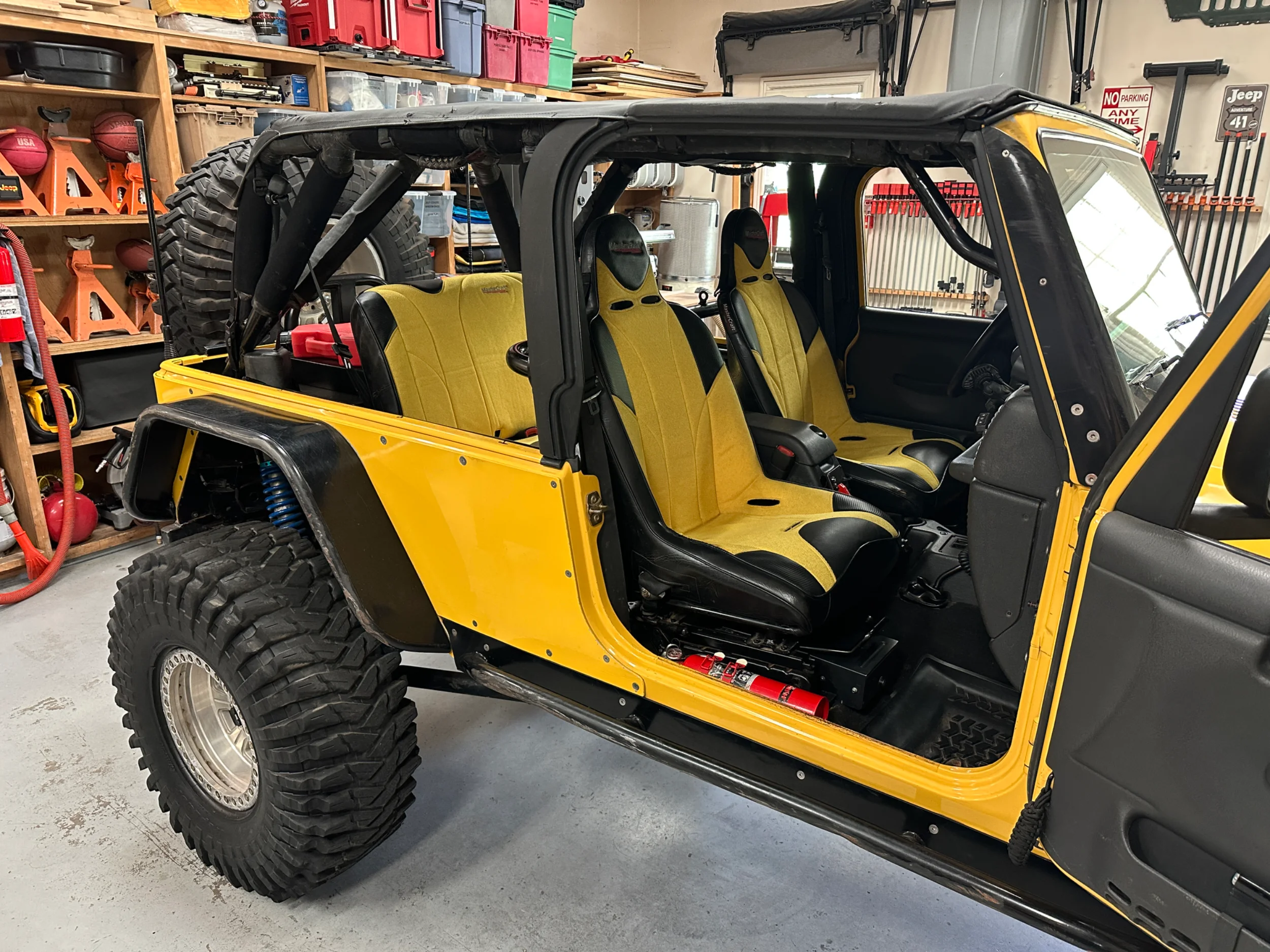

My seats work well for me because they aren’t as restricted in the hips and sides (by a hard shell) like the non-reclining options, and they don’t have aggressive bolstering like the PRP elites and many other options I looked at.
Even compared to the MC Baja RS that I almost purchased and would like to try someday, you can see that the PRP model I have is less aggressive (flatter) in the hip area, which is likely better for me. For the record, I don't like any other PRP option than what I currently have because the other models squeezed my hips and sides too much and generally felt uncomfortable.

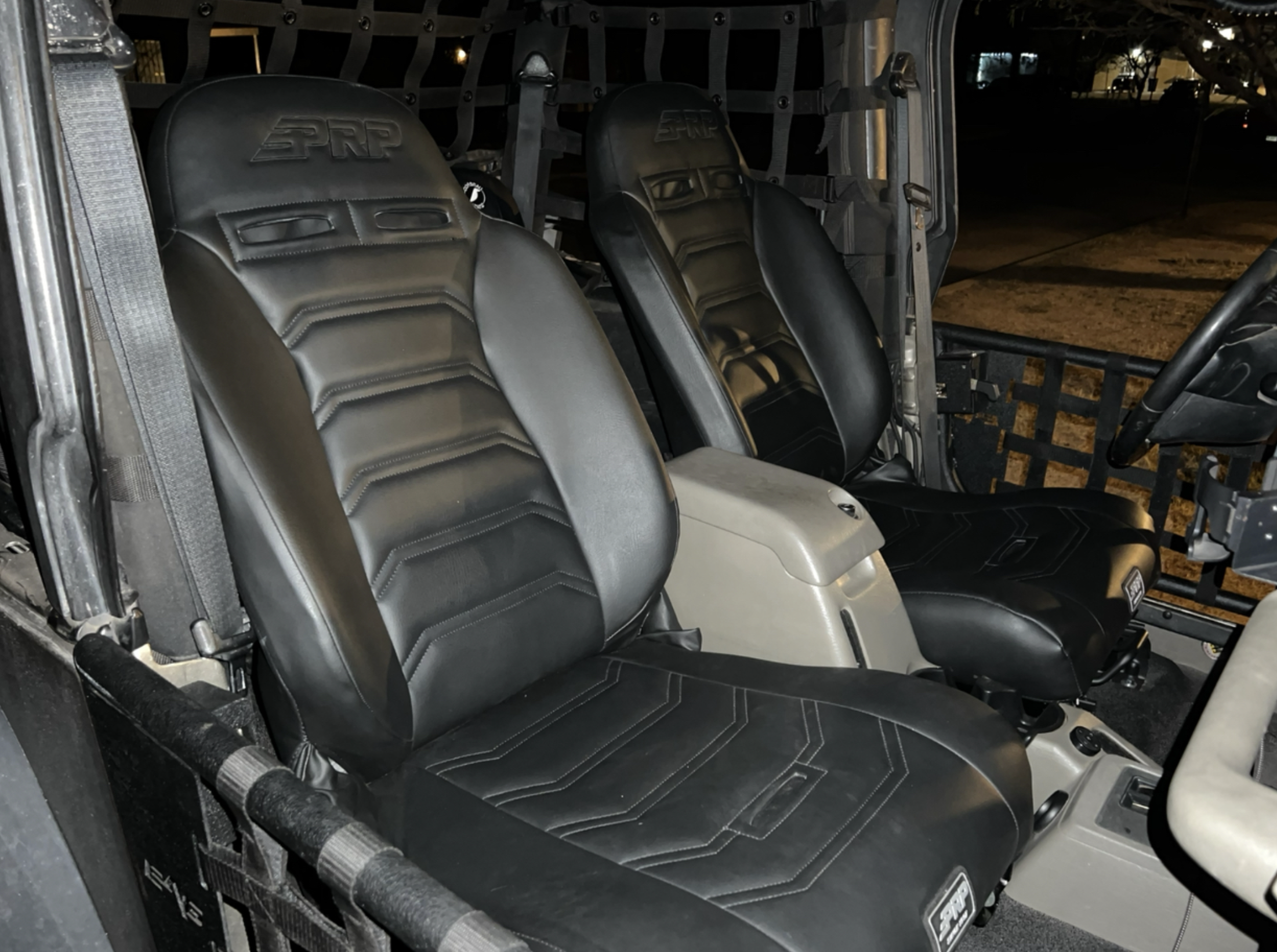

Older shot of my seats in case you are interested (PRP Enduro High Back Recliner...Non-Elite)

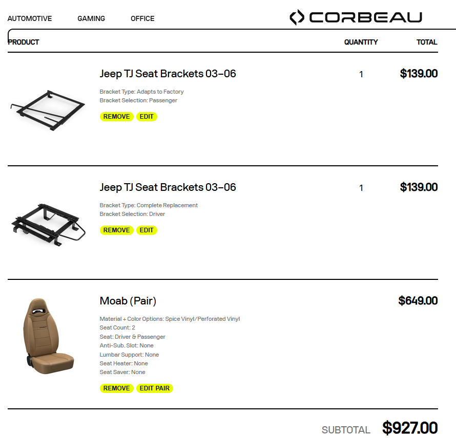

After my chat with the upholsterer, I'm now leaning back towards the Bestop Trailmax 2 or a Corbeau set then just rig up something using the stock brackets for the fold and tumble function. It'd be way cheaper than custom or going with PRP.
I have had the Corbeau Trailcats for a couple years now. My Jeep gets a fair amount of seat time and still super happy with them... way better than stock. I have the bases that allow the seat to flip (passenger side only, my driver side never flipped). Couple things to keep in mind, if you get the bracket it raises the seat. I'm only 5'8" and my girlfriend is small so that was good for us. The release bar to flip forward is kind of janky and is easy to bump and unlatch sending your passenger through the windshield on quick stops. I found an easy fix but it's something to be aware of. The seat backs/headrests are also taller & wider than stock creating a bigger blind spot. All that being said, I'm still happy with my purchase
