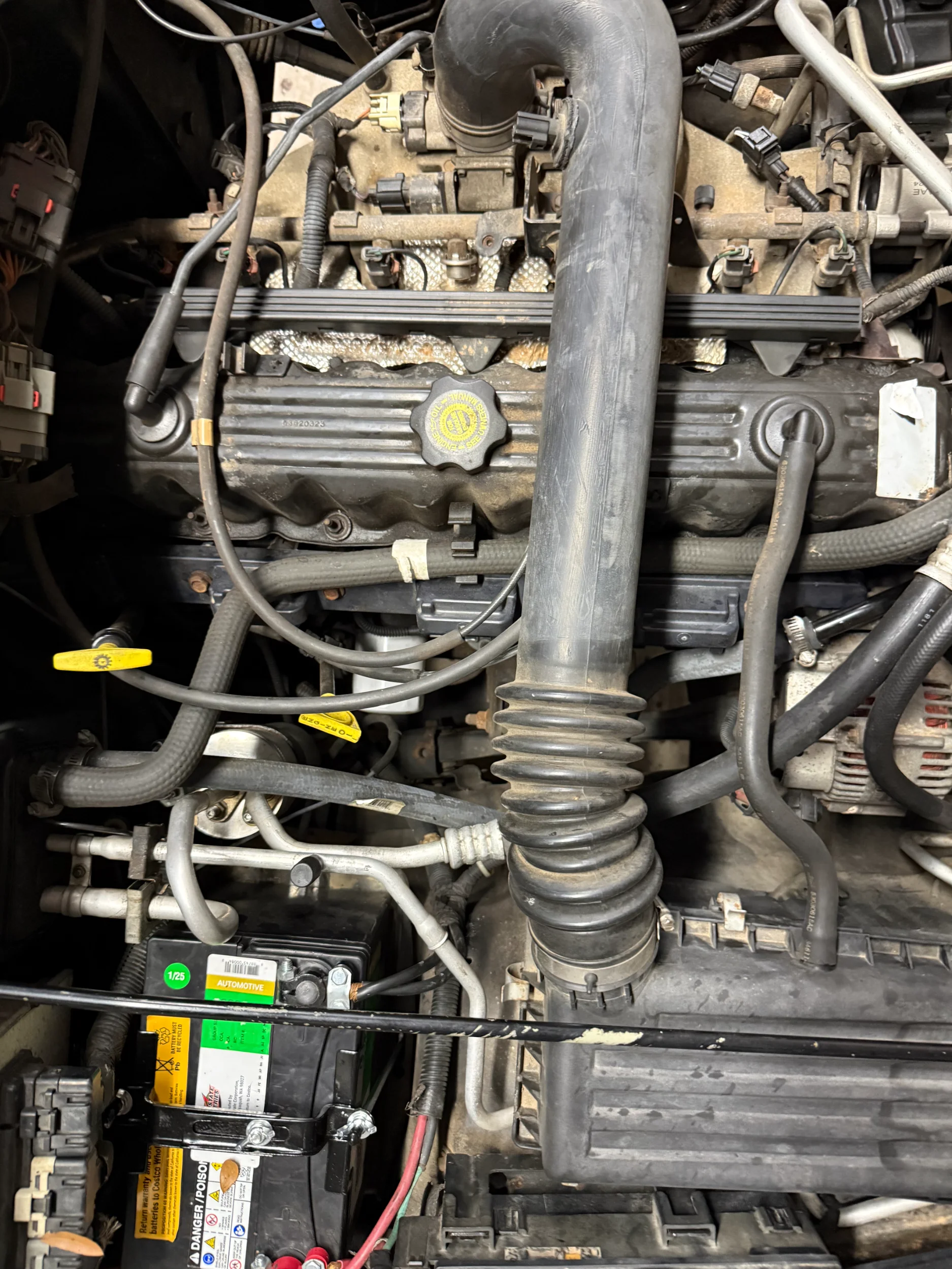

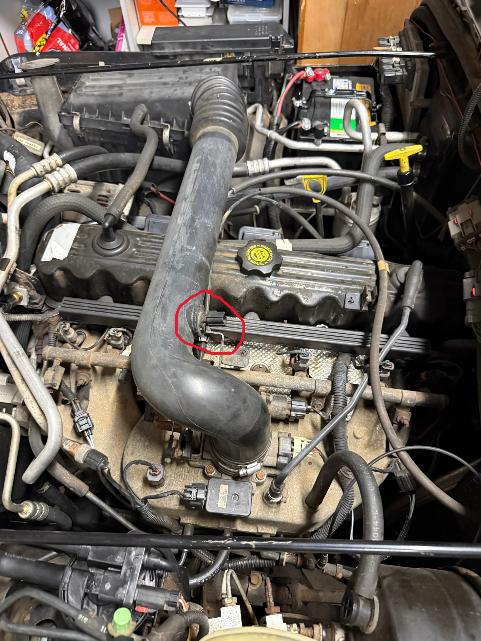

I was just curious if I had the correct air box and hose assembly on my 2001 Sahara with the 4.0. It has a connector on the backside of the hose (circled in red) but there is no connector in the engine compartment to connect to it. I've also noticed that other wranglers have a hose that comes off that same location and goes directly into the valve cover. Just trying to learn a little and fix up a jeep that wasn't taken very good care of by the previous owner. Thanks!

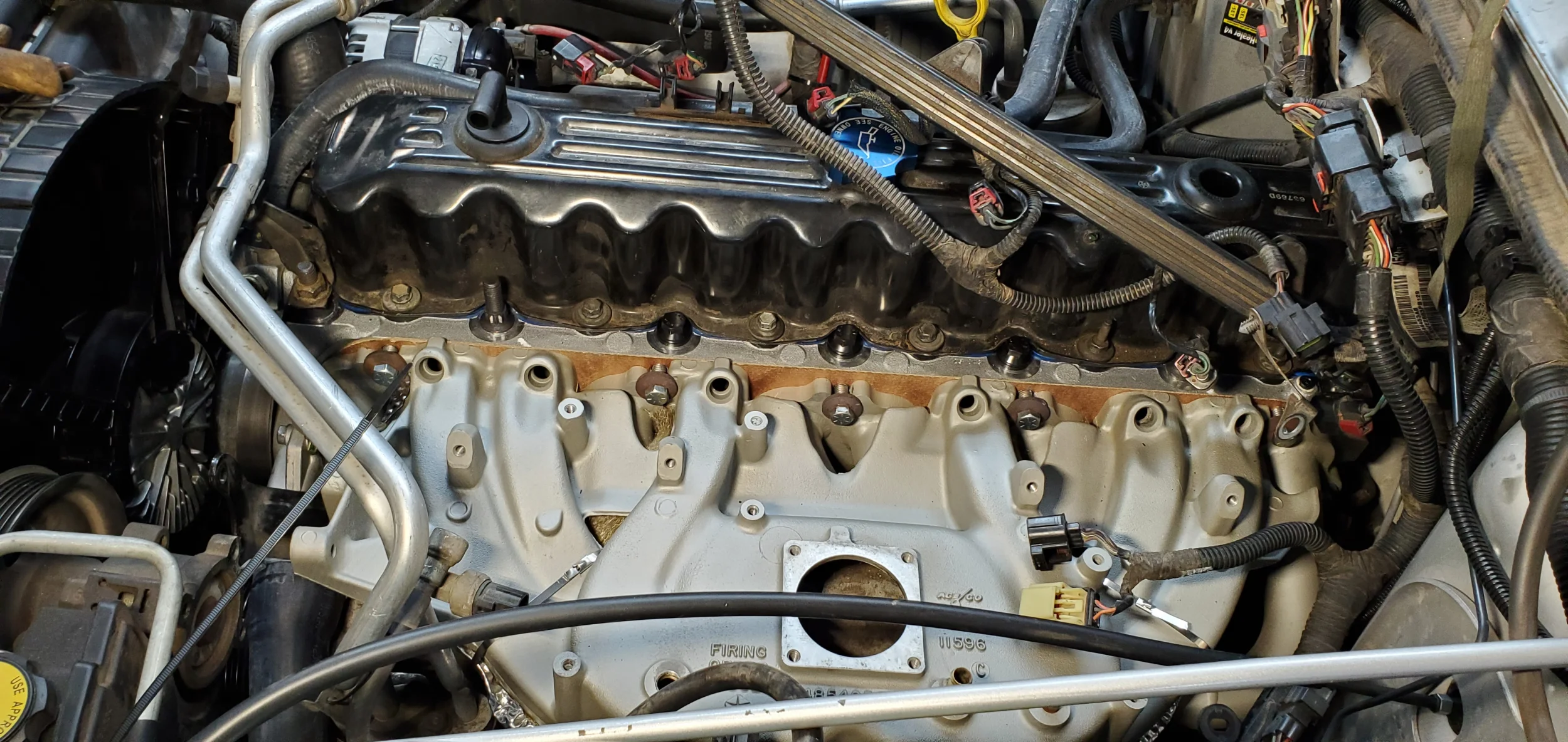

You have an 05-06 intake hose. The sensor is a IAT sensor, 01-04 had the sensor in the intake manifold. It is present in your second picture at around the 8 o'clock position from the Throttle body. You should have 0 issue running an 05/06 intake tube as long as all of the vacuum hoses are routed correctly.
Thank you! I thought it was strange, but I haven't had any issues driving it as the vacuum hoses are all installed. I may try to swap it out in the future. Not a fan of most CAI though because there is just so much heat under the hood.
The IAT in the 05/06 intake tube won't harm anything, but doesn't have a provision for the crank case ventilation in the same location as stock 00-04.
Lots of little differences in the intake in the 00-06 era.
03-04 intake has the same IAT position as your 2001, but I believe different bosses cast into the intake to hold part of the wiring harness. You can see the threaded port for the IAT here where it is a blank in the 05/06 casting above.
While it is said that the IAT location in the 05/06 is beneficial to get lower intake temp readings and prevent spark retardation due to heat, in the 97-04 JTEC PCM, this is one of only 2 defenses against high temps causing knock. No TJ 4.0L has a knock sensor. The 05/06 was programmed for that IAT sensor location, while the earlier models were not. I'd stick with the stock IAT as you are. Use the 05/06 with caution as it likely will not pull back on timing.
