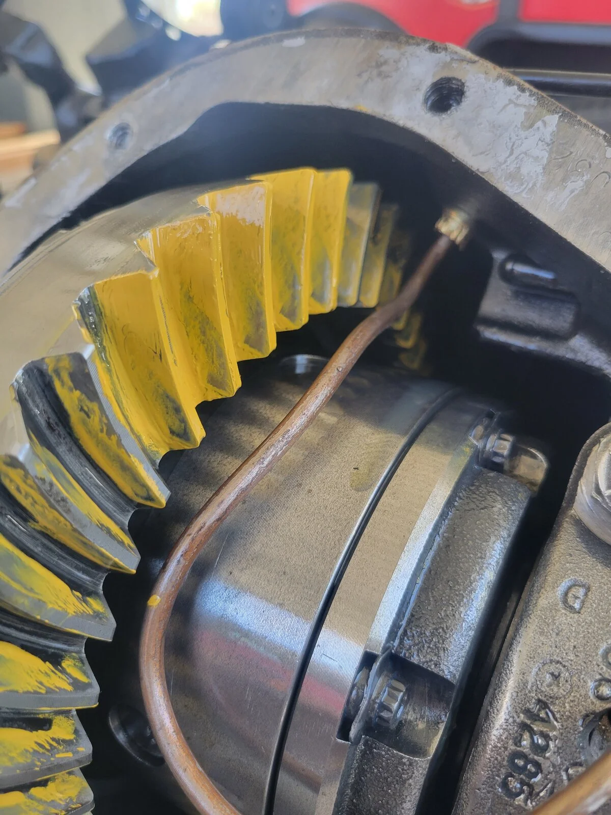

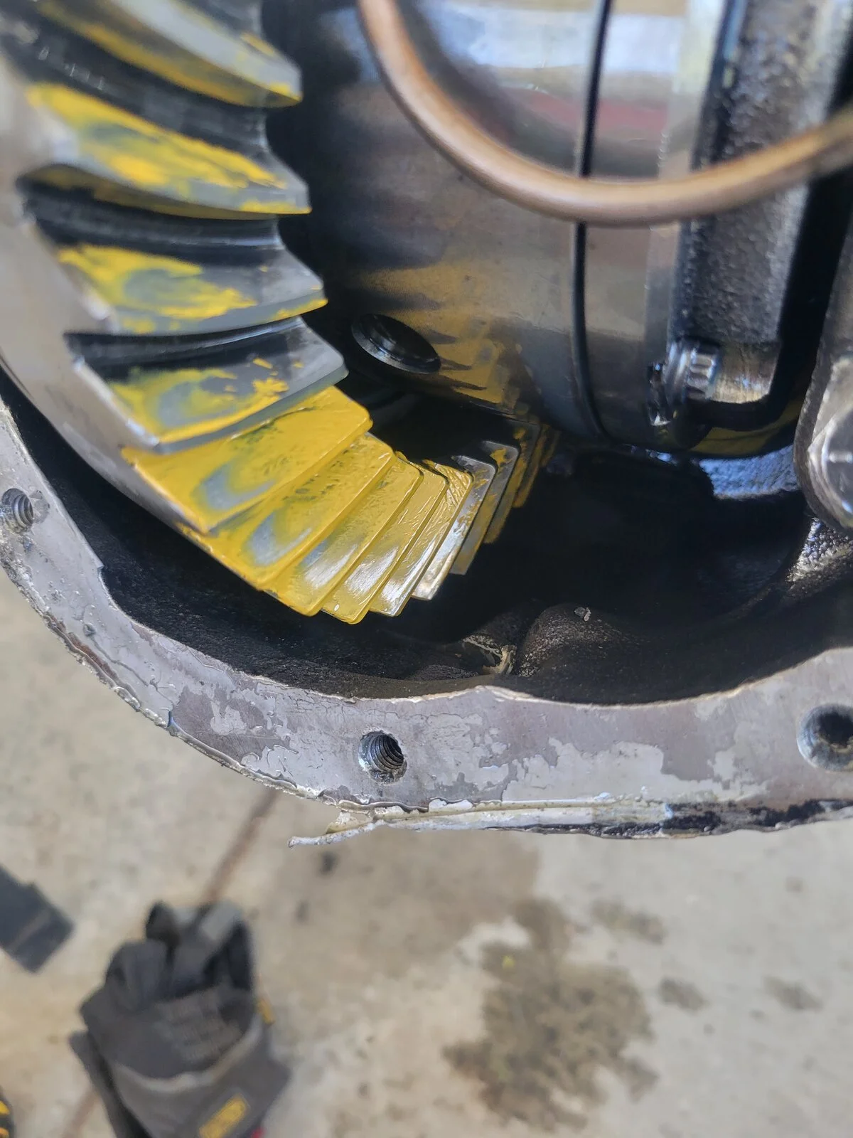

Worked on cleaning up the rear diff and ran a gear pattern. Drive side seems toward the toe and coast side is toward the heel. Don't seem to be touching the peak or root.
Now, of course, I never set up gears before so I don't entirely know what I'm doing. Not sure if I put enough drag on the ring gear while running the pattern or how that might effect the pattern. Also, from my searches, it looks like with used gears (these are secondhand axles, after all) once they have worn in a pattern, there's not much to do but run it or replace the gears.
What do yall think? I'm leaning toward running it but knowing in the back of my mind I may need to replace the gears at some point in the next year or so.
