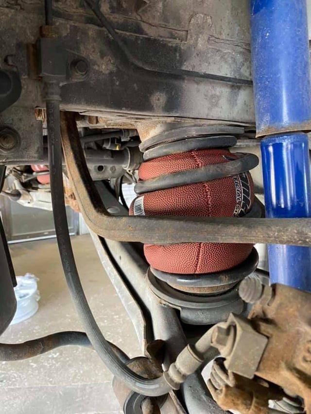

Has anybody put a full air ride suspension on a tj? I bought a 97 with a 4” lift and it rides like a square wheeled wagon, I put the AirLift air bags inside the coil springs and they definitely help, but I want a true air ride.

The Airlift kit you installed is to increase weight carrying capacity and does NOTHING as far as ride quality. If you have those air bags pumped up that is going to make your ride worse. Think of them like the air bags on a 1ton pickup when hauling a camper. When no load in the bed you drop the PSI to 5lbs.

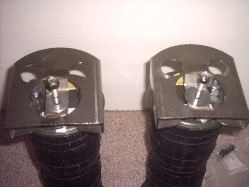

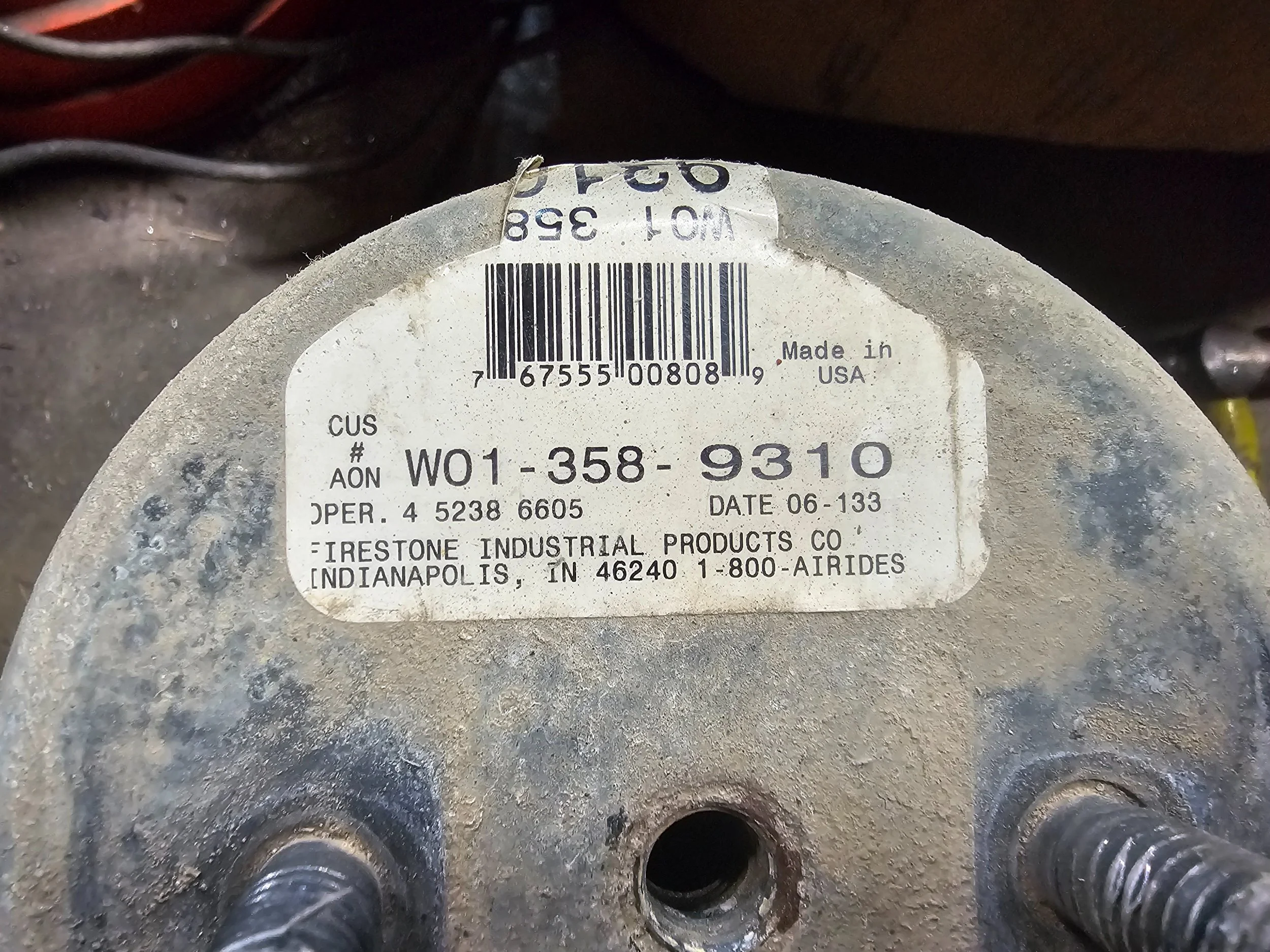

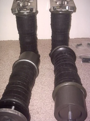

Here's the bags ORO was using.

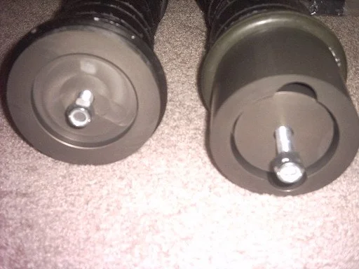

And then adapters for the top & bottoms to mount onto the axles.
Front
Rear
I'd have to find pictures of the bottom bell and better ones of the top.
