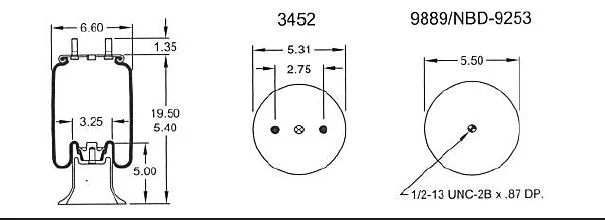

https://www.amazon.com/dp/B08833NJW8?tag=wranglerorg-20 This is what I ordered to replace the coil springs, I can send them back if necessary, but I hope they’ll do the trick, I’ll be able to lower the body to get the shock stroke in the right place and find that sweet spot. Again, I hope! I also ordered a dual path on board compressor so I can control the front and rear separately, tell me what u think

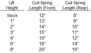

OK once you're around the Jeep take some pictures of the suspension both front & rear springs plus the steering and trackbar. And measure the springs to verify how much lift you have. If it's a spacer lift then that isn't helping things at all either.
https://wranglertjforum.com/threads/how-can-i-tell-how-much-lift-my-jeep-wrangler-tj-has.193/
Being Rough Country shocks could point to one of the #1 issues. Most of the Rough Country shocks aren't known for being very good. Before you go to all the work of trying to adapt those air springs to your TJ I'd address the shocks. But also if your lift is just spacers I'd install a quality set of coil springs also and lose the blocks.

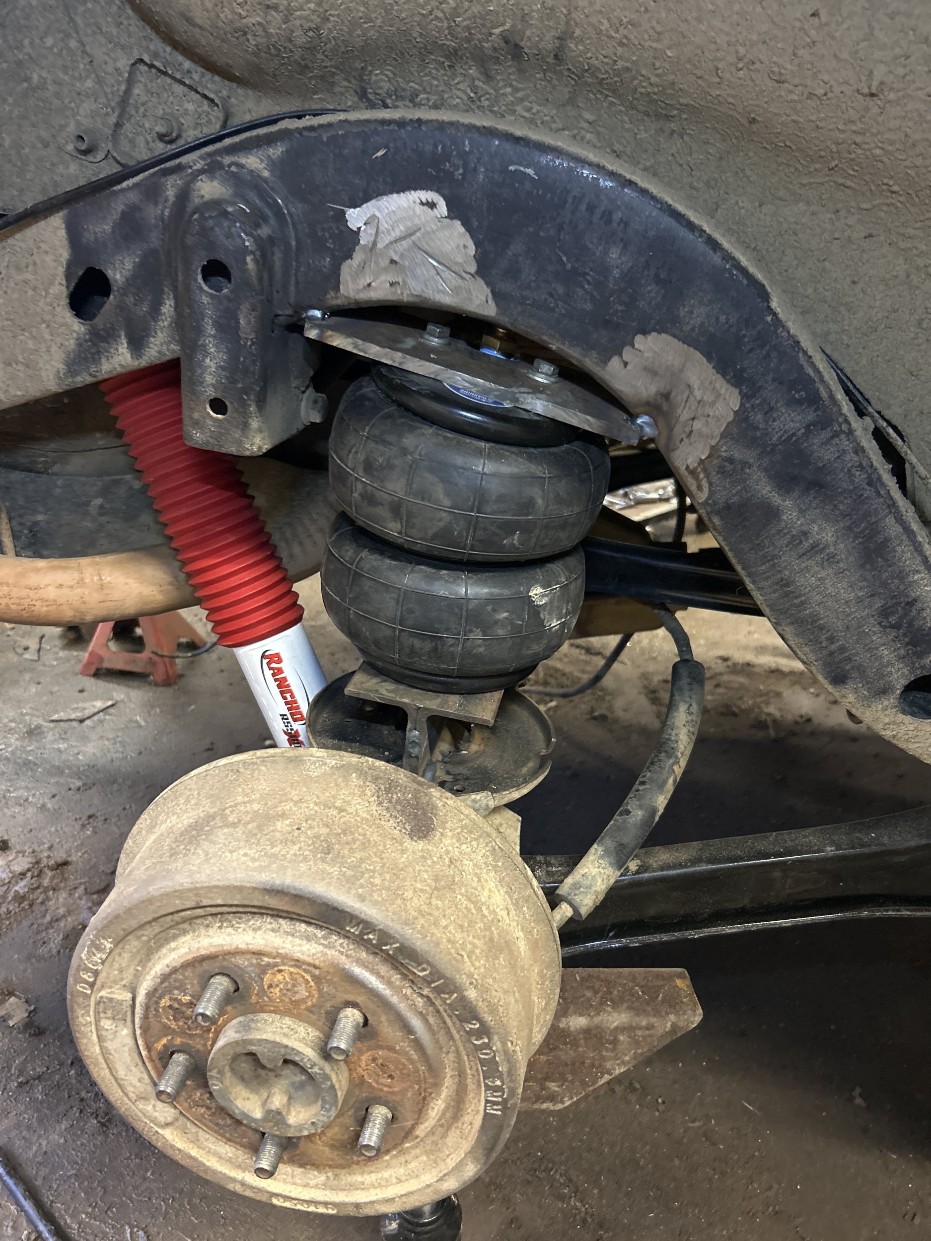

It’s coming together, the rear is done

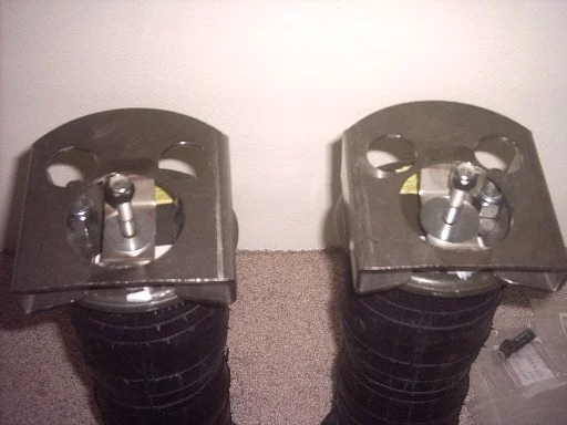

Did you try inflating it with that slight angle? Not suer what it's could do but just curious. The AiRock kit had these brackets that make the air spring sit a little more level but it still bowed some.
When I made my own brackets I have them centered over where the axle sits.
