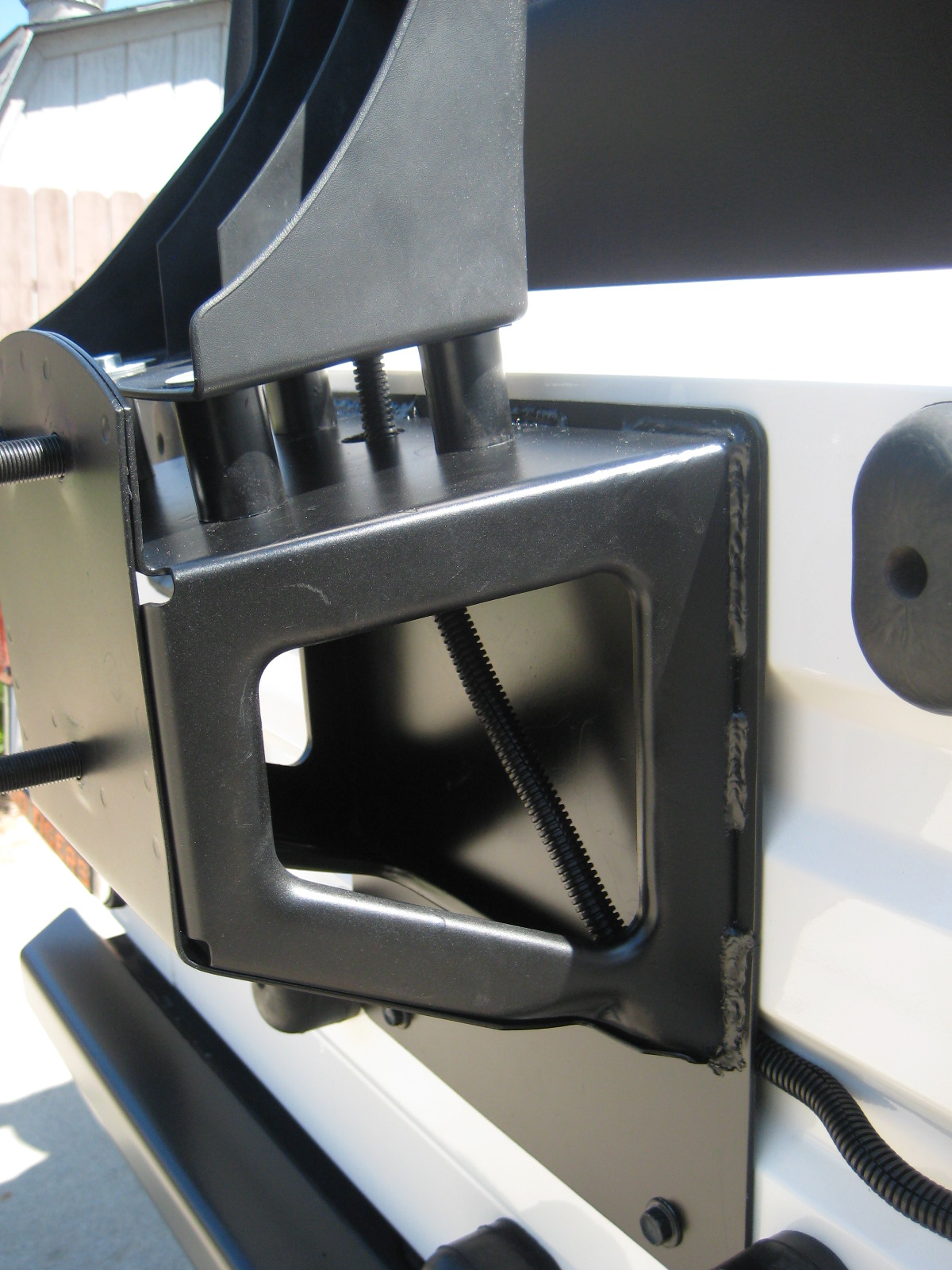

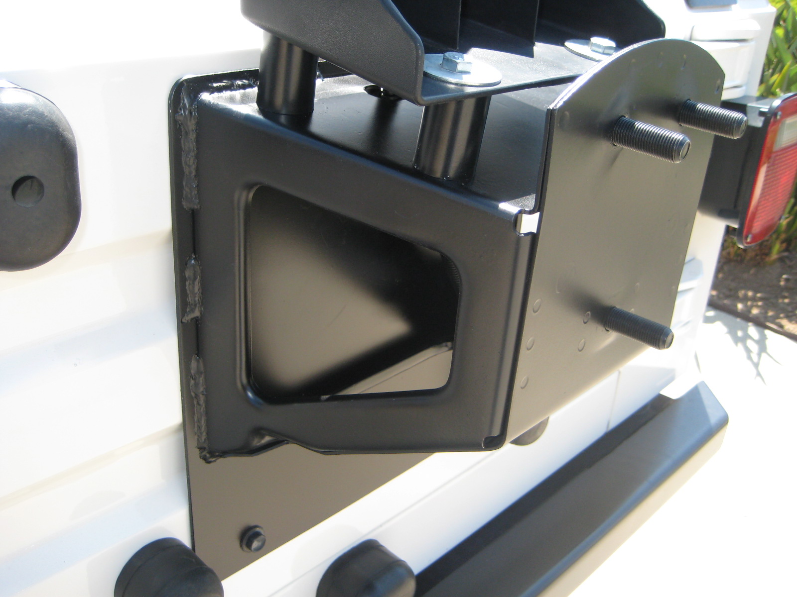

To raise mine I cut off the top mounting area and added a piece of angle, then added the difference to the bottom and reinforced with a cap plate. Then gussets to the stress areas. Not sure either is faster or better but just another way to do it for anyone else modding these things.
. 29E18CEB-231E-439E-BBCC-8B3D48A7AD37.jpegB0530F37-82E5-4525-AFEB-3266AA903A54.jpegB0530F37-82E5-4525-AFEB-3266AA903A54.jpegFC721CCD-B3B3-409D-A3D3-FC7A8142DD00.jpegC75B7D91-E947-4C9B-95AD-2EB331A2BB11.jpeg

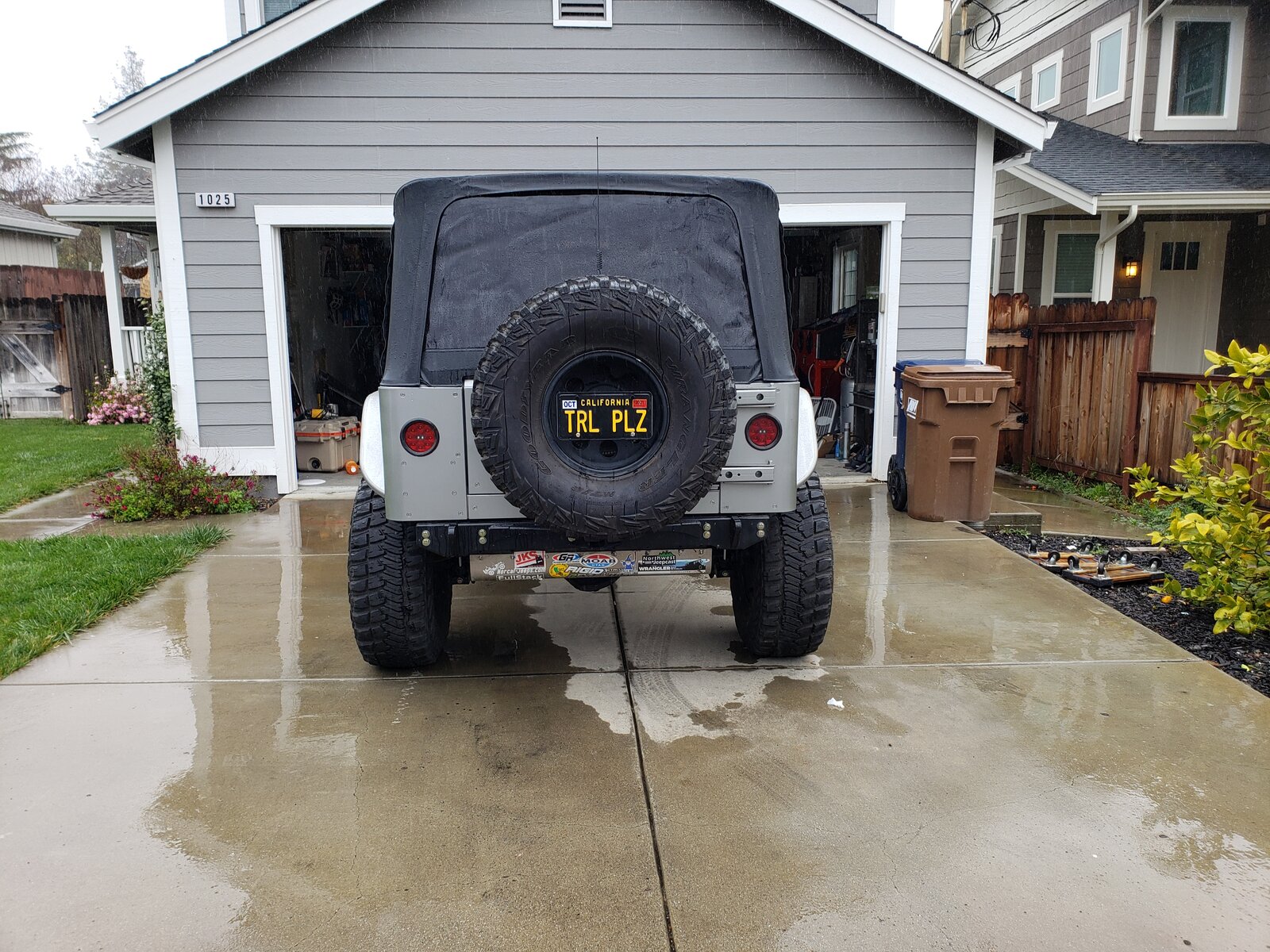

It's all buttoned up. Last item on the list is the shorter psc reservoir, hasn't shipped yet, and its ready for Moab.
Very nice! You made lots of changes since your last trip to Moab, it’s a different Jeep.
