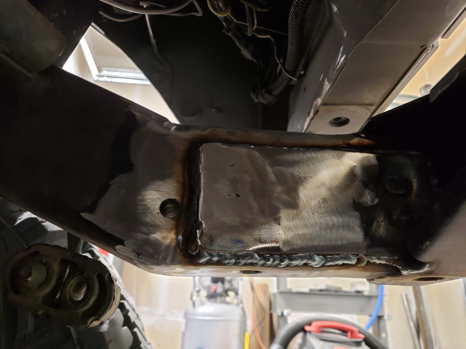

Finished up the rear tuck. I just need to reinstall the bumper, tank, and raise the carrier so the tire doesn't hit the hitch.

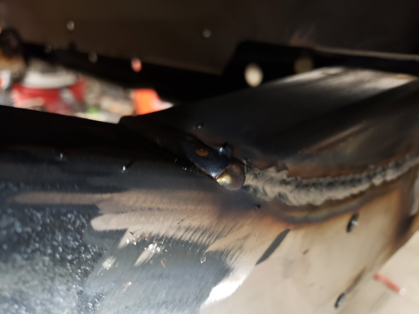

The hardest part was getting the shape of the cap right. I can't say I'm proud of the vertical welds on the fishplate on the crossmemeber side, but they were the most awkward, unreachable welds I've ever done. I also added 3 plug welds on both sides of the cut to be safe. The rest looked good though and I'm quite confident the rear section of the frame is going to stay where its at.
Figured I'd take some photos of the welds because they won't ever be seen do to grinding them flat.
The hardest part was getting the shape of the cap right. I can't say I'm proud of the vertical welds on the fishplate on the crossmemeber side, but they were the most awkward, unreachable welds I've ever done. I also added 3 plug welds on both sides of the cut to be safe. The rest looked good though and I'm quite confident the rear section of the frame is going to stay where its at.View attachment 234762

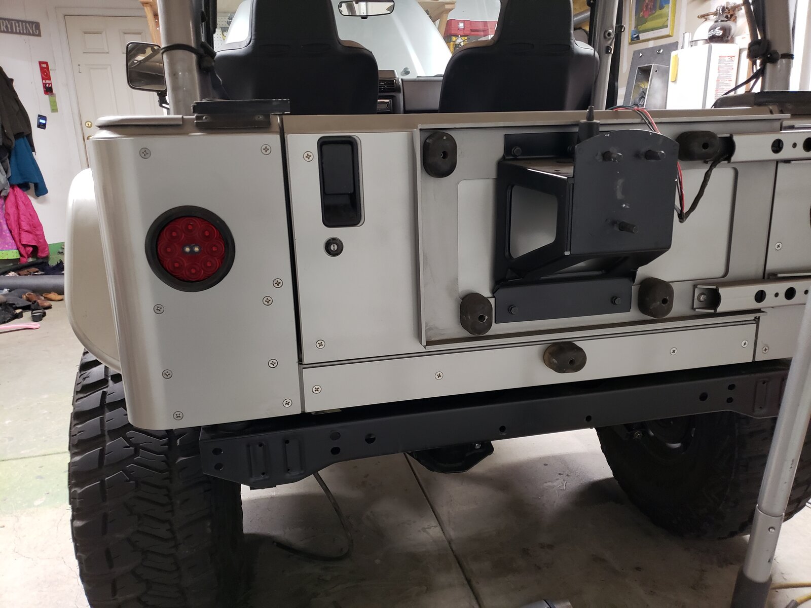

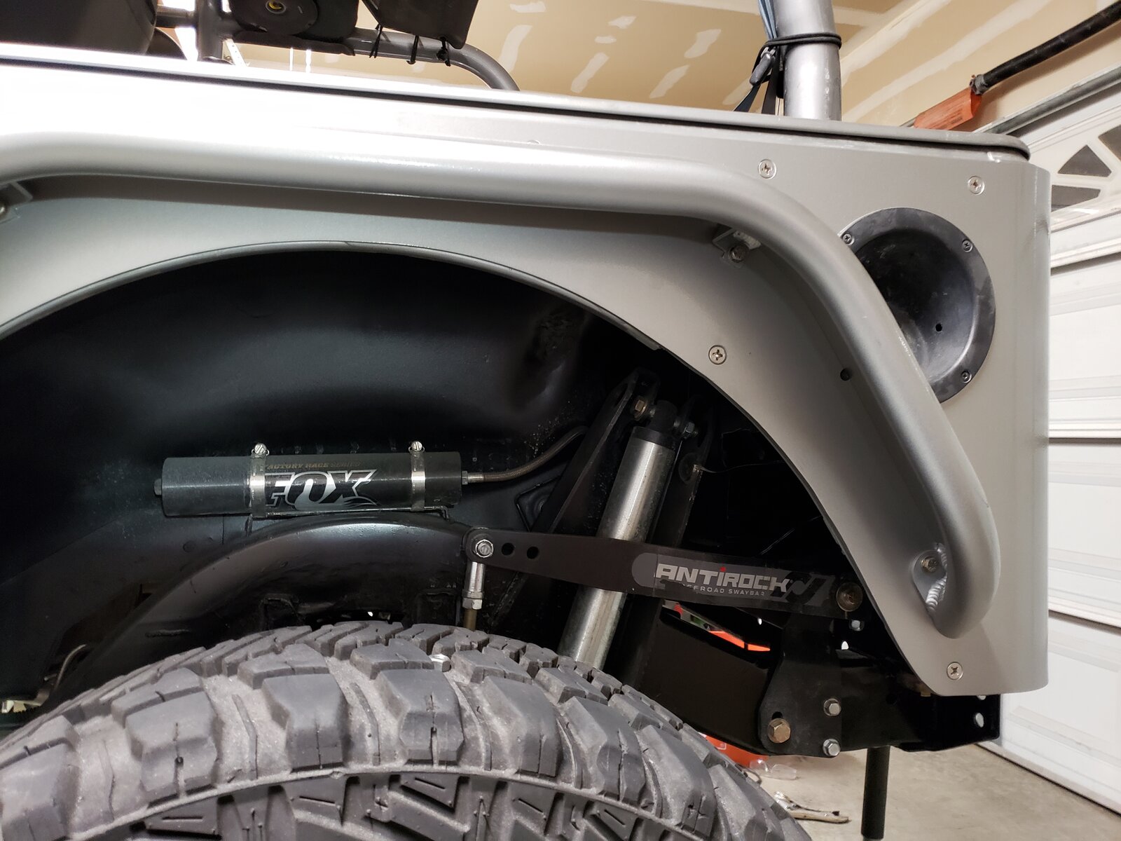

I'm really happy with how the paint came out. I figured it look good from 10ft away but it came out much better. Of course, there are some flaws in it but unless you're looking for them they'd be hard to spot.
it does look good.
i'm torn between leaving the armor raw and just brushing it, or having it painted.
i'd like to get the whole jeep repainted OE khaki when i'm done, but i'm not sure yet about the armor.

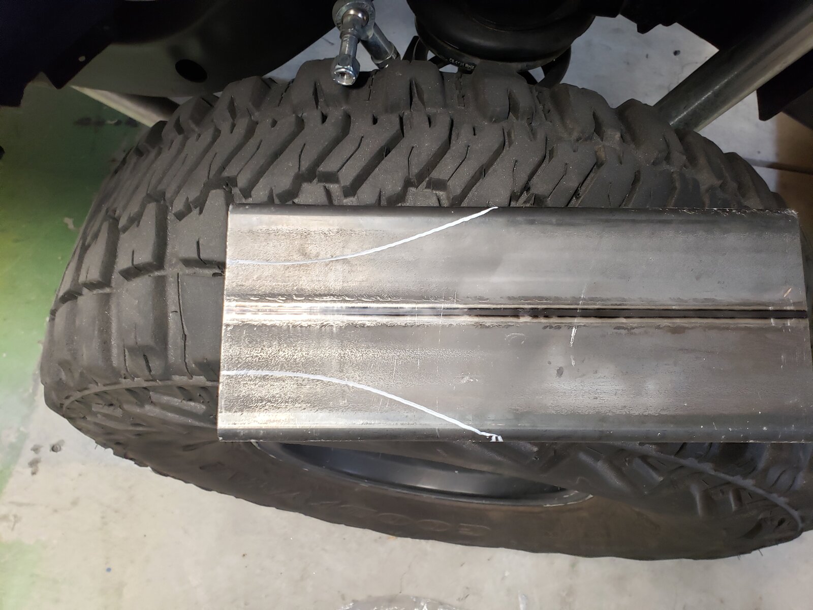

do you recall the length of the patch piece? i have tube scraps, and b4 they get tossed i'll cut several of those from them. i would have offered some but didn't wanna hold this up another wk for shipping.
The cap was just under 6".
