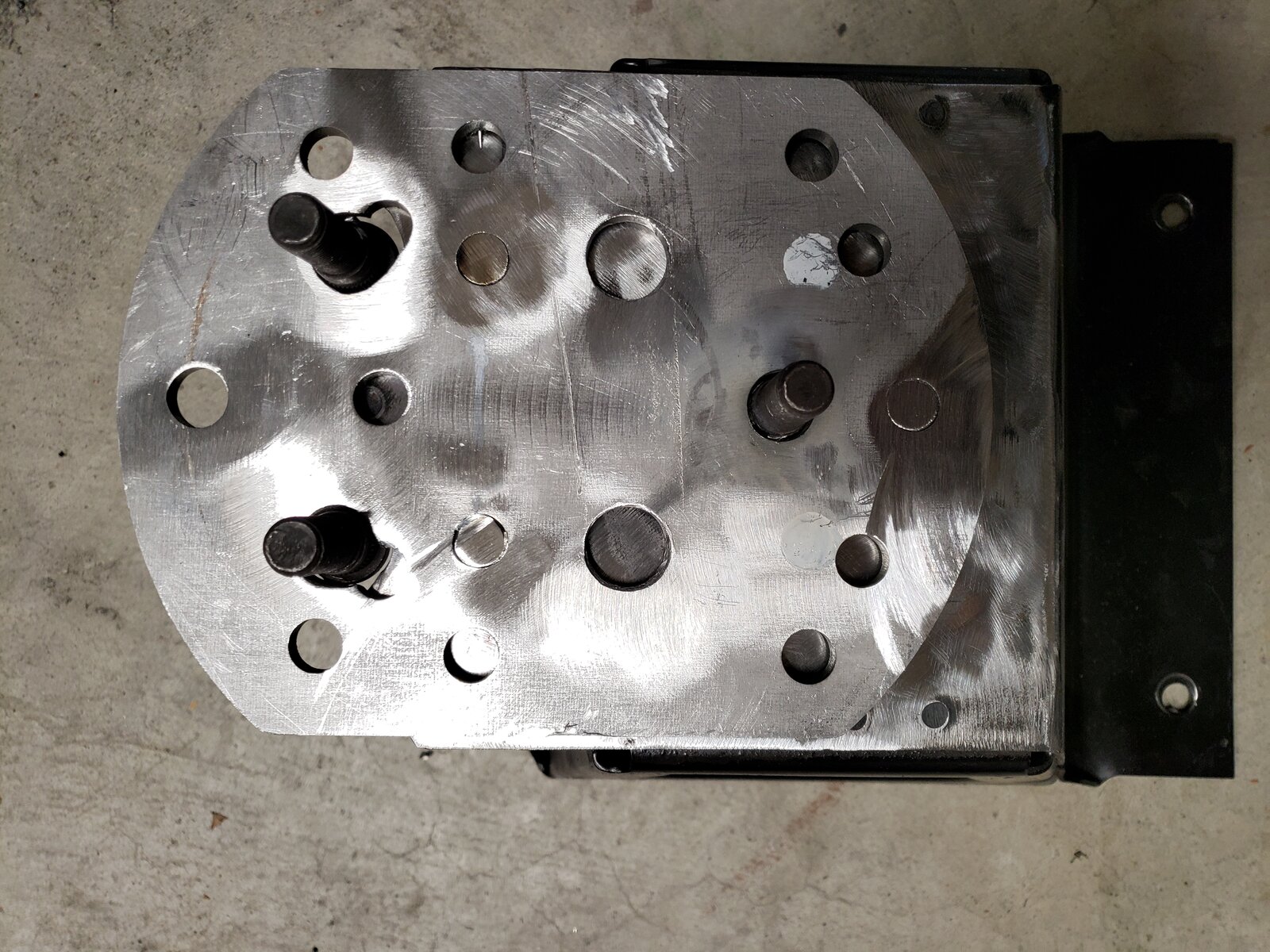

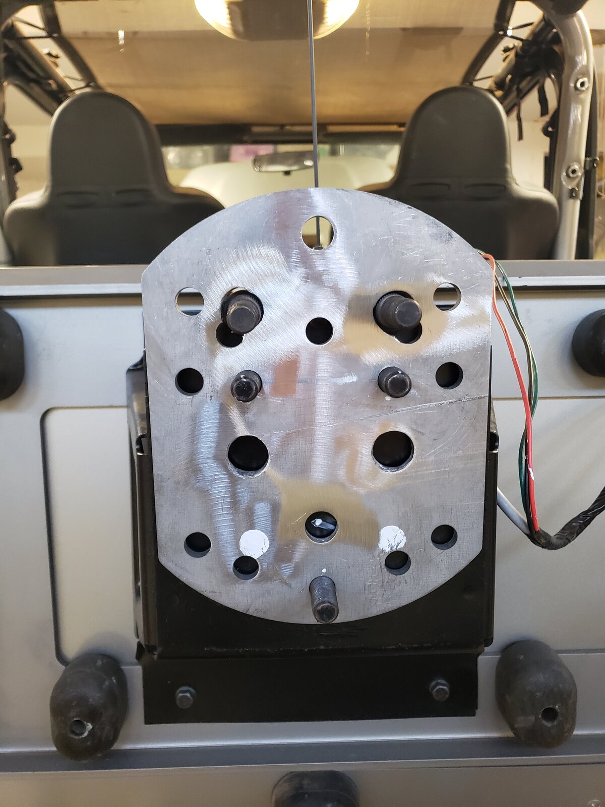

I modified the tire carrier to be 1.25" higher. My idea was to add a Barnes 1/4" mounting plate to the carrier by drilling an additional set of 5x4.5 holes exactly 1.25 above the ones they had so I could use the old studs as plug welds and be assured the new holes were the right height.
The holes were a major pita to line up but ultimately I made a template with a piece of plywood then used that to transfer the wholes to the taller position.

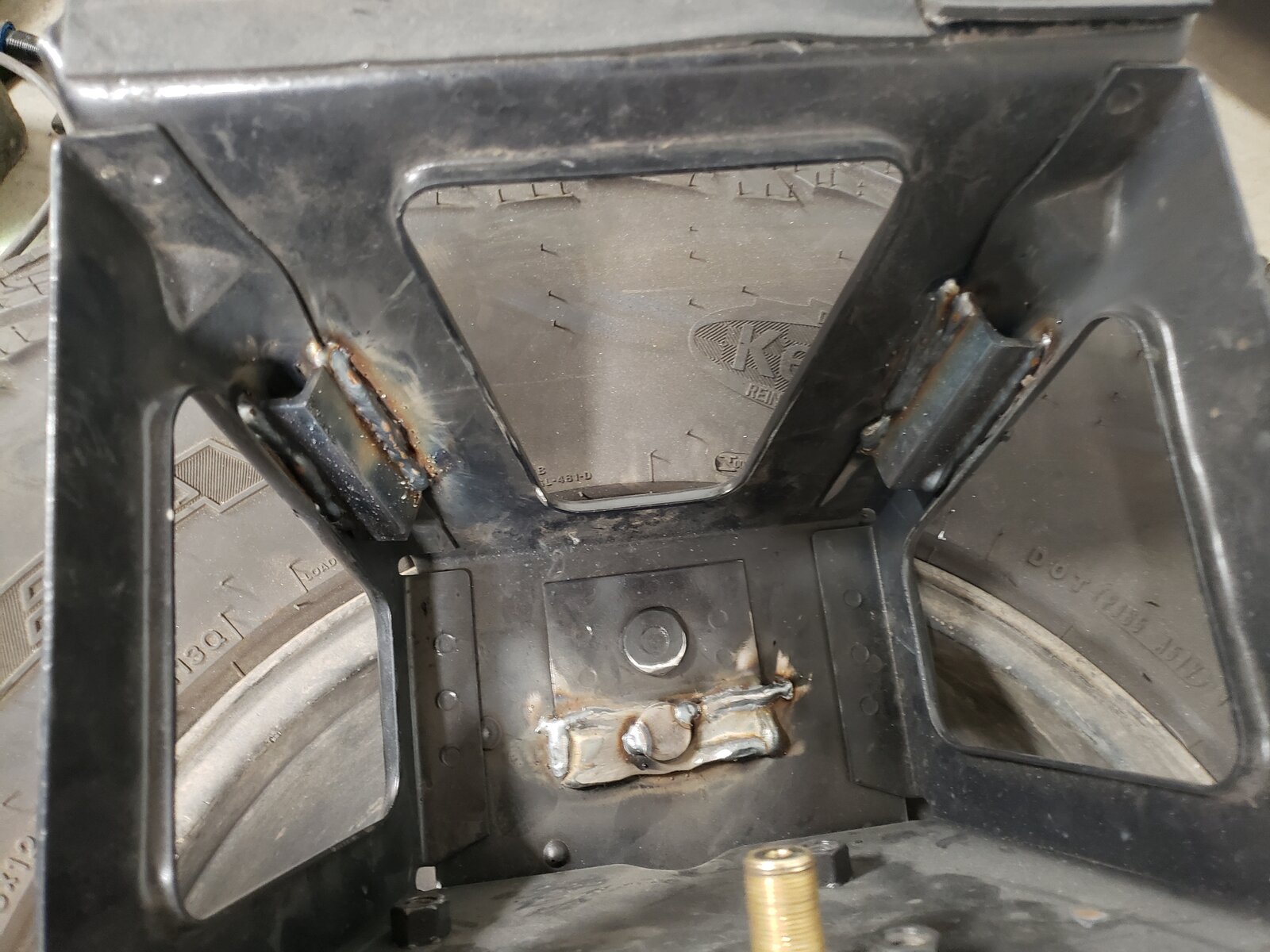

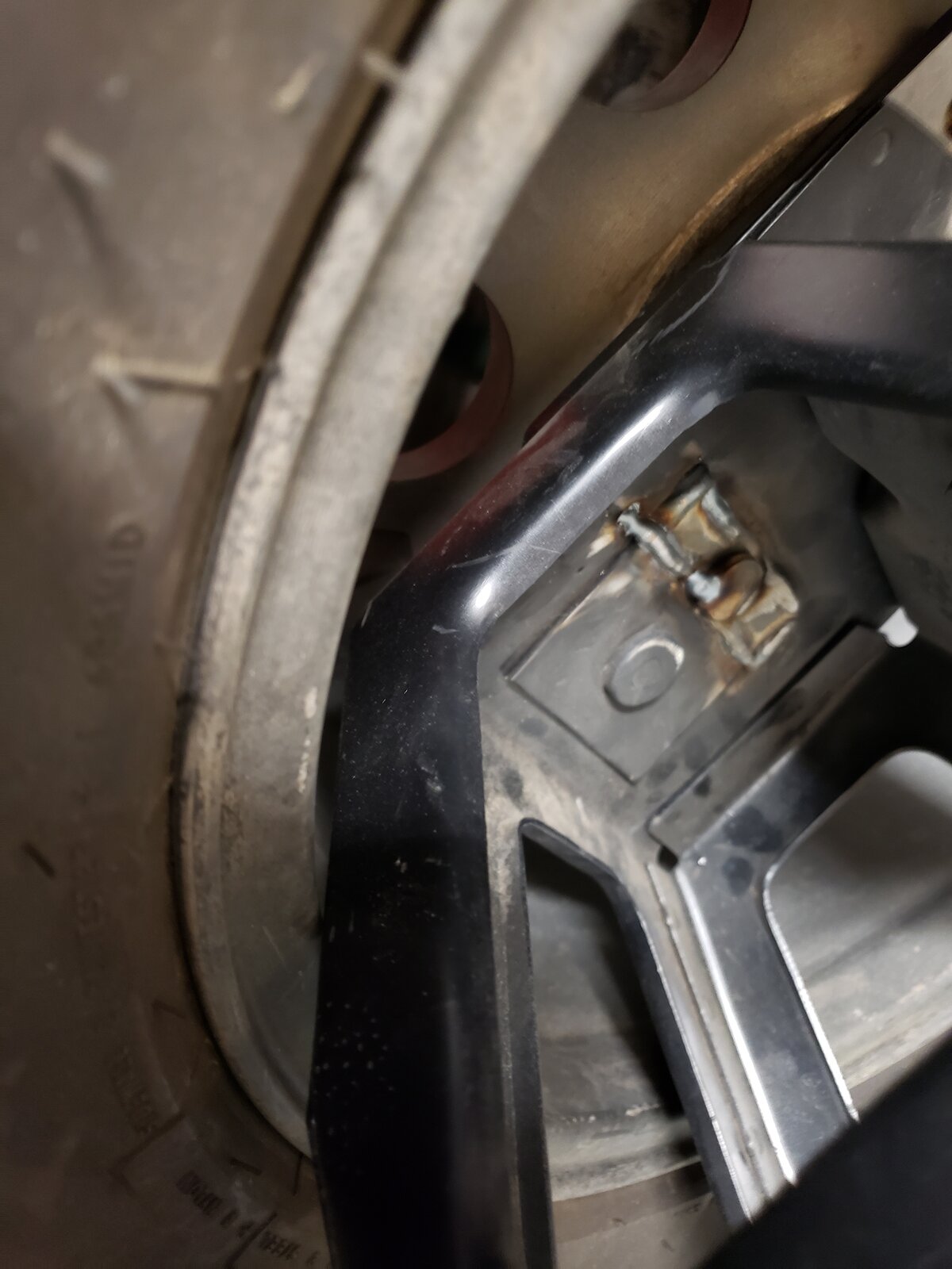

At first I thought I got lucky and cleared the 15" wheel but the carrier was making contact and the tire wouldn't sit flat.
I cut out a section of the carrier to gain clearance then added some angle iron to the back side to return the integrity.

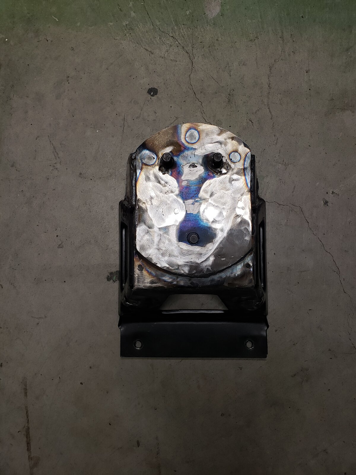

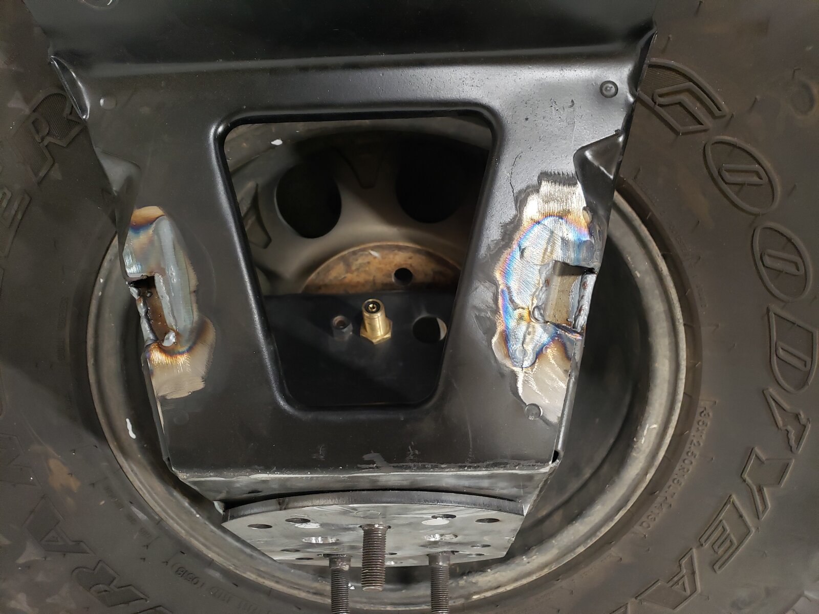

Then lots of of welding since the mounting bracket had just about every pattern drilled into it. I used a piece of copper to help fill the top 3 holes that didn't contact the oem carrier.

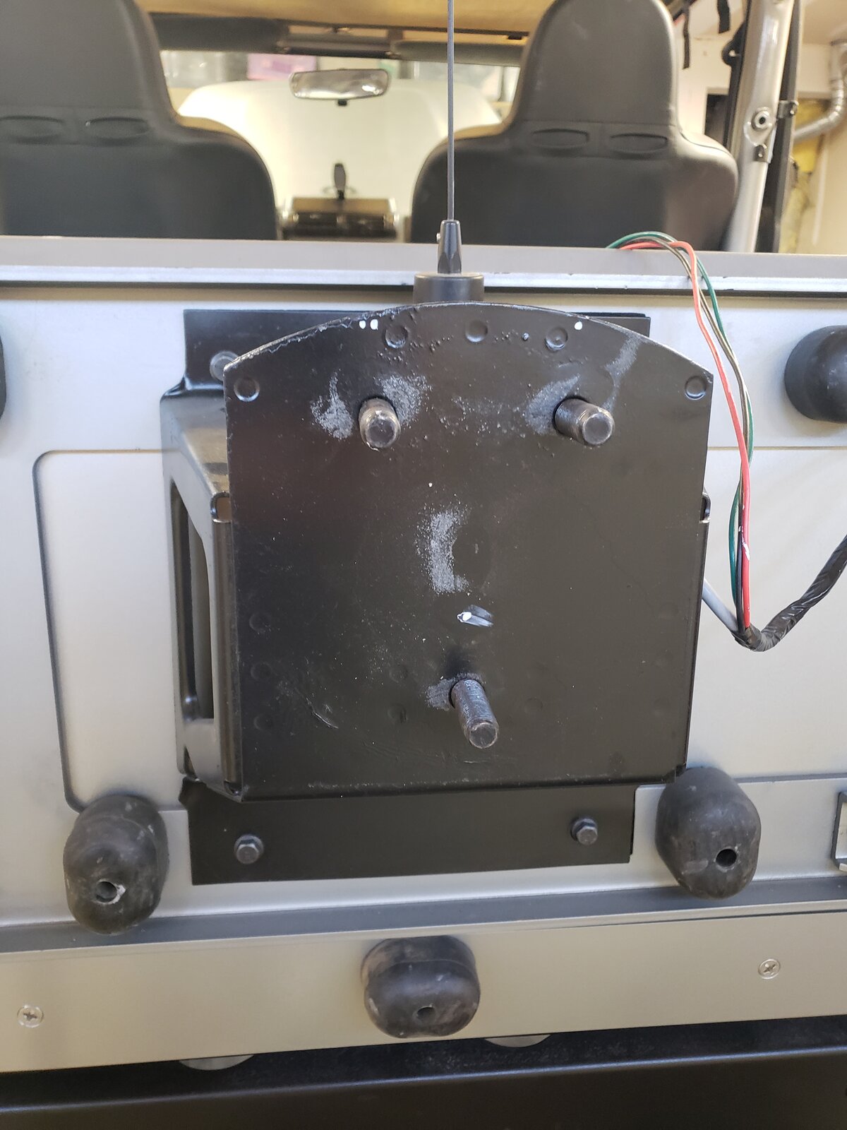

Finally I added a brace to support the taller mount.
All in it took about 3hrs. With any luck, I'll be done tomorrow. I need to finish up the wiring, adjust the rubber bumpers, and reinstall the gas tank.
I cut out a section of the carrier to gain clearance then added some angle iron to the back side to return the integrity. View attachment 235049View attachment 235050
Then lots of of welding since the mounting bracket had just about every pattern drilled into it. I used a piece of copper to help fill the top 3 holes that didn't contact the oem carrier. View attachment 235051
All in it took about 3hrs. With any luck I'll be done tomorrow. I need to finish up the wiring and reinstall the gas tank.
Great to see such a strong commitment to carrying a spare. Nice work. It’s never a bad day when can get out the welder.
Good work buddy!! Add weep/drain hole(s) for the brace if you haven't already.
