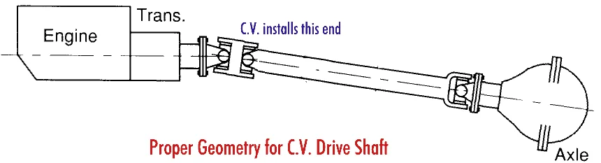

I did remember reading the front pinion should be a few degrees offset to the driveshaft - is the consensus to just line everything up? Will the double adjustable upper arms freely rotate by hand with the jeep on its own weight?
Rear pinion can be a couple degrees down from driveshaft to allow for rotational torque.
You may still have to adjust for vibes.
Don't worry about the front driveshaft angle.
Adjust pinion for caster. Back it off if you get vibes.
Yes, they should turn by hand.
I went through this exact issue about a week ago.
Such as @LONGJP2 said, many people recommend setting your front pinion as low as possible for caster, and adjusting it upwards until vibrations are gone.
Pinion angle itself is somewhat irrelevant.
Similar to Caster, It will be whatever it will be, as long as there are no issues with binding/vibrations.
