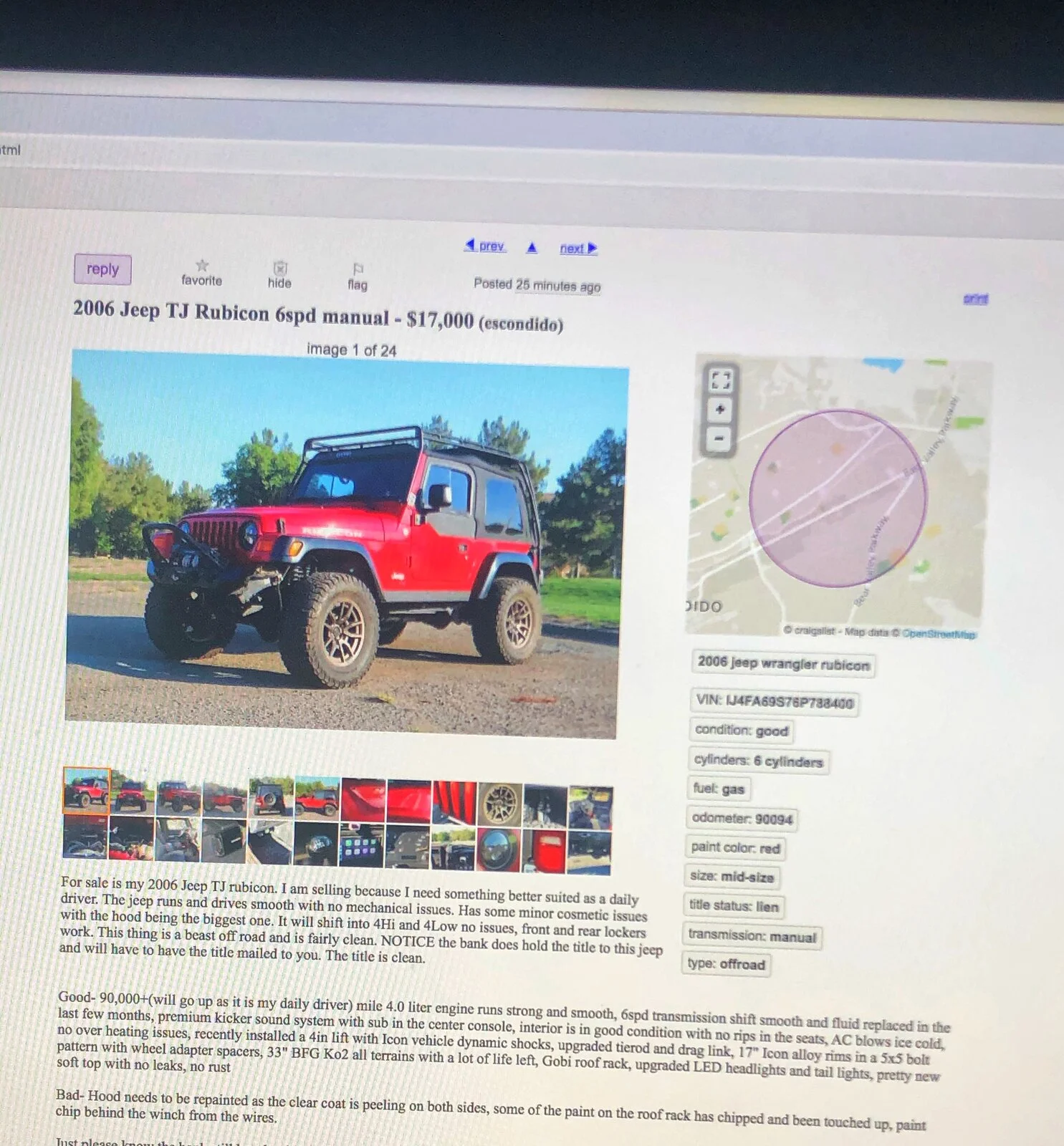

builds going well i did find a dana 44 but I always have it in the back of my mind i should have bought this one when i had the chance.

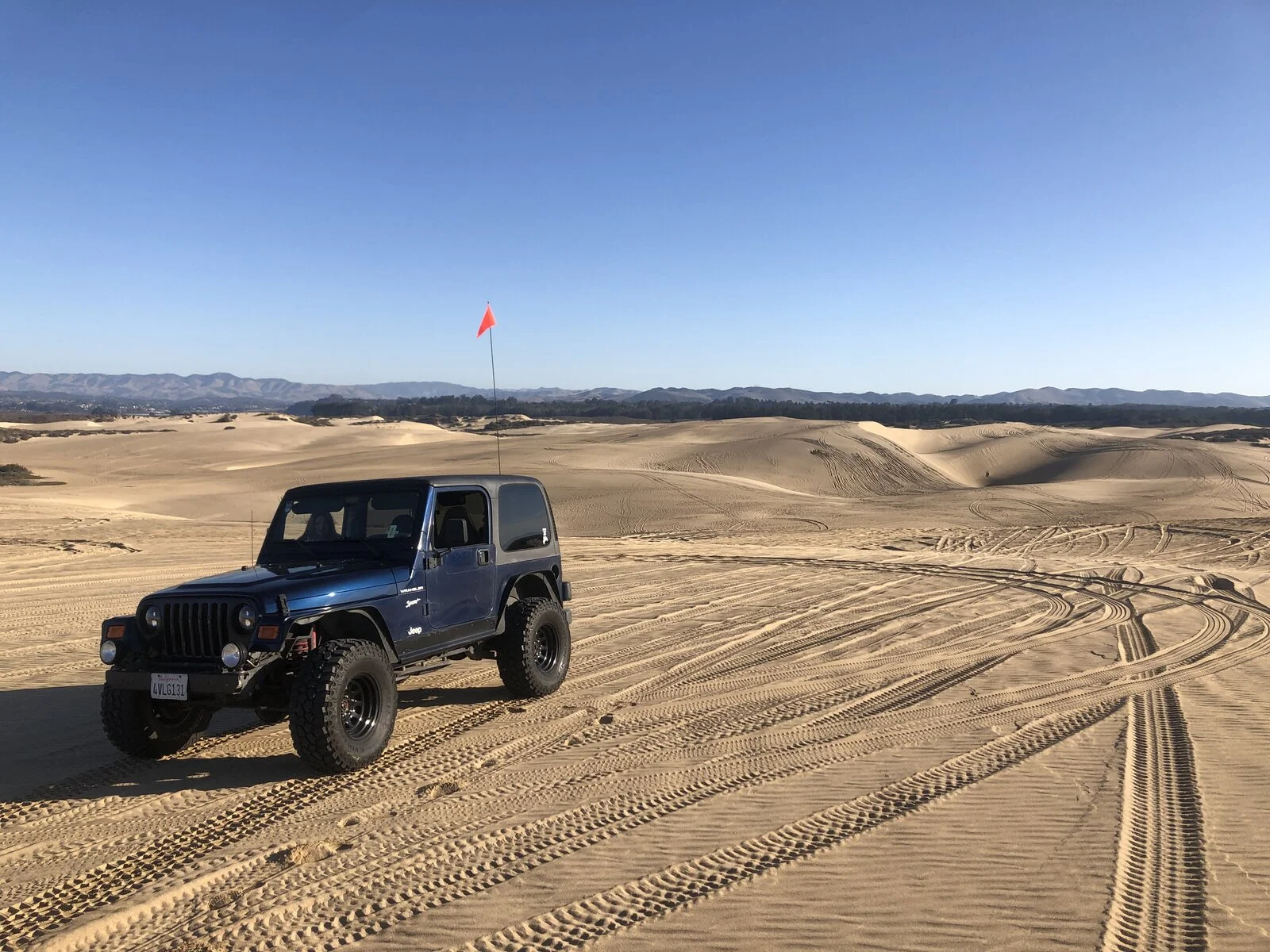

but my jeeps just fine Im going to head out to the pismo dunes / oceano dunes this weekend if anybody else would wanna come ?
went to the Pismo dunes jeep did well I need to flush the cooling system and put new coolant and probably get a hood louver for heat and because i think it looks cool.
I thought my car looked kinda like like an rc car and im hoping maybe i could win ride of the month but I dont know the rules
