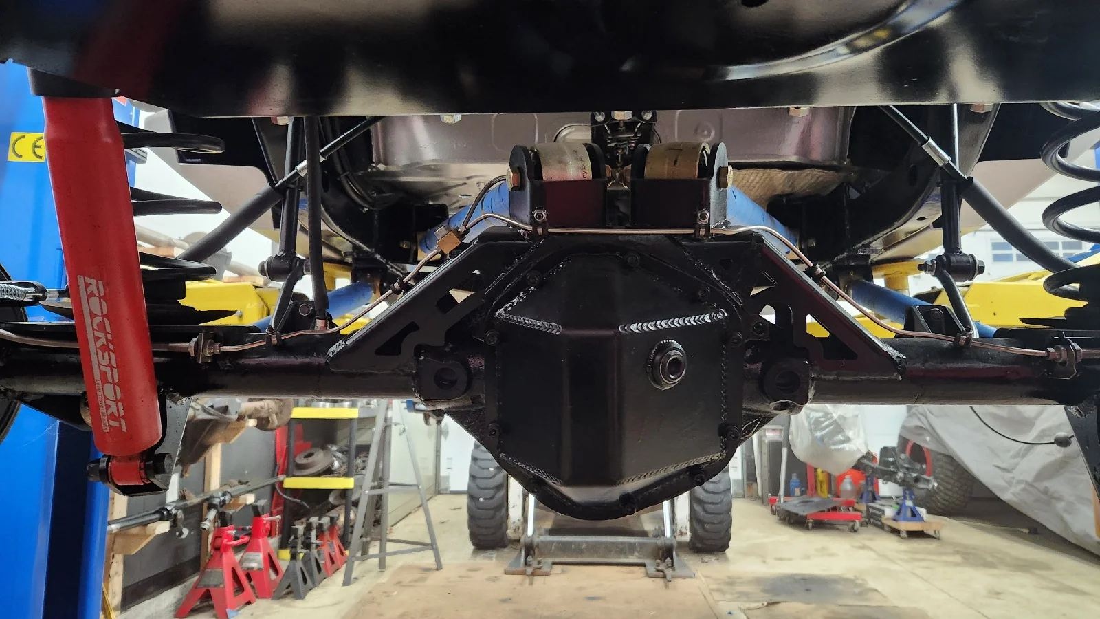

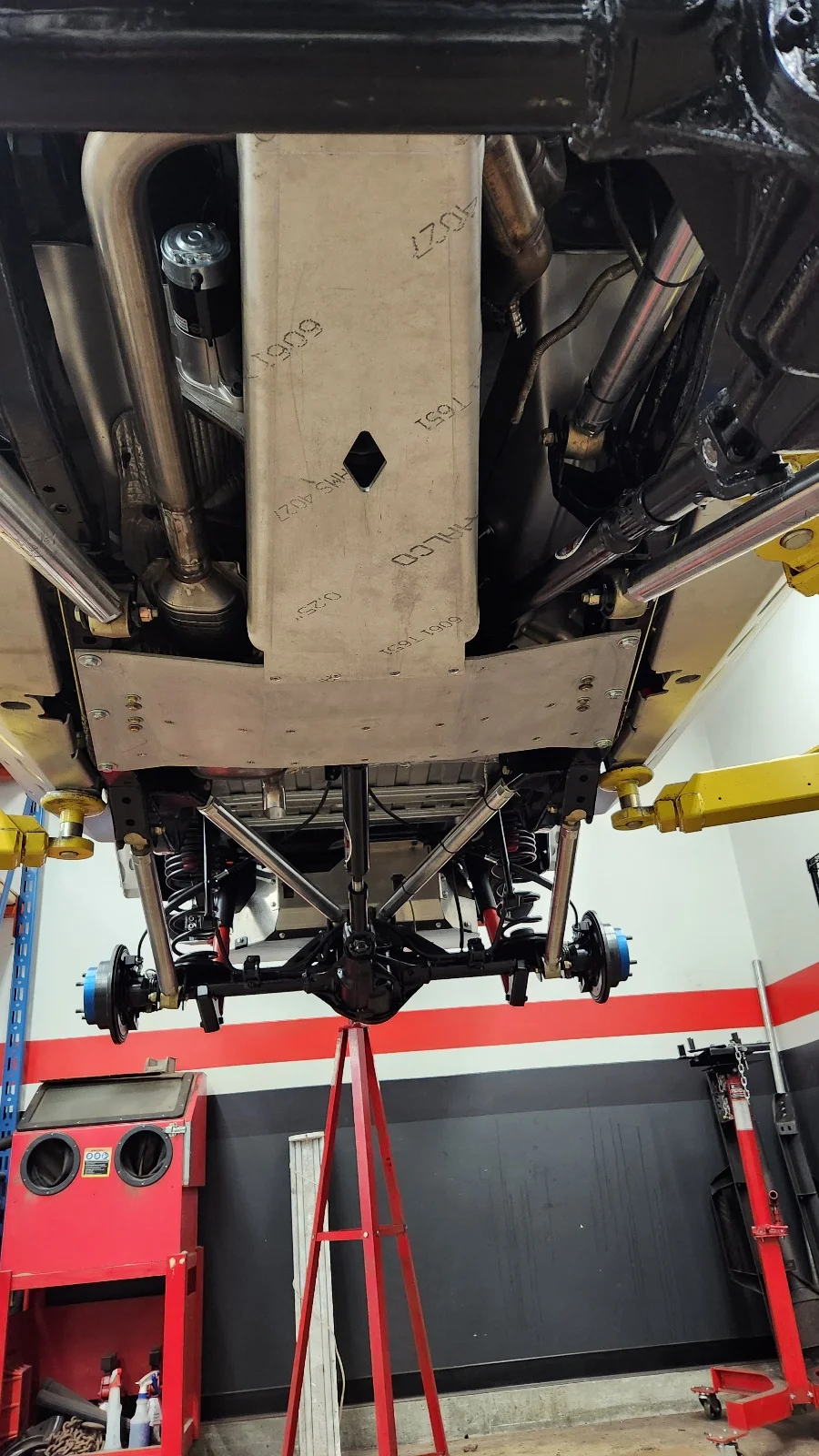

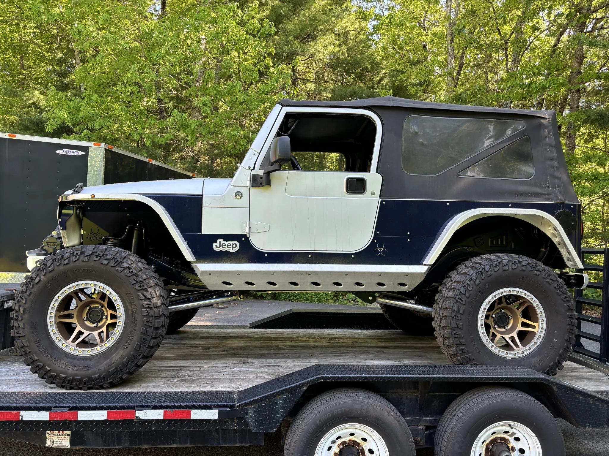

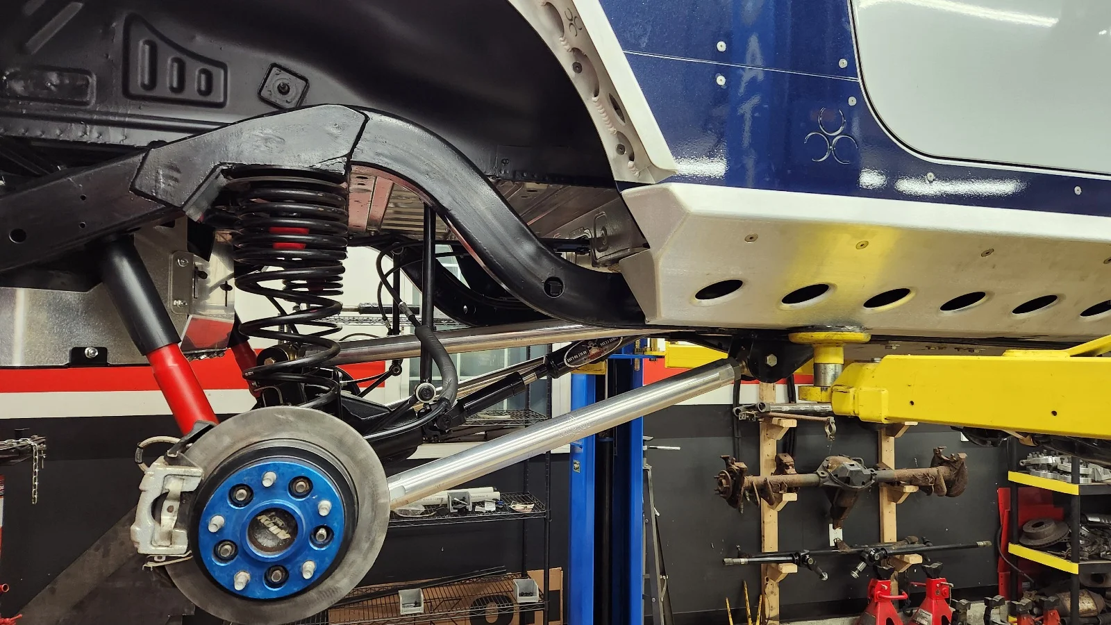

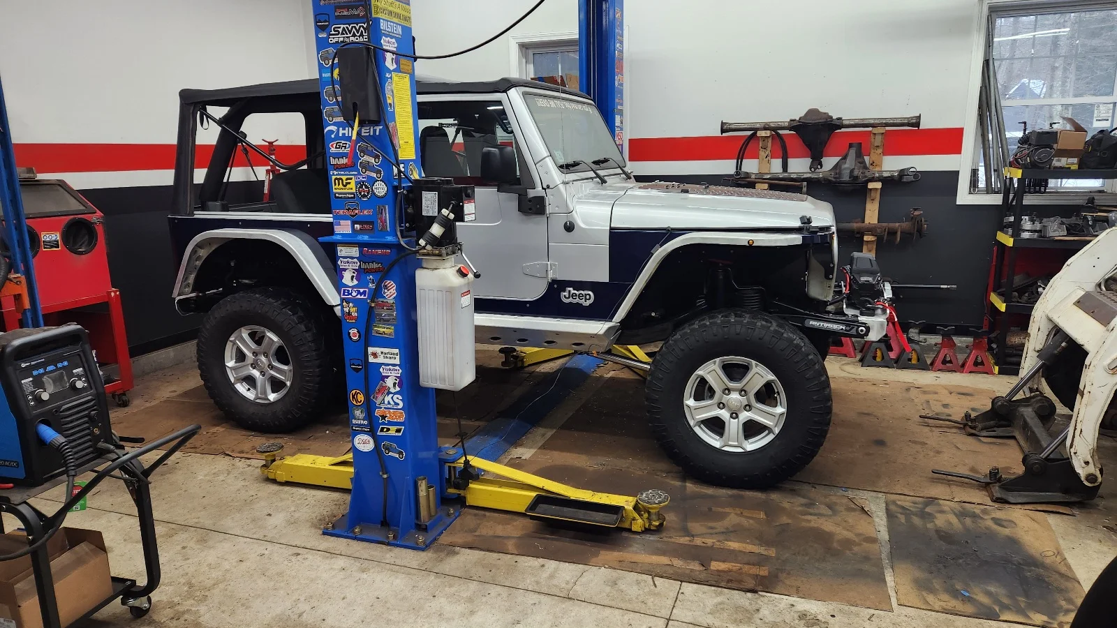

It's been a few months but the light at the end of the tunnel is getting brighter. Off the List:
- Battery & custom cables installed.
- Evap canister & purge valve plumbed.
- Coils pulled, suspension cycled and bump stops installed.
- 03 dash swap and roll bar padding painted.
- UCF front and rear bumpers. Took Advantage of Warns rebate on a Warn VR EVO-10 for $250 after rebate.
Aside from some ram-assist hoses, soft-top sides, and an alignment, it's pretty much there. The Savvy skid is a nice piece. Lower links are at 10 degrees and uppers are at 0. Owner is waiting on wheels and tires. Although, doesn't look all that bad on some "JL rollers".
