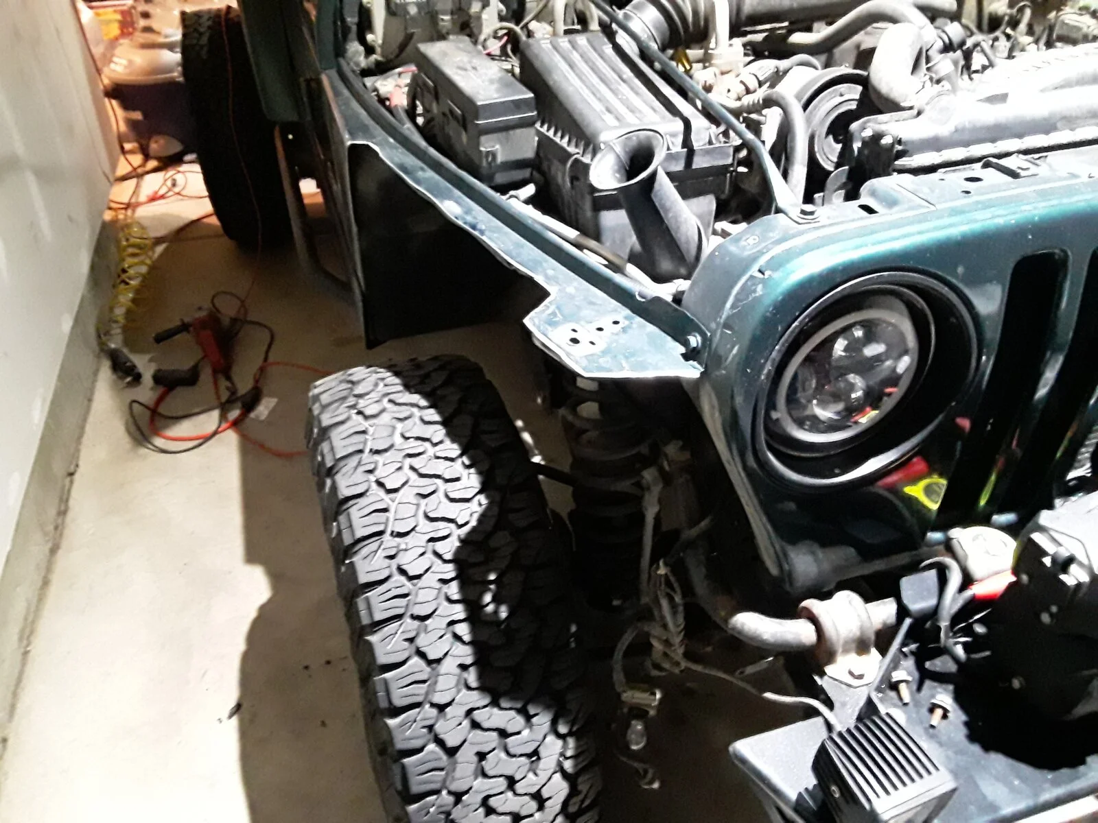

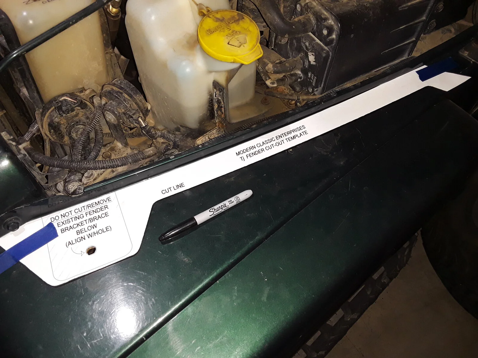

The MCEs might be a good option for you, I'm not aware of many others that sit in that middle ground.
I agree. The way the plastic can deform without loading the tub connection too much, and even though it doesn't get you a ton more clearance, it at least eliminates the flange that the flare attaches to, so that's good for a little under an inch. If all you need is 3/4", then 3/4" is enough.

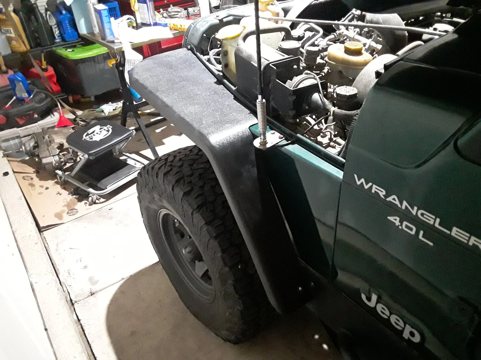

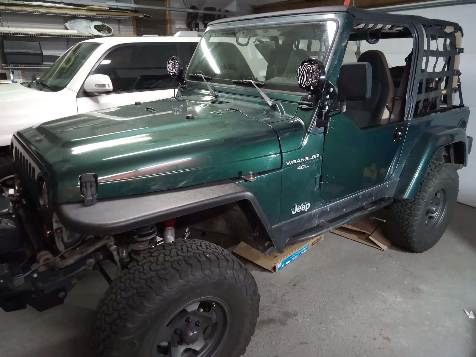

I got 1 1/16”. This is because you’re not just removing the outer seem of the stock fender, but everything almost to the hood line. Then you have the further advantage of the flexibility of the flare. It can push up easily if the tire hits it. Functionally the MCE’s do provide performance gains as you stated.

I had them on my TJ with a 4" lift and 32x11.5

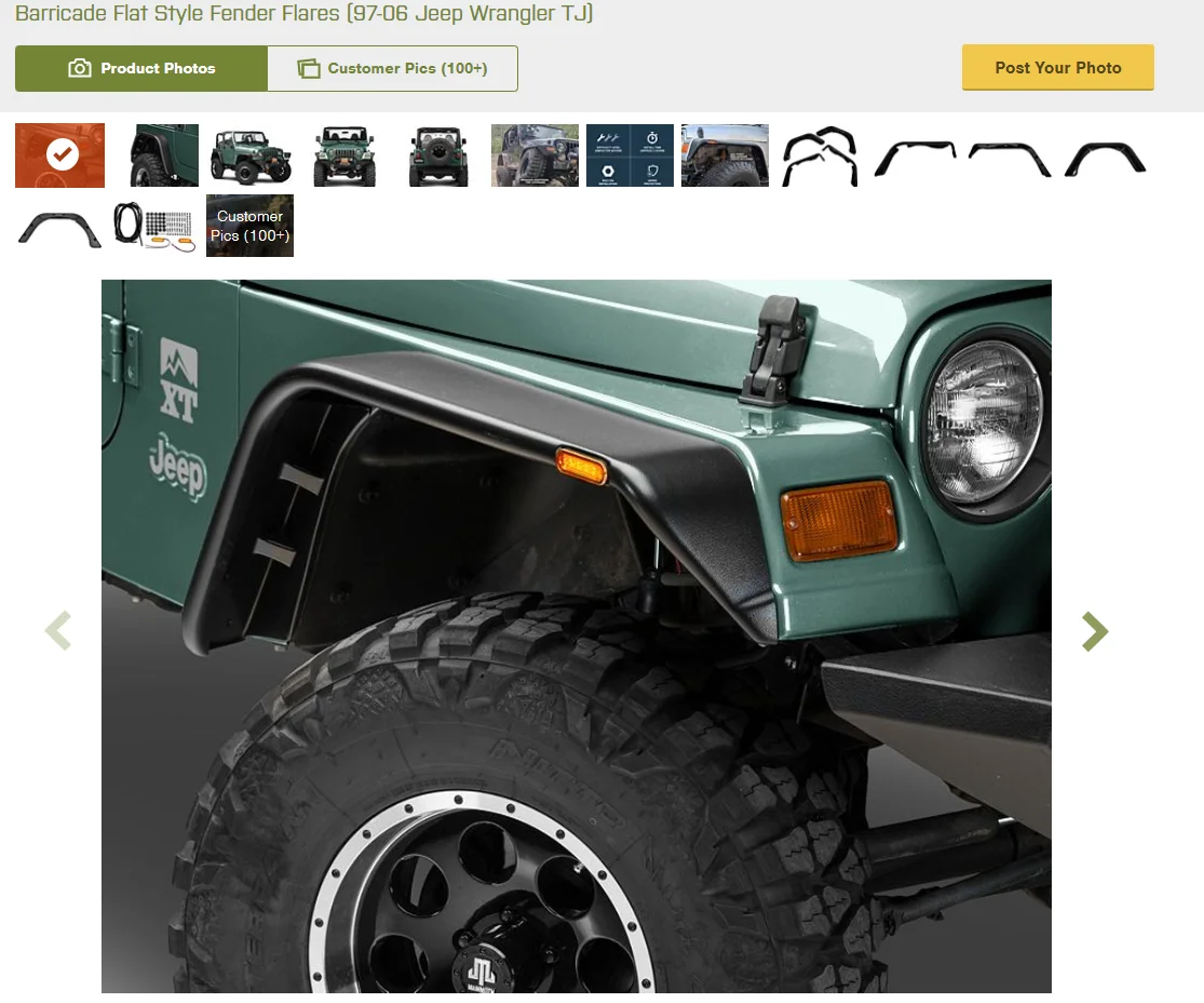

I linked to the plastic MCE flares, not the flat fenders. Anyone using the flares? I like the look, keep OEM fenders. I get that they're not adding 'protection' but appears they do provide a bit more clearance, especially coming from pocket flares. I mistakenly thought MCE was MetalCloak acronym so first time looking at these products.

those are Barricade, not MCE. To my knowledge, MCE does not make any flares for the front, only the front fenders that I posted. They do offer a 3", 4.5", and 6" width. I used the 4.5" which is equivalent in coverage to a Rubicon or Sahara flare.
The ones you posted would not gain any clearance since they fully maintain the entire stock fender, and I doubt they would get you much in the way of durability either since they look pretty rigid and possibly more likely to crack. The stock flares are pretty flexible.
They don't look too bad though.
