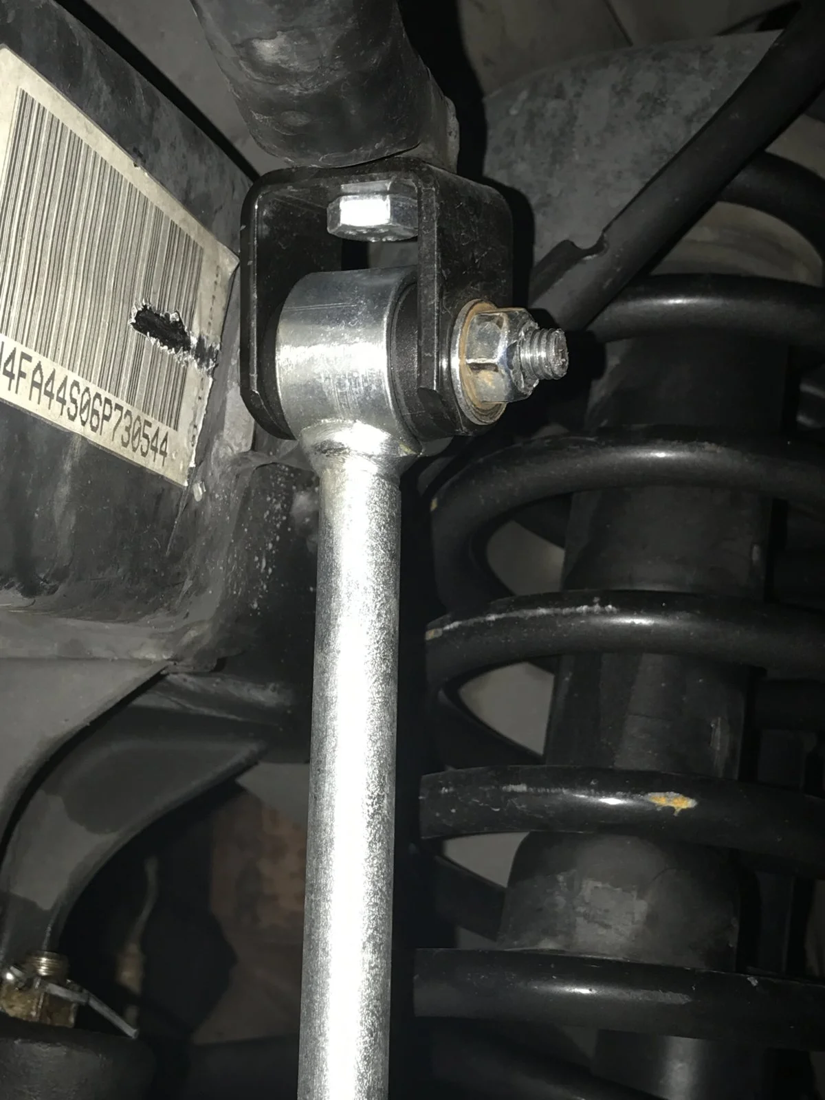

If the lift includes urethane bushings, they could be the culprit. Urethane has a tendency to squeak. You could grab some PB Blaster silicone lube and spray all the suspension pivot points and see if it goes away.
Fixed the squeky issue... my mechanic guy placed bolt on wrong side and once the alignment was done, everything shifted enough to become squeky squeky...
Now resolved and feels and sounds good.

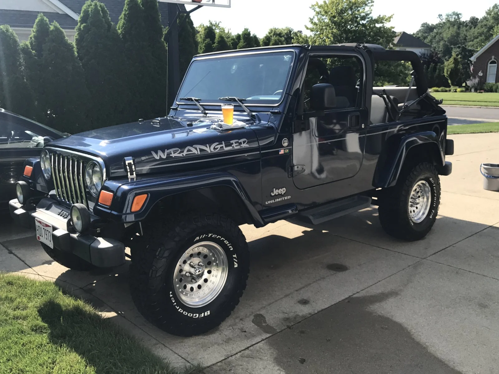

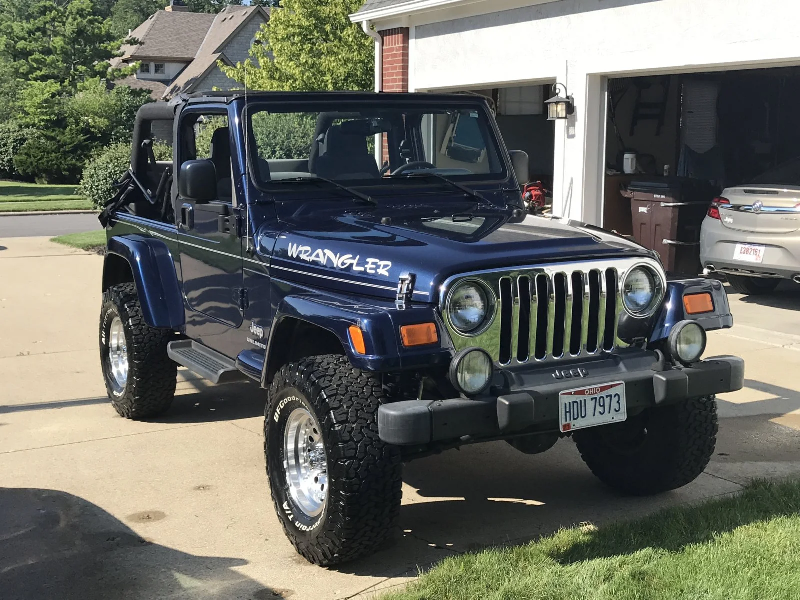

The big Wrangler sticker on hood? Stay or take off? I've talked to friends local and there is mixed reviews but they aren't Jeep people.
Also looking for thoughts on replacement of current step up. On 3 inch lift. I'm not going to be a big off-roader but plan to do some easy m/medium trails end of this summer or next spring. If I get that off-road bug, I may be a little adventurous down the road.
Thoughts and suggestions are welcome.
Thanks
Reactions: Zackz1997

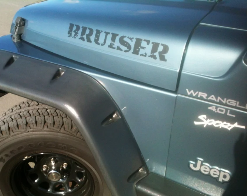

Love what you've done so far but for me the silver pin-stripe has to go... the 'Wrangler' sticker hood I'm 50/50 on. Maybe change the font style for something else...it does look a bit dated or name your TJ and put that on the side.( like mine )
Pass me the beer and I'll be in a better position to comment truthfully...In the meantime, I'd take the Wrangler sticker off first, because it does look dated, then see what the pinstripe looks like and go from there. I see the little USA and Brazil flags there too...Looks clean!
