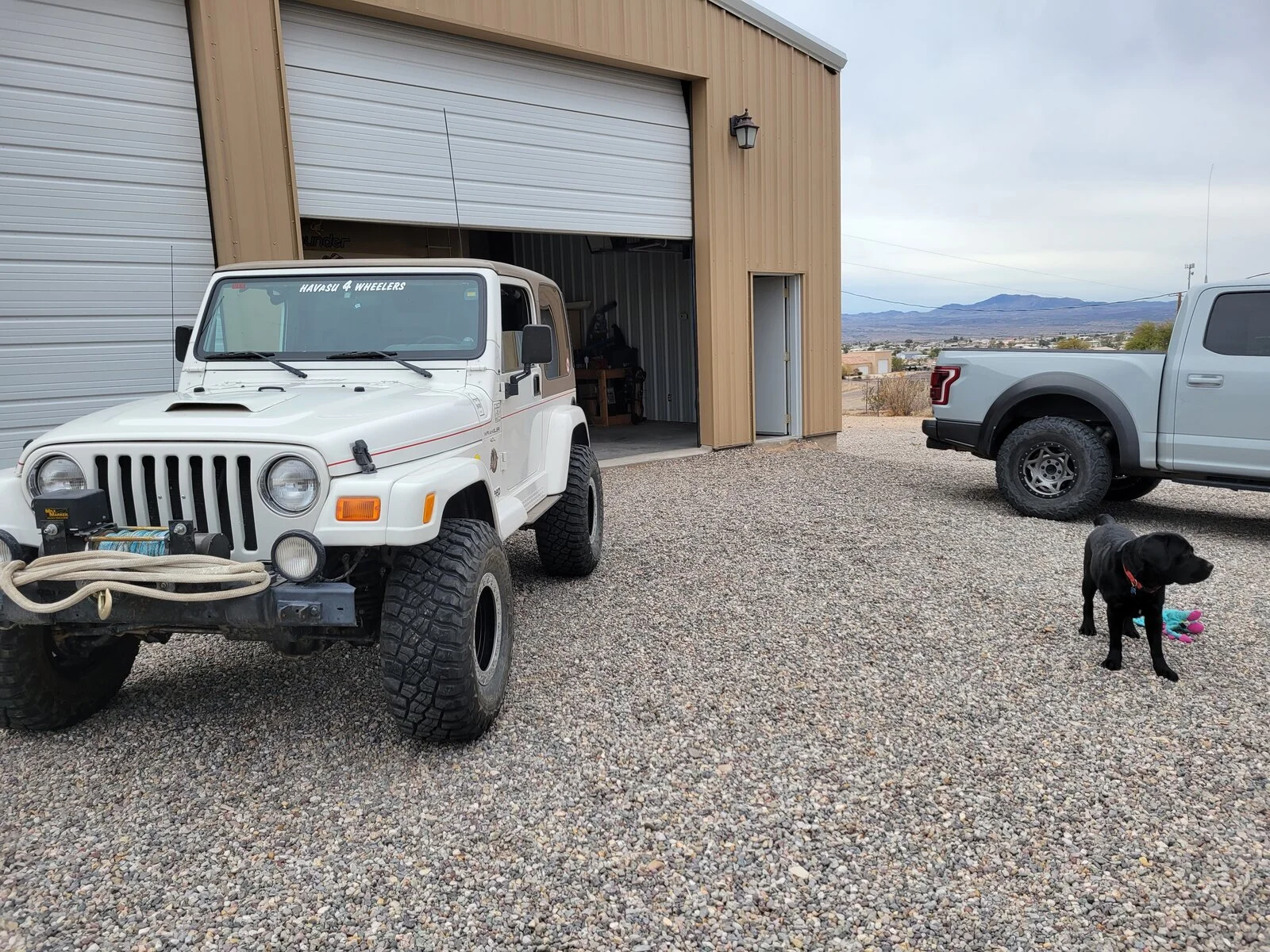

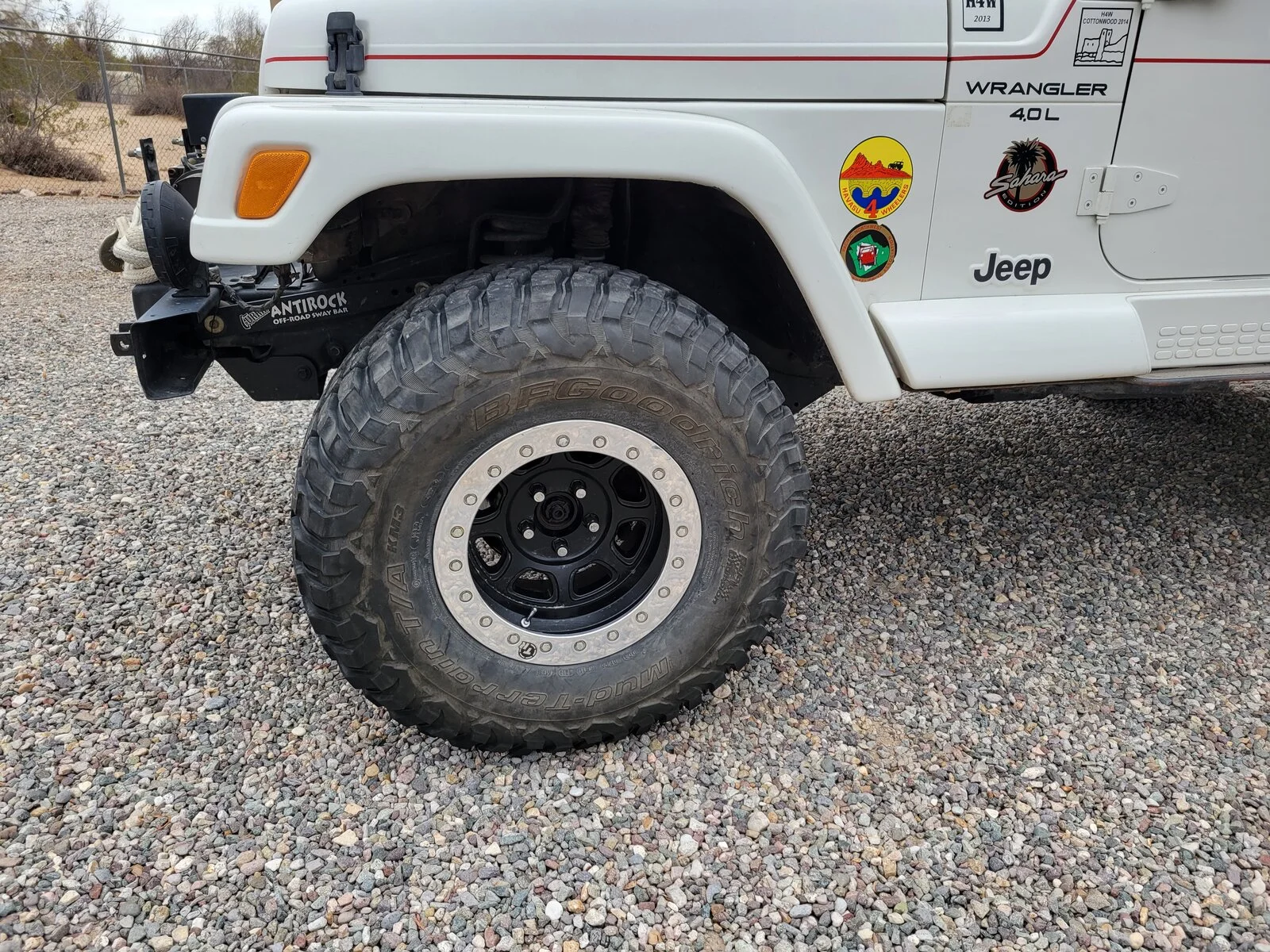

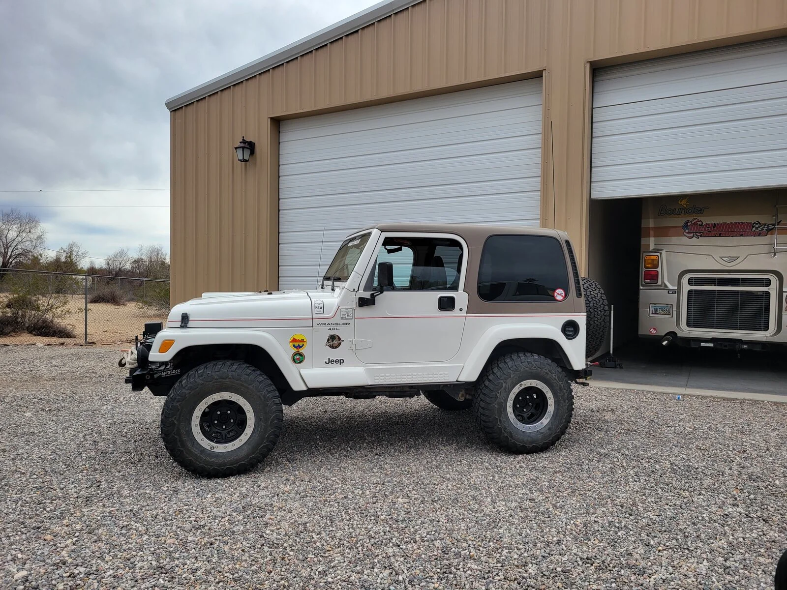

While I was out here working on her, I decided it was time to mount my new to me Trailready beadlock
wheels I scored a couple weeks back.
