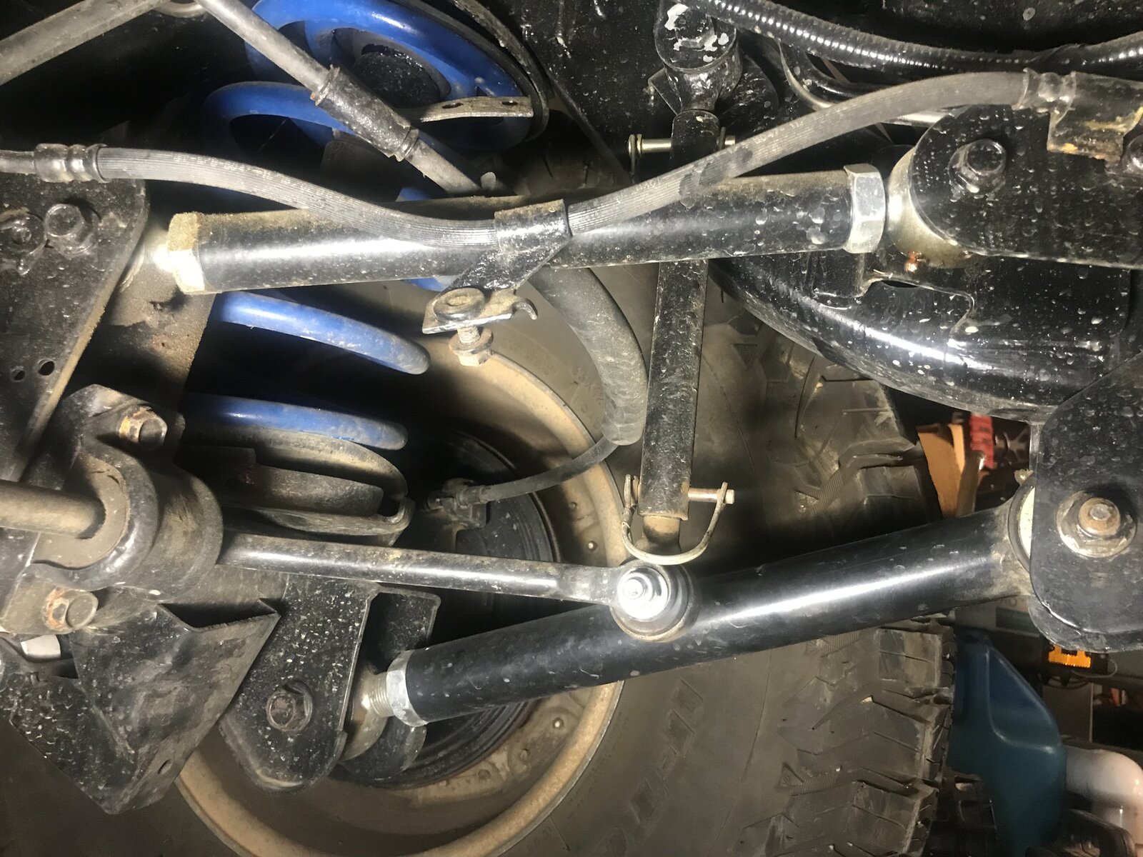

Hi all, I had my Jeep regeared a couple years ago and I’ve maybe put 2-2500 miles on it since. Chased vibration for a while and ended up doing Yukon spin free hubs and didn’t really drive it much after. That cured it maybe 60%. Found it too late today to do anything about it and still planning on putting 100 highway miles on it tomorrow with a couple hours of trails in between. Been like it is for a long time. I doubt it’ll hurt anything but it will sure be annoying knowing what it is.

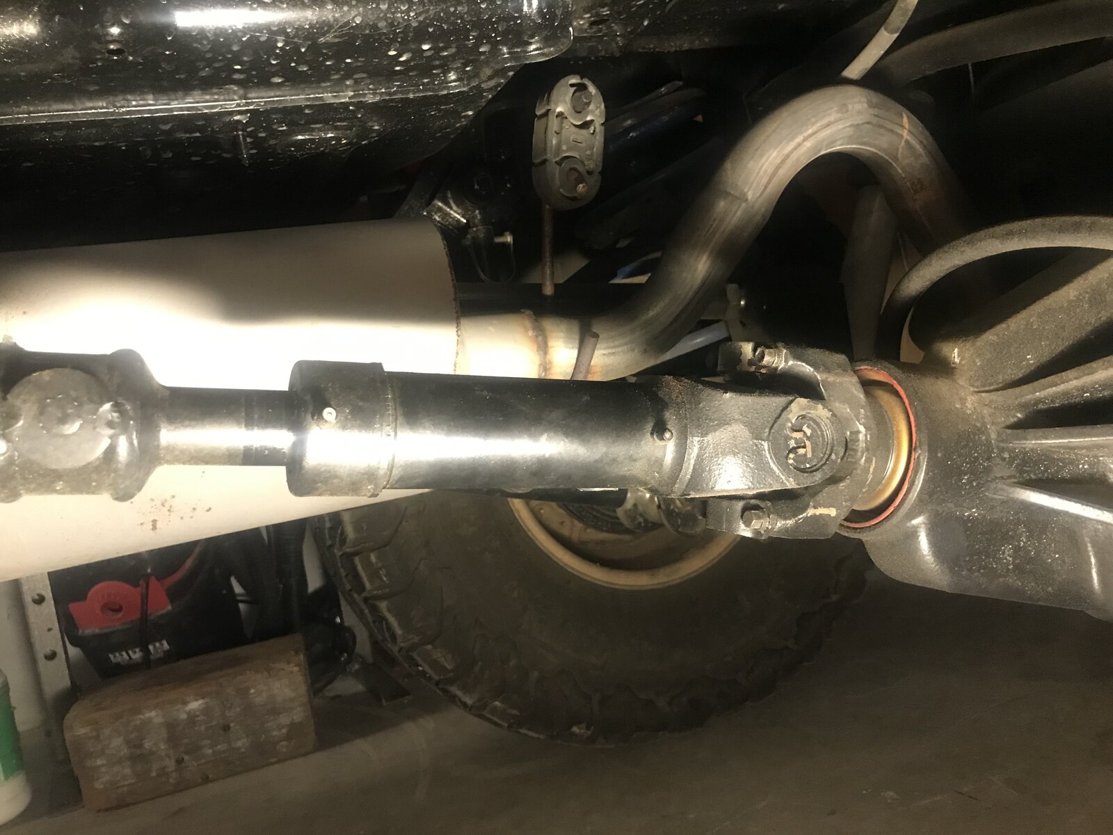

Still has a lumpy type vibe off the line and cyclical droning vibration beginning at 55-60 mph and the faster you go the more intense it gets. I have a digital cube angle finder And I have found the rear pinion is higher than being in line with the driveshaft by 3.6 degrees. The gauge is accurate, I set my saw tables and blades with it. I was underneath for something unrelated and could visibly see it was way off, not sure why I never noticed it before. I guess I had a hard time believing someone could go through the trouble of lifting the Jeep, buying adjustable upper and lower control arms all around and not align it or check angles. In fact the place I had regear it said my control arms were on backwards and that the articulating ends need to mount to the axle instead of the frame. I paid them to put them on in the proper orientation.
At any rate I have been reading a lot about adjusting control arms and have read about having the axle in the optimal location. What’s the optimal location? It’s nowhere near the gas tank and my upper control arms appear to be adjustable without removing an end but they’re at the bottom of their adjustment.

I dunno without better photos but it looks like your pinion angle could be a tad high which can cause vibrations, especially when starting hard in 1st gear or when accelerating. I'd lengthen both upper control arms a full turn on both sides (or shorten the lower arms) to lower the pinion angle a tad and see if anything changes or gets better. It's hard to know if the driveshaft length is too short or not without knowing how much is engaged at its slip joint. It doesn't really look too short but...
Set the pinion angle like it shows below for your type of driveshaft.make sure the upper arms have the same amount of tension on them so the relatively weak brackets don't break. Since your uppers are double adjustable I'd loosen them up with the jeep on the ground and evenly adjust to get the pinion pointed at the transfercase output. If hey don'thave enough adjustment then you have to unbolt one end of the lowers and evenly adjust.but the jeeps frame and axle need fully supported for that.

In the meantime, you can adjust the pinion angle easily just with the uppers to dial out the vibes or try to. Your rear pinion angle is too high. With those arms, a quarter of a turn is about 1/2 degree of change.
If you want to use the angle finder, start with both at the same angle and then move down in 1/2 degree increments until it gets better or worse and go from there. The vibe at take-off generally tells you that the angle is too high. The cyclical harmonic is going to be the issue to dial out.
After you get the vibes handled, THEN you can pull the springs and center the tires at full stuff and under articulation. Don't worry about the shocks now, they aren't contributing to the vibes much. (Unless the axle is pushed far enough back that it is messing up the shock bodies)

Good point. Pinion is 3.6* high in relation to the driveshaft. Upper control arms are bottomed out on adjustment, will have to lengthen the lowers. Since only one end is adjustable then a half turn=half a degree or close? 6.5 turns to zero.
Not sure on the lowers since they are closer to the axle centerline and should be 1"-14. If so, 1 full turn is about 1/16" change and I'm not sure what the angle change will be due to them being closer to centerline. I'd run them out at least 3/8" longer and then start messing with the uppers. Again, just to get the vibes dealt with and then once you know you can do it, then mess with getting the rest squared away.
I did as instructed. Rear pinion is 1* low in relation to the shaft. Vibes off the line are gone but we’re still present at highway speeds. I knew it wasn’t tires because same tires only a few miles different from when I had it regeared.
Pulled rear shaft and went for a cruise on the freeway, vibes 90% gone! I can definitely hear more hardware turning up front since I’m usually driving with hubs unlocked and I wouldn’t say it’s vibe free with the front shaft in play but I could run it up to 70-75 without the console vibrating my elbow.
