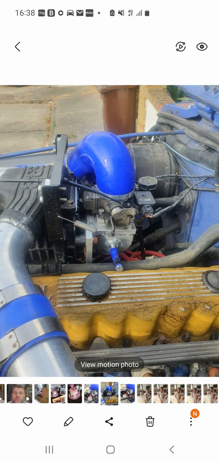

Hi
Anyone firmilar with boostedtech m90
Got a problem with 3 different answers .
The fitting kit says to connect the manifold to top.of rocker - result engine stall
The fitting garage blanked it saying it runs perfectly blocked. It doesn't pressure back the idle motor- result engine stall
The super charger specialists say should be non return value set at 2bar. To maintain pressure but prevent to much
Anyone know who is actually right ?
Picture you can see small blue pipe blanked.
