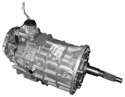

AX needs deeper first. 3550 is only slightly better.

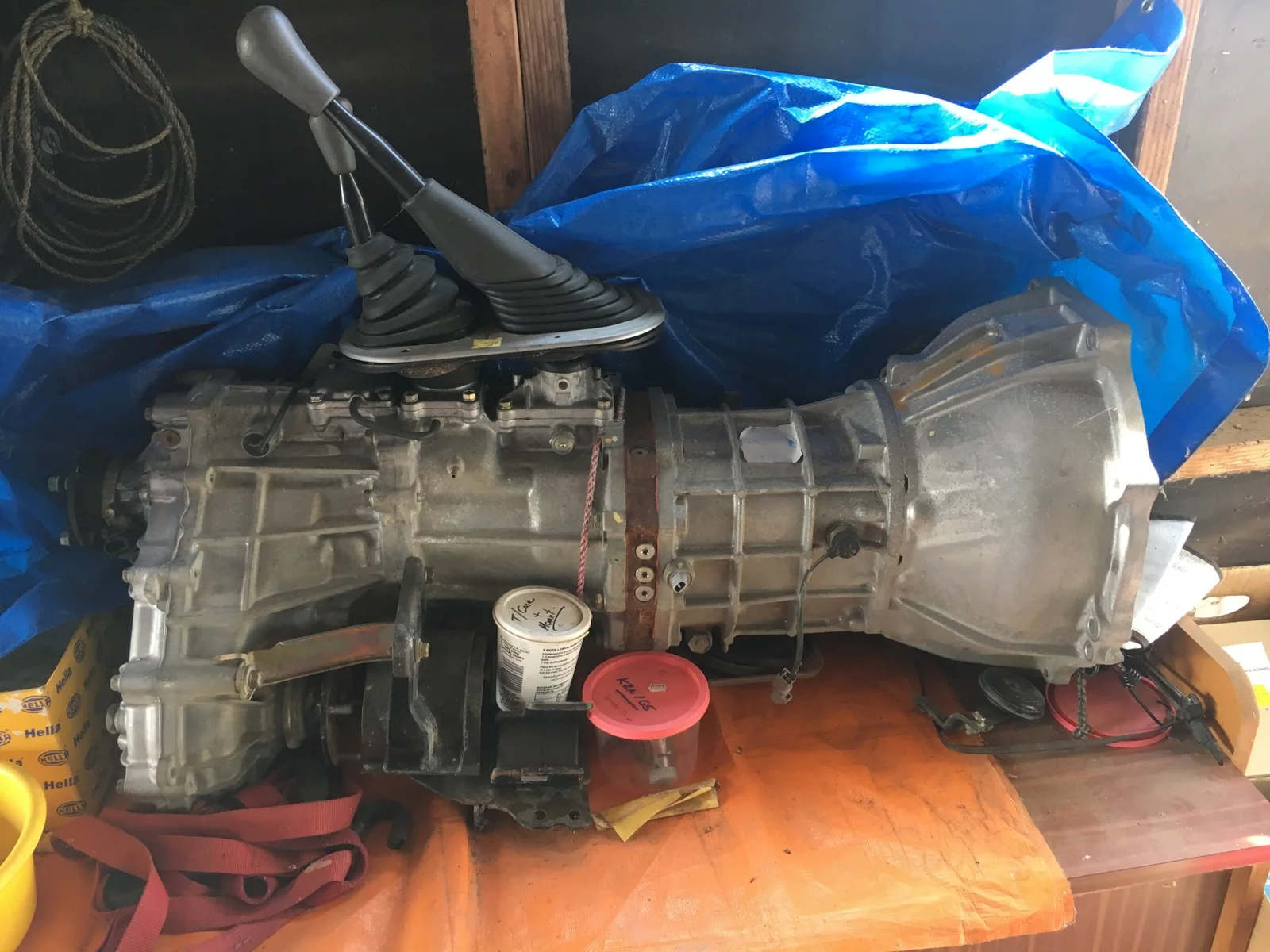

Search around re: the Toyota R series transmission. Shares a lot of parts with the ax15 and there are rumors that it might be possible to get the R151F countershaft and 4.3:1 first gear assembly into the AX15. I came across some threads about it on pirate a while back but never did find any that claimed to have a working example.

I'll look into that, thanks. I wonder if the whole trans from a toyota could be used with just a bell housing swap, or is other stuff like the input/output shafts different.

The rear housing is different so it won't bolt up to a 231. I would suspect the output shaft is probably wrong too, and I think when I was searching I read that the input shaft was different. I don't know Toyota t-cases but I believe the one that came with the r151f was passenger drop. Maybe it's possible to swap the jeep input and output and rear housing onto the Toyota box?

You can absolutely swap parts to get 4.3:1 in an ax15 but I’ll give you a dollar if you can find them available here in the USA.
