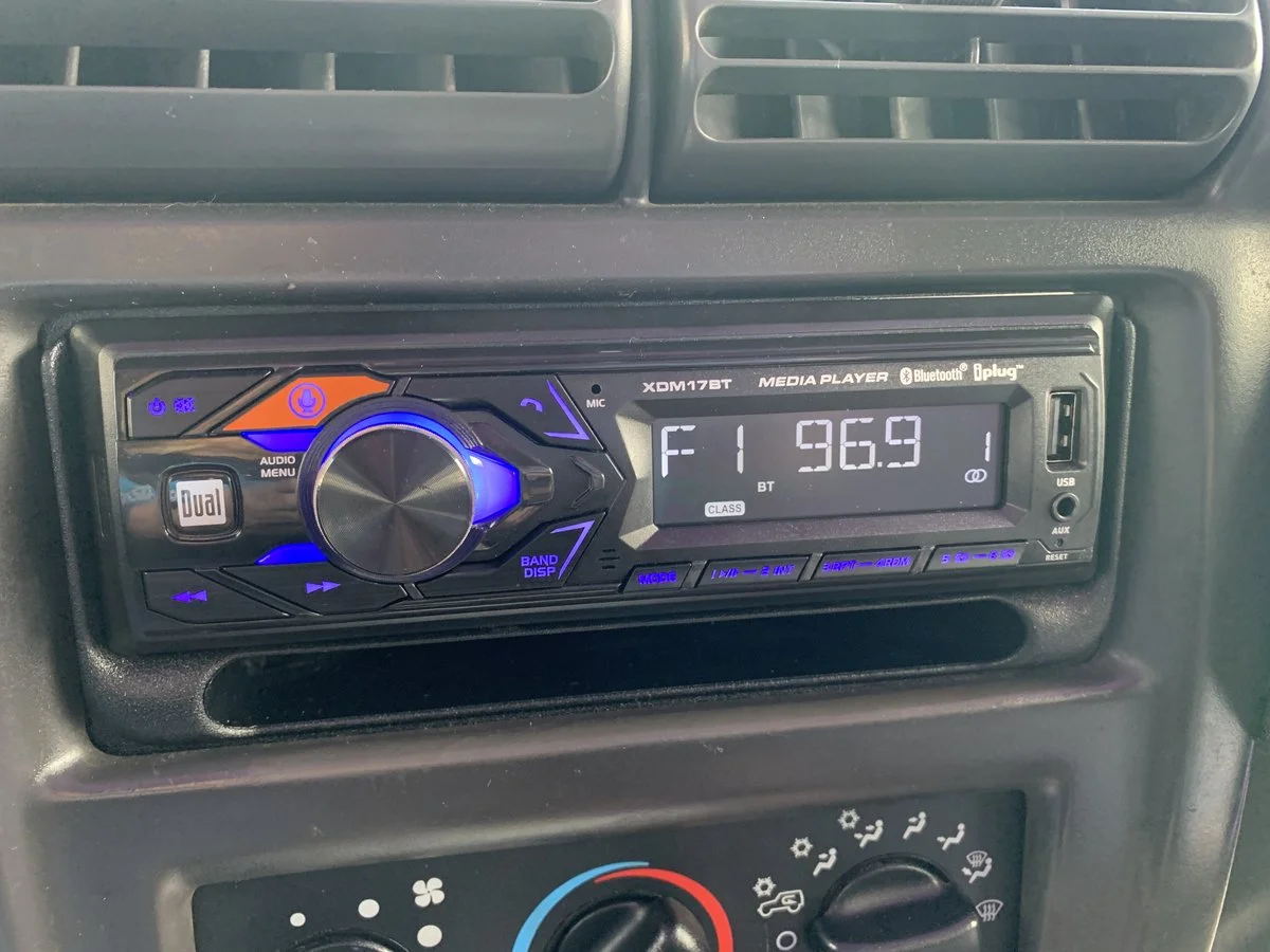

I bought this little guy today. The girl at Walmart told me she thinks it is just the face. I told her no, I think it is the whole radio. LOL I didn't want to spend a lot of money so it came to about 22 bucks with a 2 dollar 2 year warranty. LOL I don't care about cd's anymore so my main concern was being able to hook up to my phone. It does that. :D
Have you ever seen a radio so small? I shouldn't have to worry about it getting bounced around. There isn't much to bounce. LOL
No, the lights are not purple, just looks like they are in the pic. They are blue. Only thing I don't like about it is that the clock will not stay as the main screen. I have to push a button for a few seconds to get it to display the time, then it will automatically go back to the radio station display. But, for 22 bucks, if it dies in 6 months, I won't be out a lot and if the warranty works, I get another one. LOL

I recently installed a Kenwood Bluetooth stereo that lacks a disc player. It's not THAT shallow, but it's probably half the depth of the CD player I took out. I thought the same thing...maybe this one will be less prone to breaking the mounting bracket.
