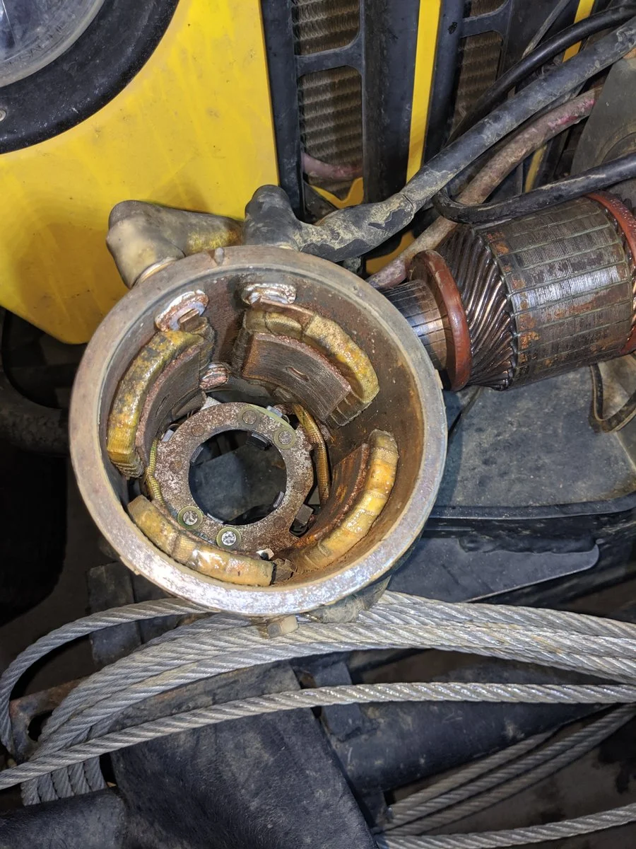

So today. (I've already allotted a little budget for a winch, so don't think I was trying to fix this for keeps) I decided to try to get my Badlands winch working in my tj (that hasn't been used in over 5years). I was fully expecting it to be rusted together/ seized up. I open the gear side (forgot to take a picture) looks beautiful, tons of grease, spins very easy(with the clutch engaged) so, problem is electrical.. has to be..
Open up the electromagnetic side, and I notice it's missing one of the bolts that holds that entire assembly to the winch. Oh boy. It's rusted, corroded, and super nasty.
So, after cleaning that up with a wirebrush n junk, I took apart the contactor box and cleaned that all up (I didn't need to, for when I hit the remote I could feel and hear the contactor actuating).
With the cover off, mind you it's not seated how it should be, I was getting spark and the shaft wanted to turn(was just bumping it).
I put the cover back on and nothing, missing bolt on it though. On the winch frame thingy there are FOUR threaded holes, the cover only has two bolt holes for two bolts. So I'm thinking that it's not making good contact when it's all assembled. I'm tempted to throw some more holes in the cover, get three more bolts and see if it works like it should.
Weird that it's got 4threaded holes, but only two that actually get used. Chinese junker.

I a winch has ever seen water, the inside of the motor will look like that. I have yet to see one that's painted on the inside. The motor on my 8274 is only held on by 2 screws as well...
The brushes look like they're hung up too. They should spring out a lot farther than that.
Reactions: Yellow_Machine
There was a tiny tiny Gap on the two at the bottom I'm thinking because there was only one bolt holding it together.
