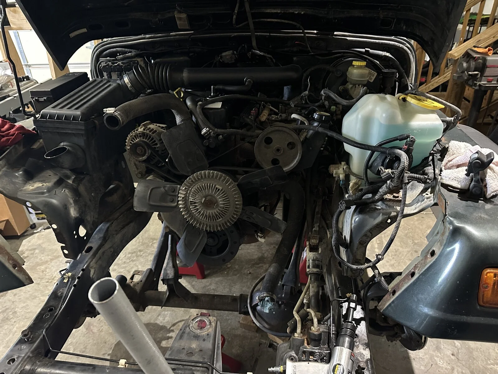

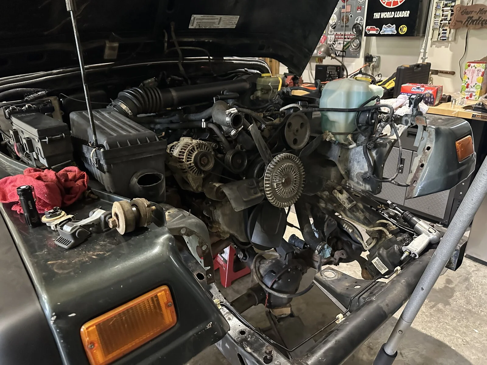

Anything I should replace while the grille is removed?
NCLife
May 22, 2023
139
Charlotte NC
So, I had to remove the front grill to give me enough space to drill out a couple of broken bolts. I'm wondering what everyone would advise I replace, if anything, while I have the front end torn apart. It has a new radiator already. One obvious thing was the rubber body mount spacer things. I'll check the serpentine belt but it looks fairly new. Any thoughts and recommendations are appreciated.

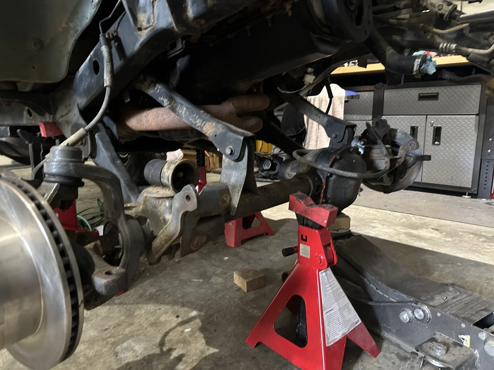

I removed all of the steering components and am doing the ZJ upgrade, cleaning and PORing the frame along with fluid film in areas I don't want to paint. I'm in NC so once I get rid of the surface rust I'm good to go. I did notice brown sludge in the lower radiator hose when I disconnected it. So, even with a new radiator I suspect it wasn't flushed. It had a blown head gasket which was repaired before I got it. Maybe that sludge is from that? Other than that I don't have any known issues to resolve, I was thinking more preventative while I have it apart. 177k miles.

Cooling system is the most obvious thing, especially with the sludge you describe. Good flush at minimum. Thermostat, hoses, maybe water pump are all things I would consider, at least. If you replace the thermostat, don't use the "saftey" style that lock open. Get a Mopar or stant 195 deg and make sure the bleed hole is up.

If the one you get doesn't have a bleed hole, add one. Drill a 1/8" hole in the outer ring of the thermostat, you can Google to see where to put it.
