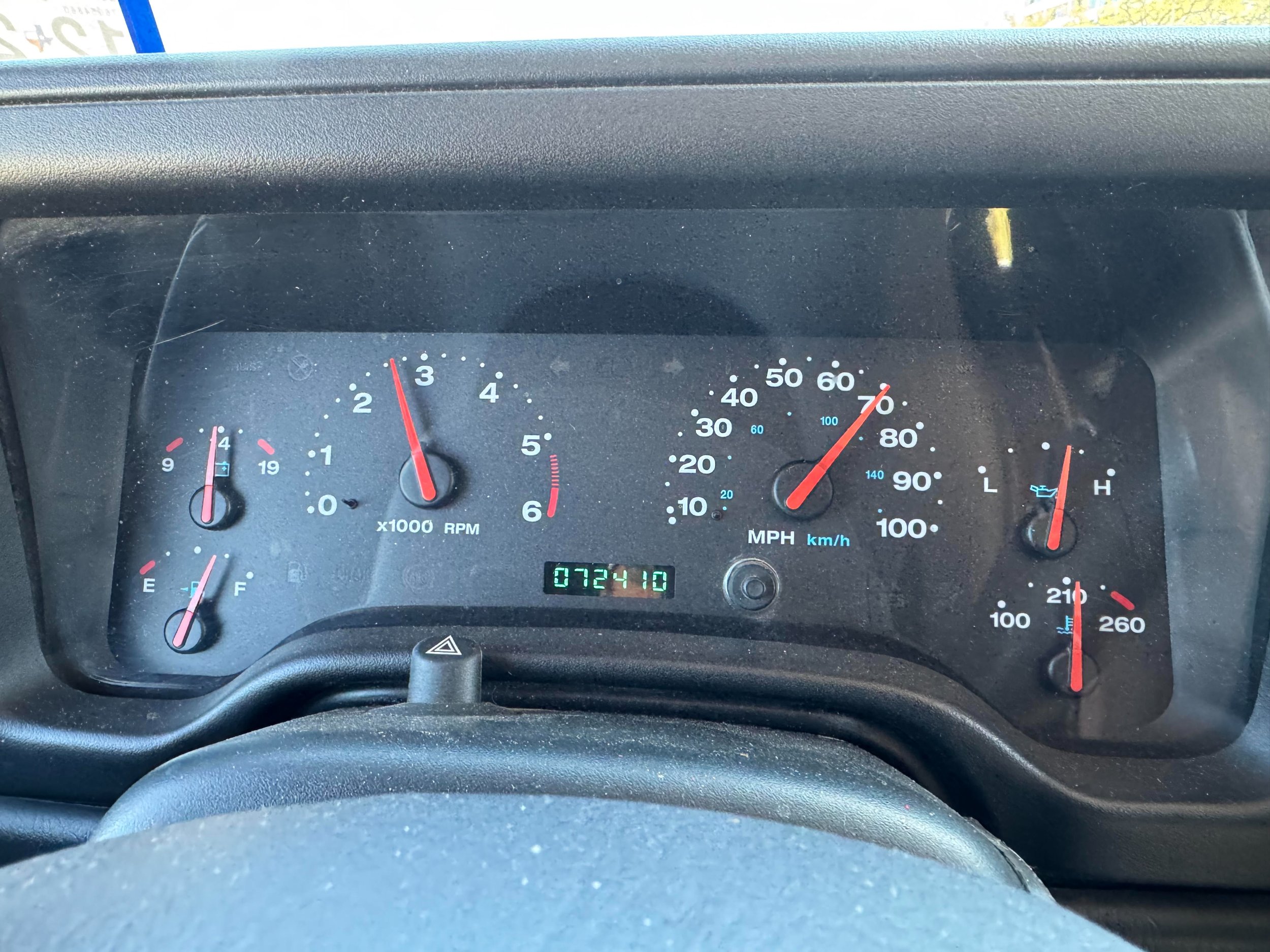

FWIW, this is mine after 5.13, 42RLE and 33" tires, it was running 2,750-2800 at 75mph. If you're sure you aren't going to go bigger than 33s maybe just go with 4.88.
