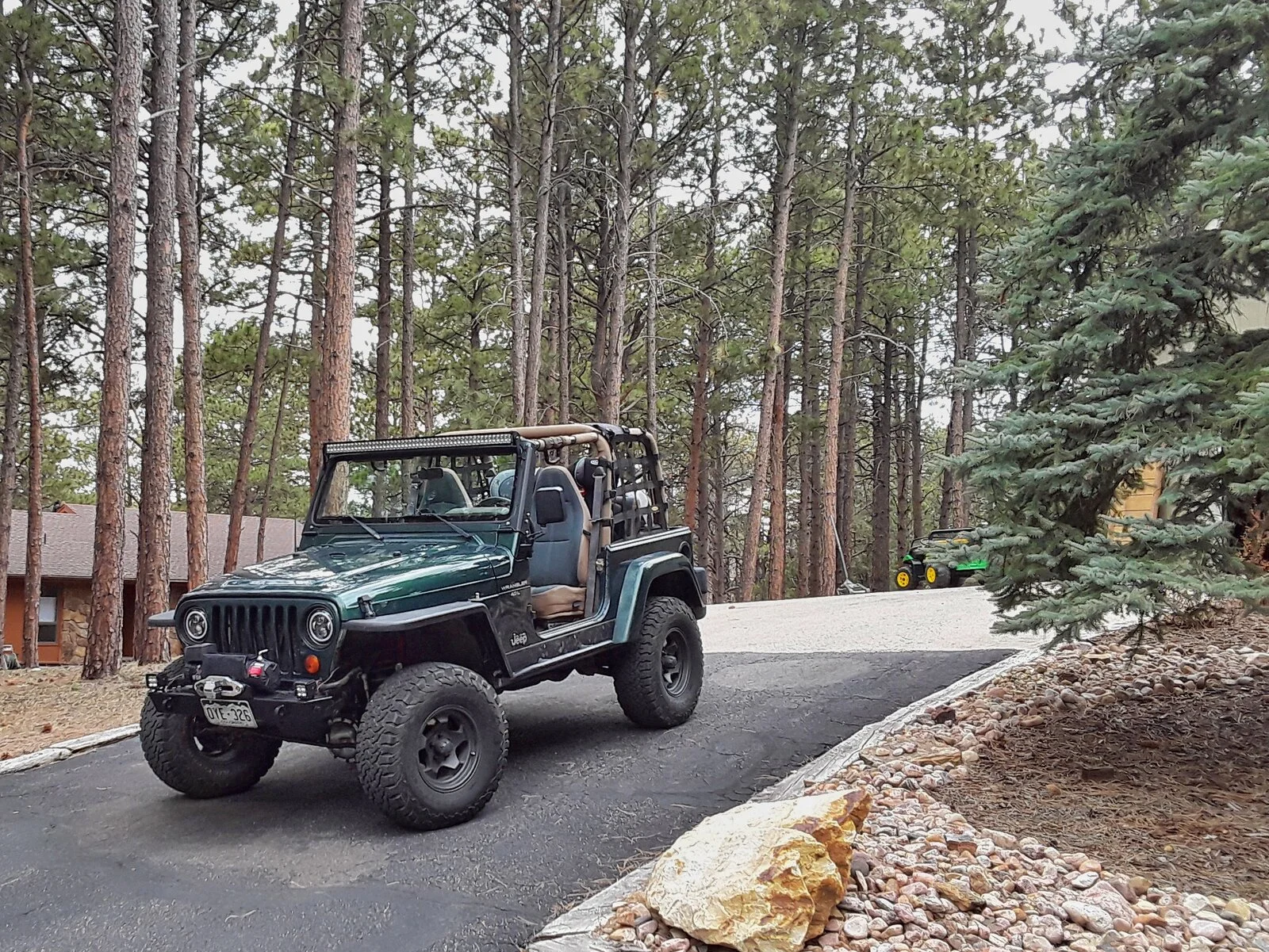

nice looking rear corner of that MG...1980?I have MB wheels on mine. Very affordable and I like them. 16”.
Yep. We got that for my mom for a retirement gift last year. FYI she’s still not retired.nice looking rear corner of that MG...1980?

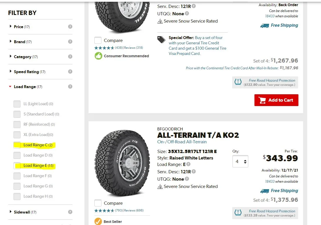

To many plys, i.e. stiff, for a lighter TJ. Some run them and live with it, but you're better off with a C or even D rated tire.For a newbie thinking of going to 16’s from my 15’s on my LJ. Why is a load range E bad???

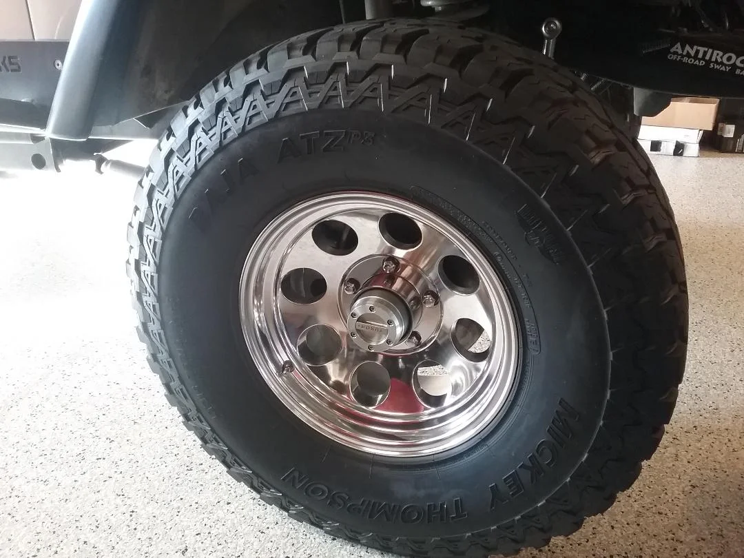

New guy here. What exactly do you mean by "8 hole" and "d hole" wheels?Yup. Those are my #2 pick for rims. If not the 8 hole, then the "d" hole rims.
Or 17.5" for that matter. I've also seen a 14.5" used for Mobile Home tires.
Look at the wheels in the post immediately above yours, those are D shaped holes. 8 hole just means how many holes.New guy here. What exactly do you mean by "8 hole" and "d hole" wheels?
If I were buying new wheels and tires I would purchase 17x9 wheels and either 35x12.50R17 or 315/70R17 ("metric 35") tires. There are good choices for both "C" and "D" load ranges. [There are many 33's as well, but I haven't researched those.]
I would not choose the 15" size. 17's are the new 15's. JK's and JL's come with 17" wheels, which means that 17" has and will continue to have a greater market share than 15". The selection of tires for 17" rims has been increasing while the selection of 15" tires has remained unchanged or is decreasing. Running 15" rims will also limit the size of the brake calipers that will fit thus limiting the available choices if one chooses to upgrade to larger brakes.
If I wanted to buy tires only, I would stick with the 16" wheels and deal with the reality that most will have an E load rating. I would focus on the few D's and the "softer" E's. You are correct that there are still many good choices, and though a C load rated tires is better matched to the weight of a TJ the real world differences at low tire pressures are not so dramatic as to be a limiting factor to the majority of jeepers.
I was recently faced with the opposite situation. I had a perfectly good set of 315/75R16 Mickey Thompson Baja ATZ P3 tires that came with the jeep and were worth more to me as usable tires than they would be worth to someone shopping for a deal on used stuff. I needed new wheels because I converted to manual hubs with a 5x5.5 lug pattern. Faced with the dilemma of losing my shirt on a set of almost new 16" tires if I sold them plus the substantial expense of new 17" wheels and tires, I decided to sell just the wheels, keep my 16" tires and use them until they wear out - mounted on a set of inexpensive 16" alloy wheels with the new lug pattern.
