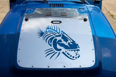

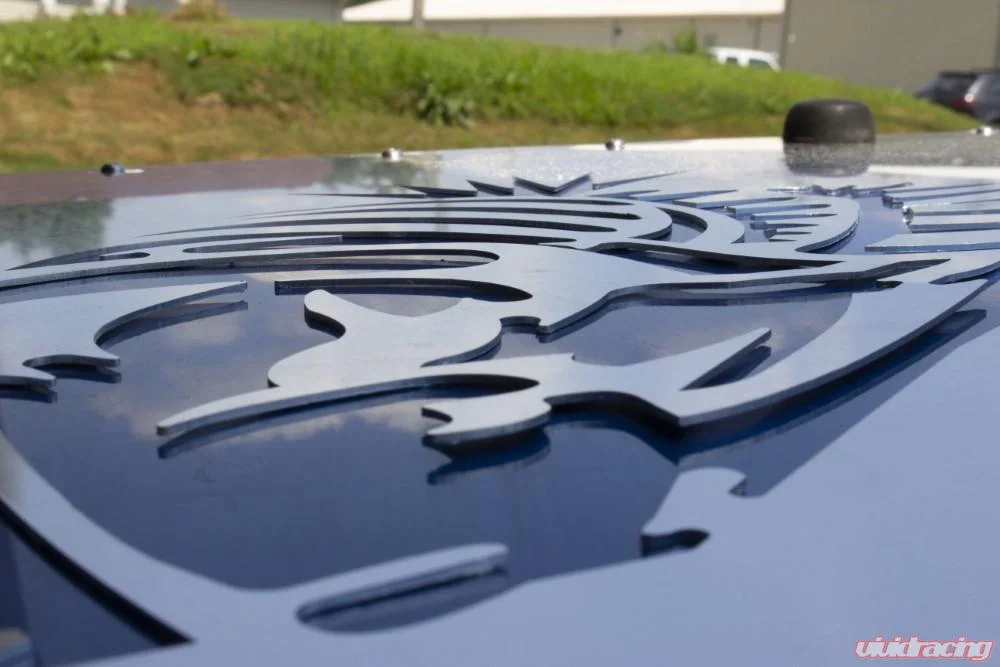

If you guys don't like the little Poison Spyder logo cutout, I'm guessing the Fishbone Offroad louver isn't on your Christmas list either.

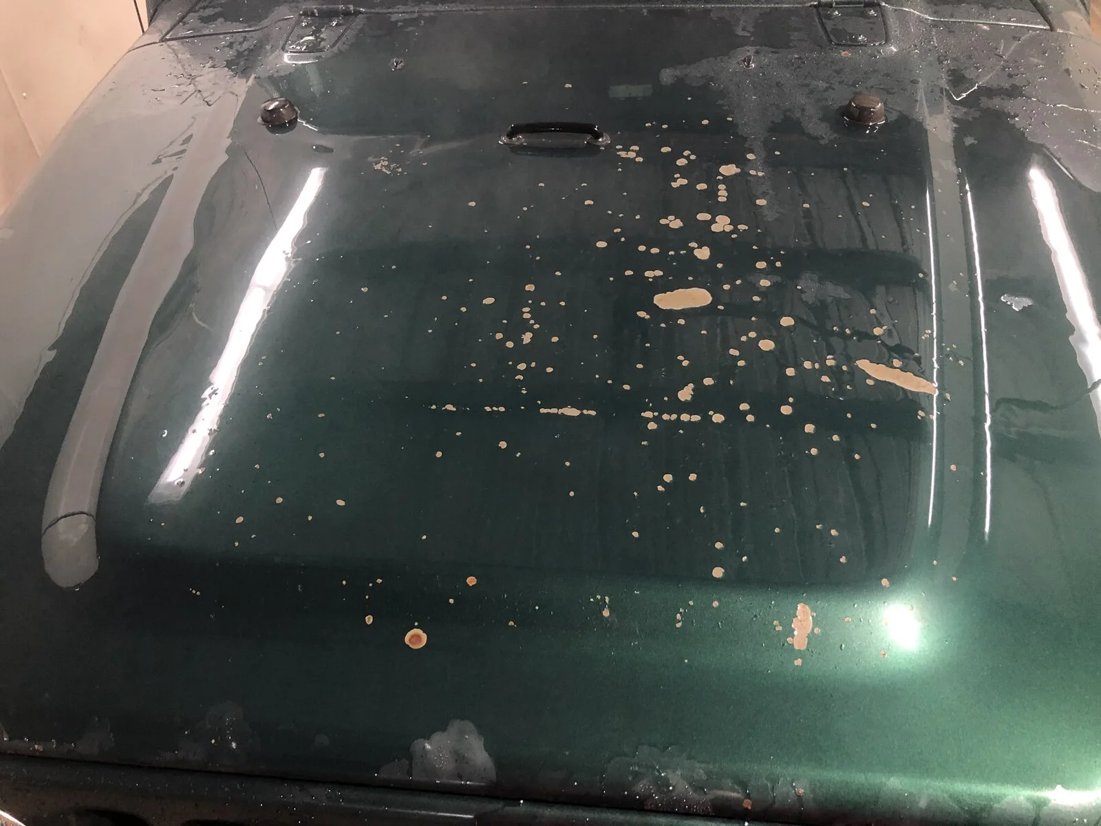

The heat cycles on the hood reek havoc on the paint. My Jeep was garaged for 15 years straight. 190k miles of heat cycles and one summer sitting outside in a storage lot caused this. Came back after the summer and the paint was gone.
Haven't fixed it, probably never will. Don't care.
This is right after a wash. The difference in color is due to water. The only problem is the missing paint.
Be careful with powder coat on aluminum. If water gets under it, its all over except the crying. It tends to thin out at the sharp edges, and let water in eventually. If it were me (and its not), I'd probably apply a good coat of paint over the powder coat - and seal all edges on installation with your favorite sealant.
Or look for a steel one, there's that whole dis-similar metals thing going on too.

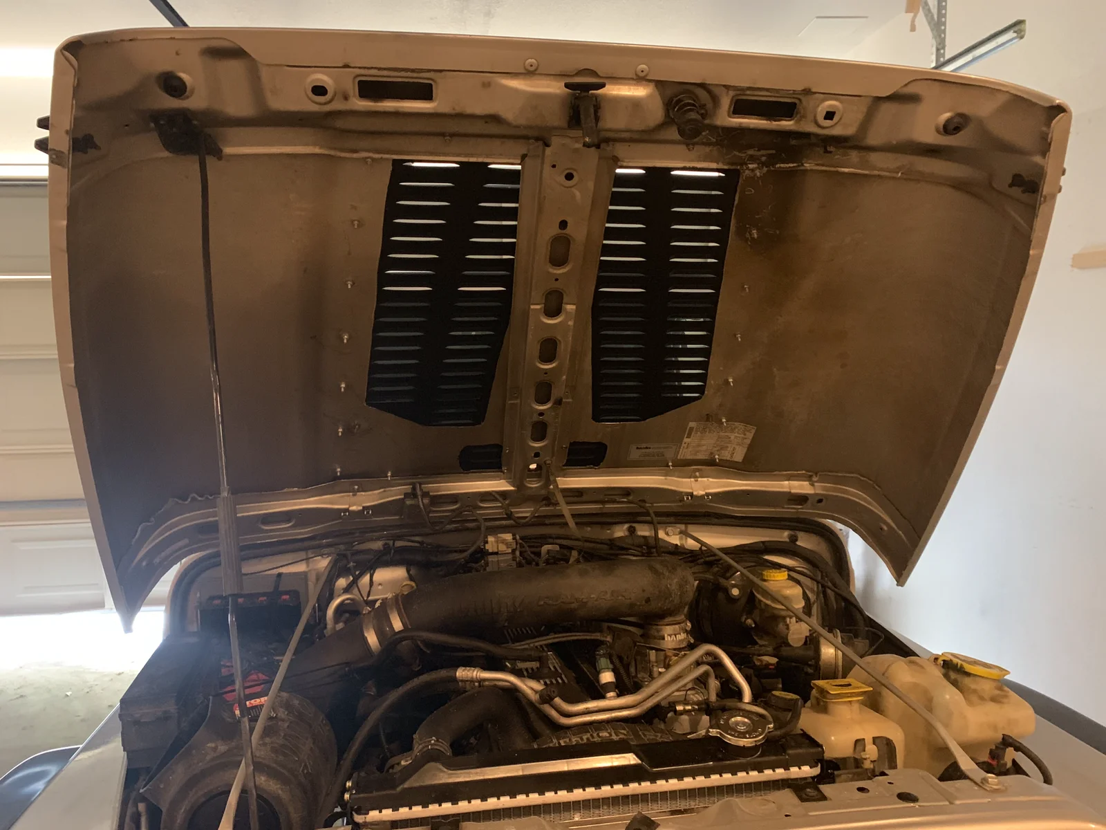

Or take the hood off, and take it down to the local hot rod shop, and have louvers cut into it. I'm actually toying with that idea, I'd put them on the sides so the Florida rain won't get in, but the heat can get out.
You cannot stamp louvers in the curved portion of the hood. That's why I am looking for a junk FJ40 hood. I will cut the curved louvers out and weld them into the TJ hood.

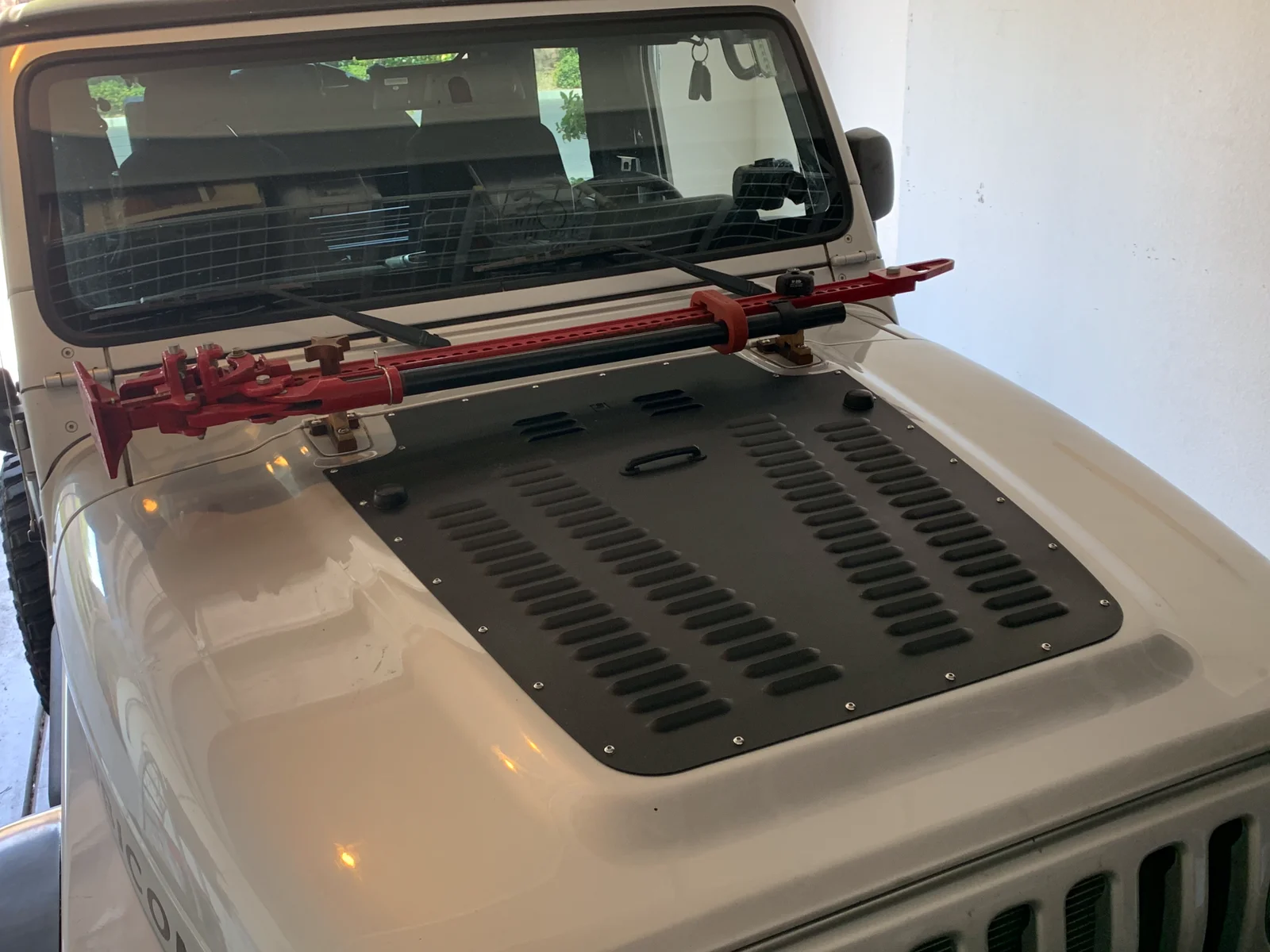

I ordered the GenRight louver. It comes in black, and it gets the job done.

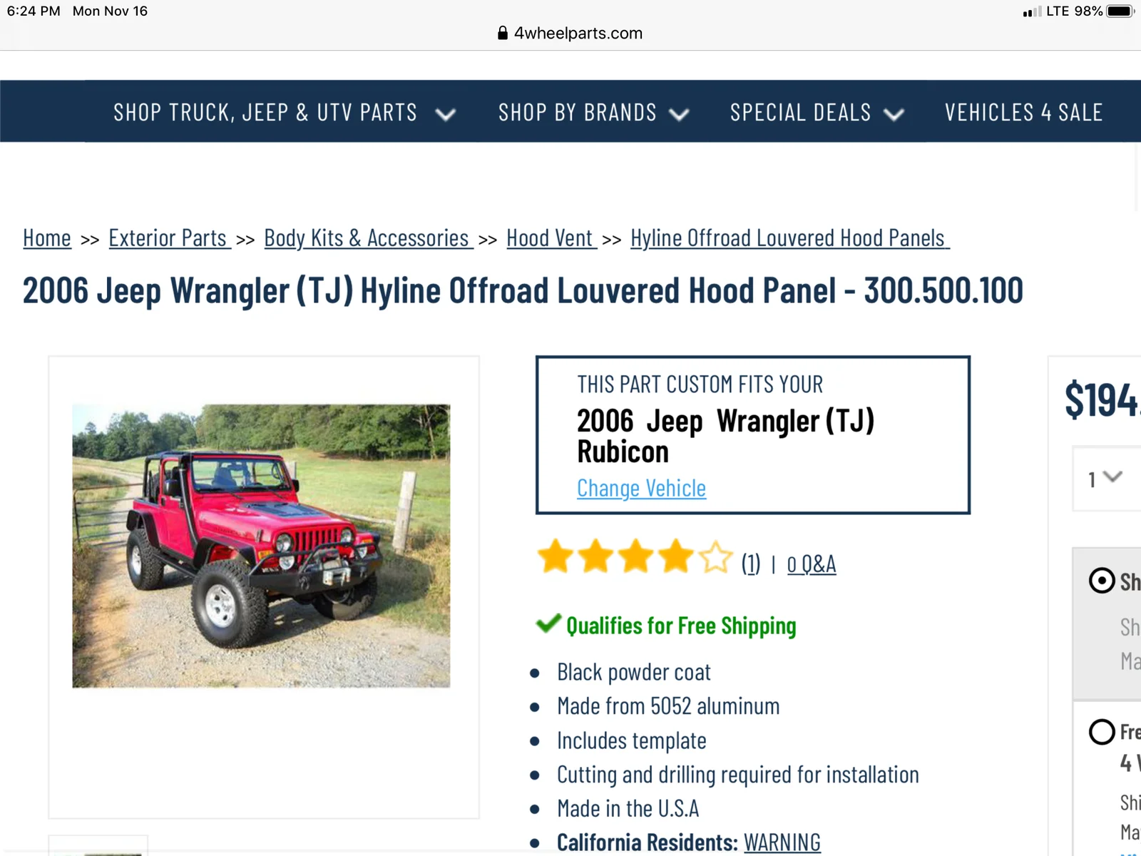

HyLine OffRoad one doesn’t have any logos. Is made in the USA and comes with a really nice metal template to drill and cut your hood with. The bolts are pressed in to all you need to do is snug up the self locking nuts. I really like the quality of it.

When it comes to laser cutting logos

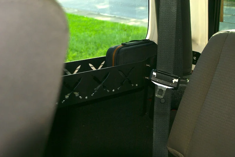

Yep. All that crap does is weaken the metal, and introduce another rust vector. I bought a weird little metal tray from Hooke Road that's nice enough and kind of handy:
But all the cut in sword outlines severely weakened the metal, to the point of my feeling I needed to re-enforce it on one side. Just because you have a water jet or a plasma cutter doesn't mean you should cut gratuitous designs into your product...
