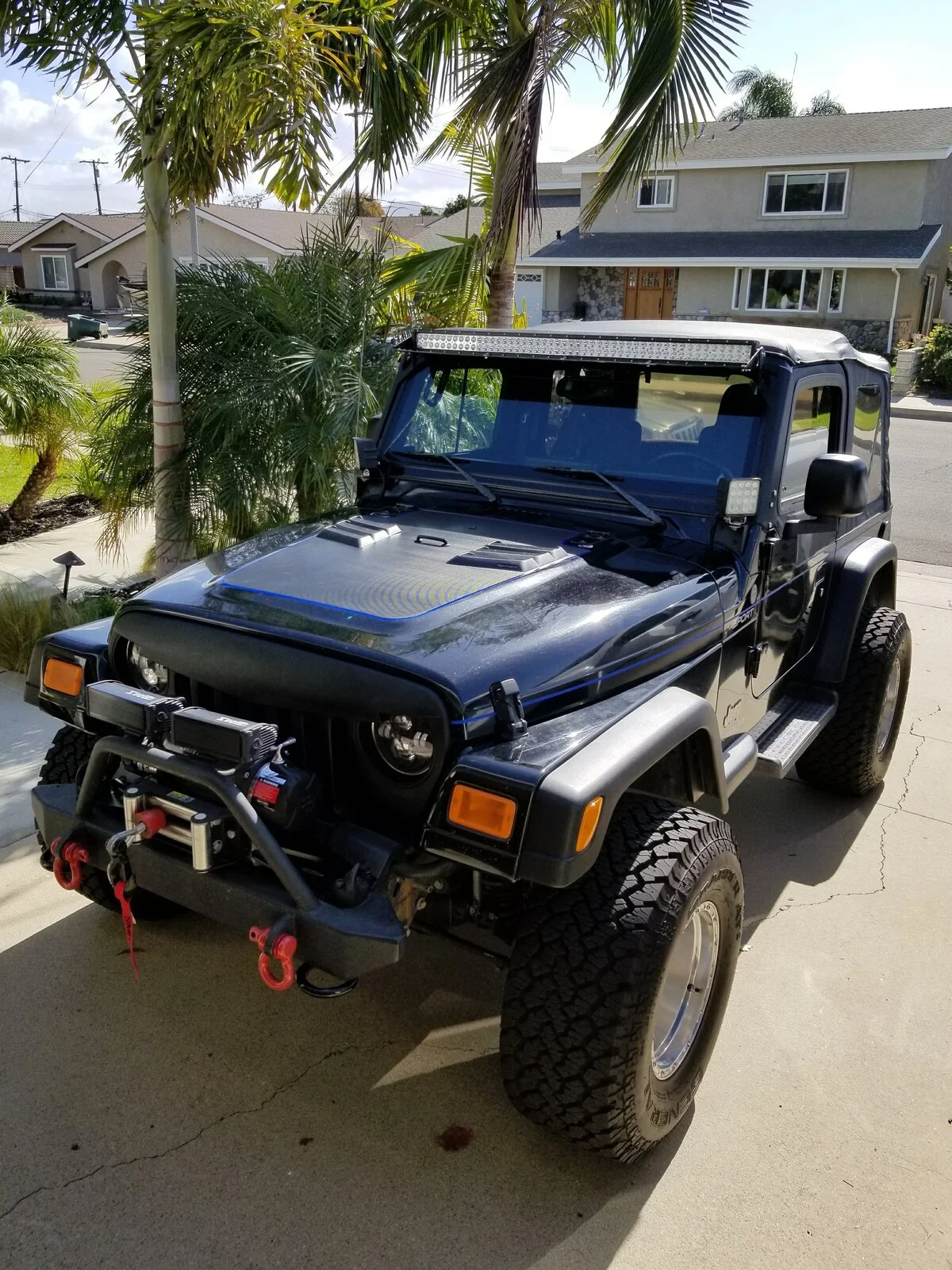

The paint in the center of our hood was blowing out, so we ended up putting a vinyl decal on it, and also cut in the smaller Rugged Ridge hood vents to help cool the engine compartment. Looks great. I didn't like the way the full hood louvers looked with the rivets and how it was not flush to the hood when installed.

I used a dremel from the back side and followed the cutout that was in the hood. I cut out just a little too much so used some RTV to hold it in place (again on the under side).
Makes sense. I noticed you used the original washer. I was thinking I’d buy a new generic one for a round hole and try that. Hadn’t considered my dremel.
I did the other holes with an ingersoll nibler, that was amazing but it won’t work for the washer hole in the louver.
The round generic one is probably easier! It’s just a nozzle, I honestly didn’t even think I could just change that!
