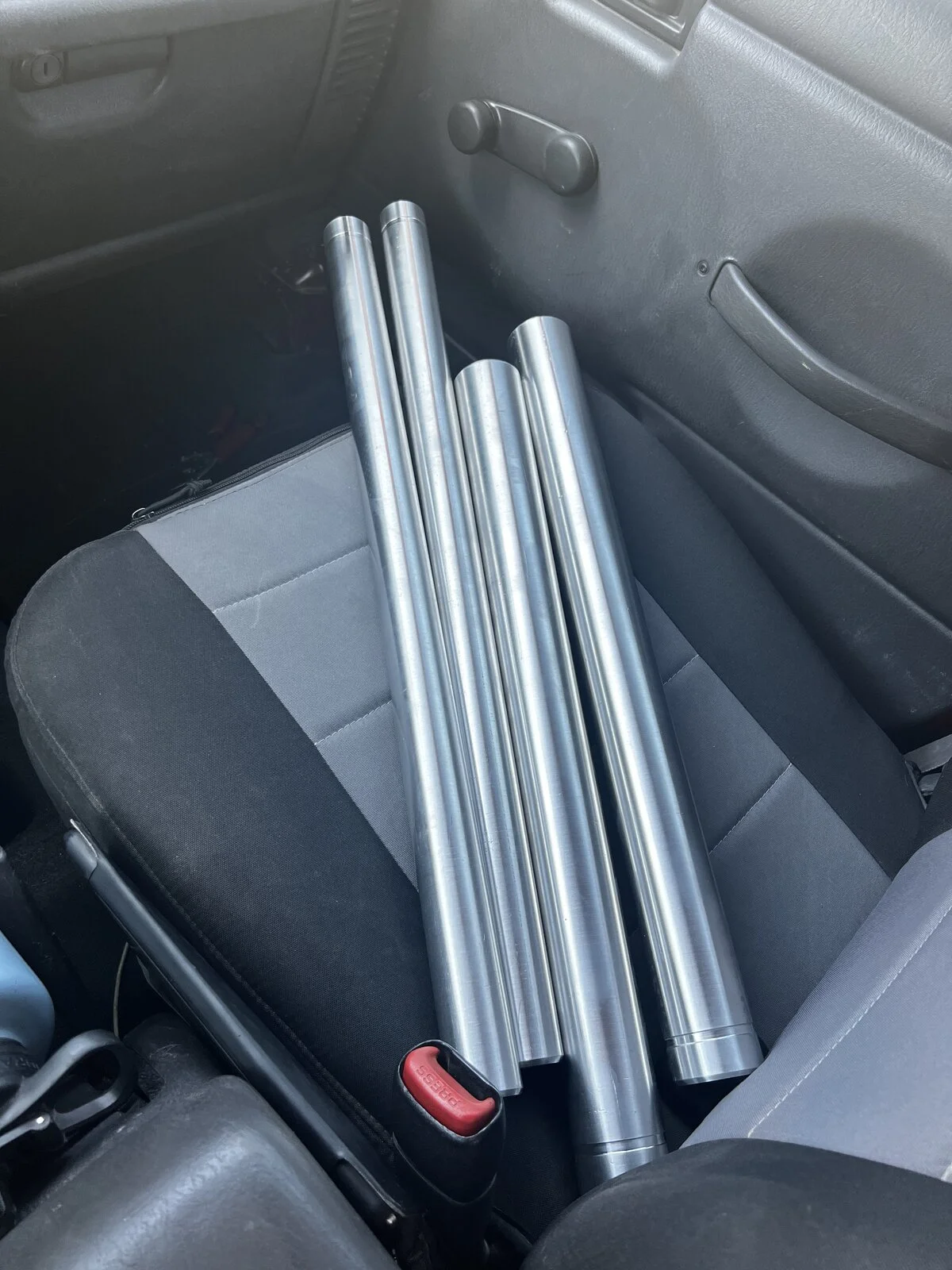

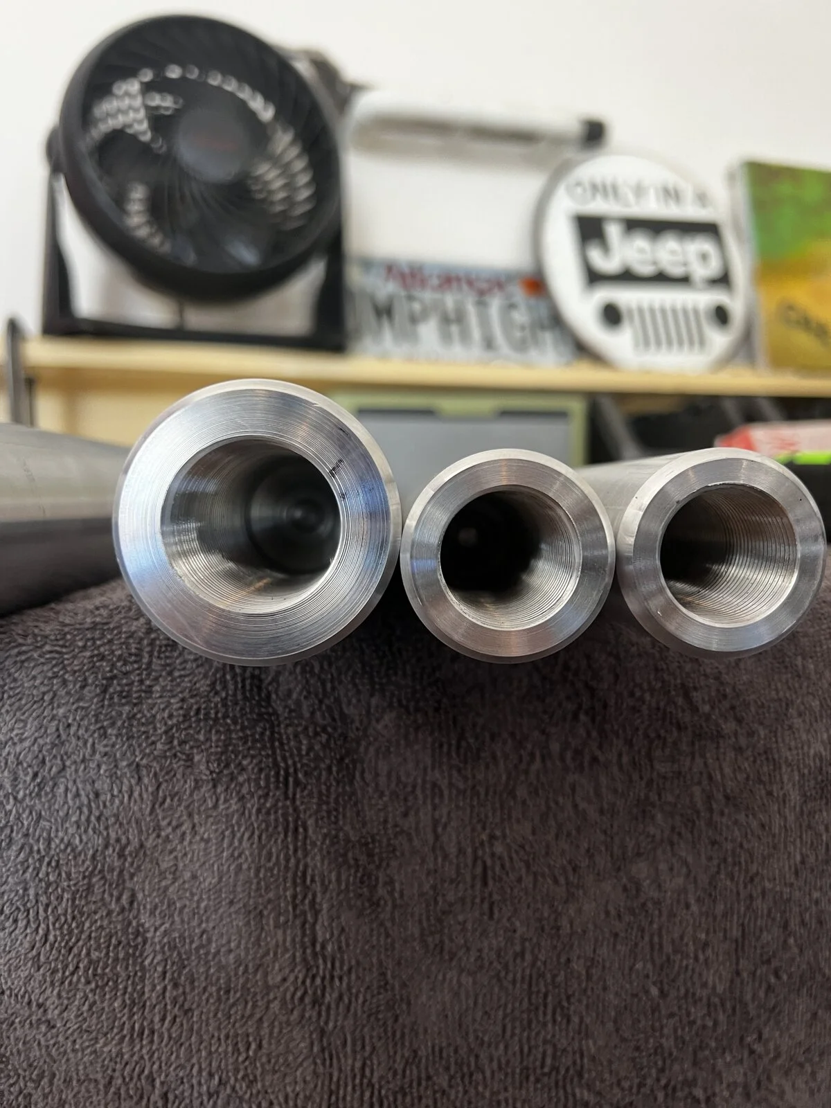

Midarm linkys. Picked em up and they were like wow these are some short arms! Lol

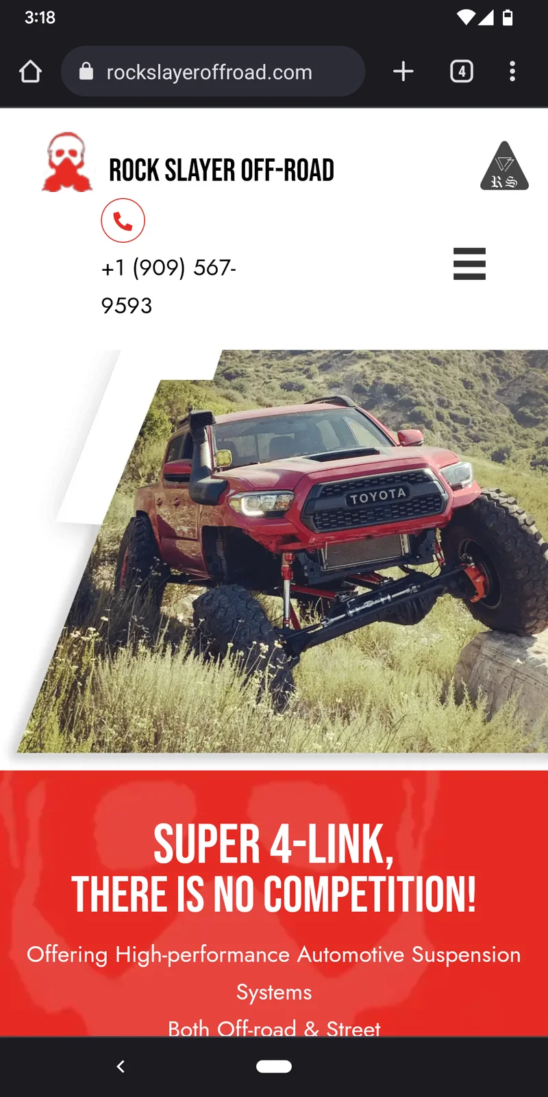

Why? Letzroll is a local company for him, and he probably doesn't want a 4 link front for a Toyota
