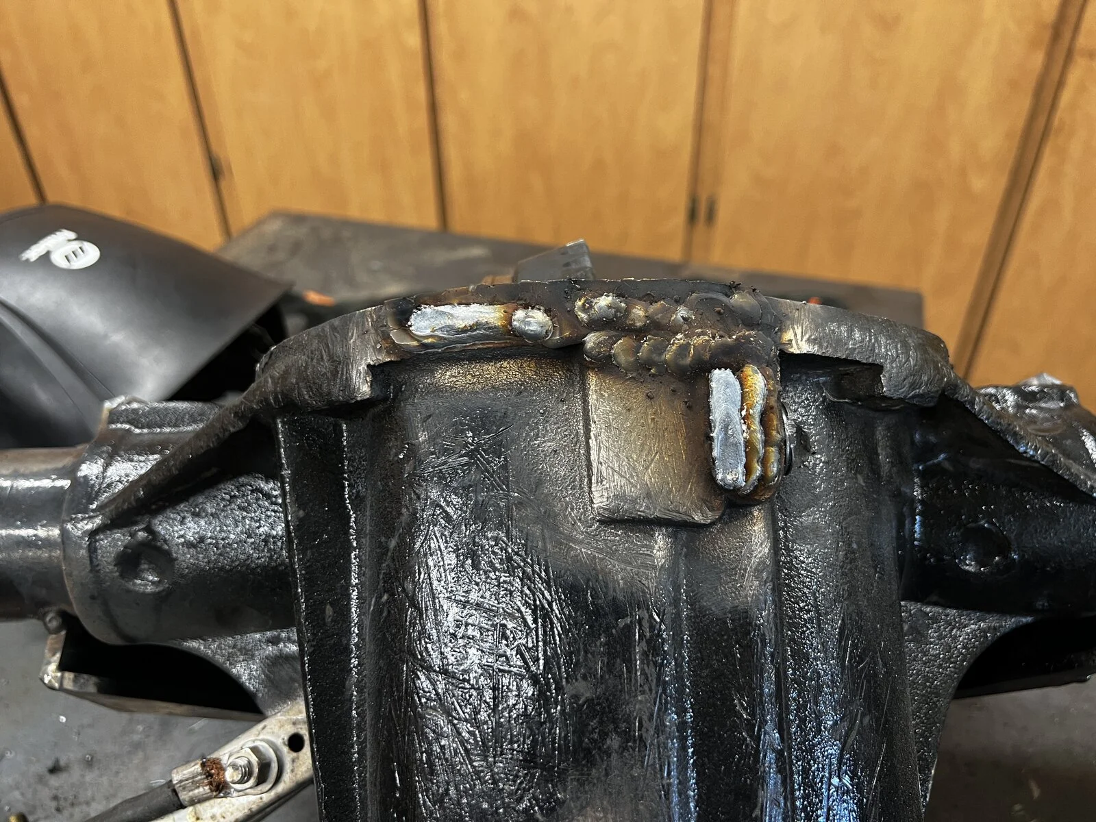

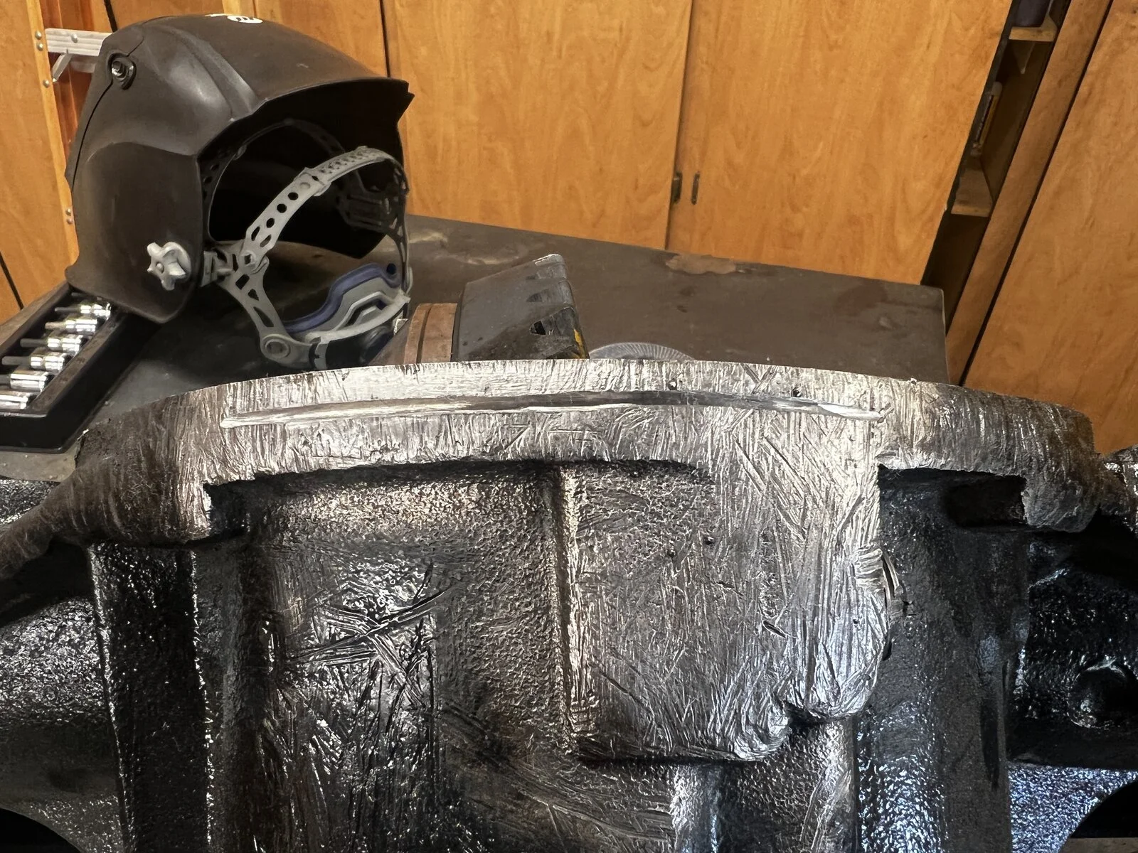

Hopefully adds some solid life! These welds should be much harder than the cast iron since mig welding on the cast iron pulls carbon into the weld. Blaineās knowledge there not mine.
I hate shoes. I strictly wear Teva sandals while I wheel and basically all the time. I swear shoes ruin your feel for the pedals
Did they seem to be harder than normal when you were grinding them?

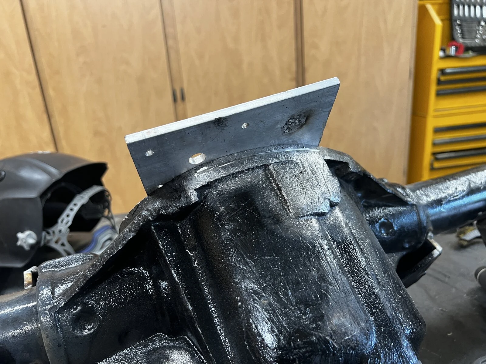

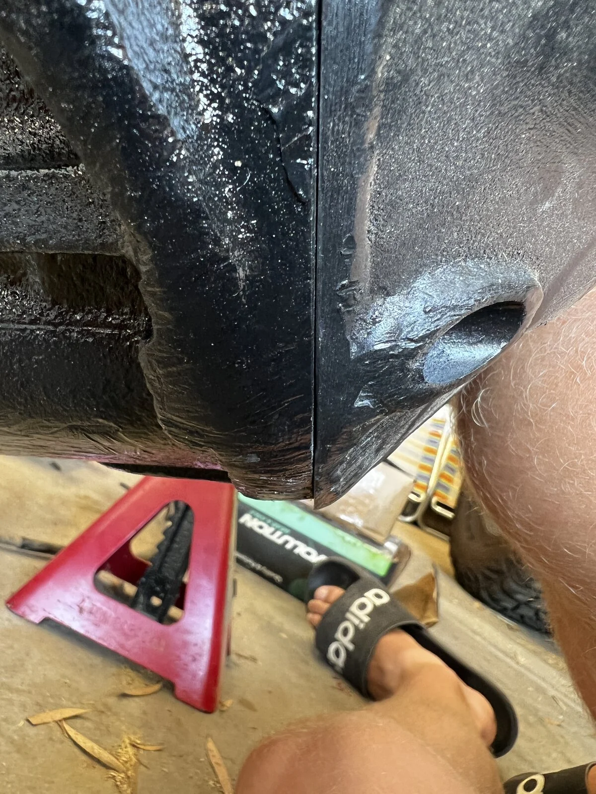

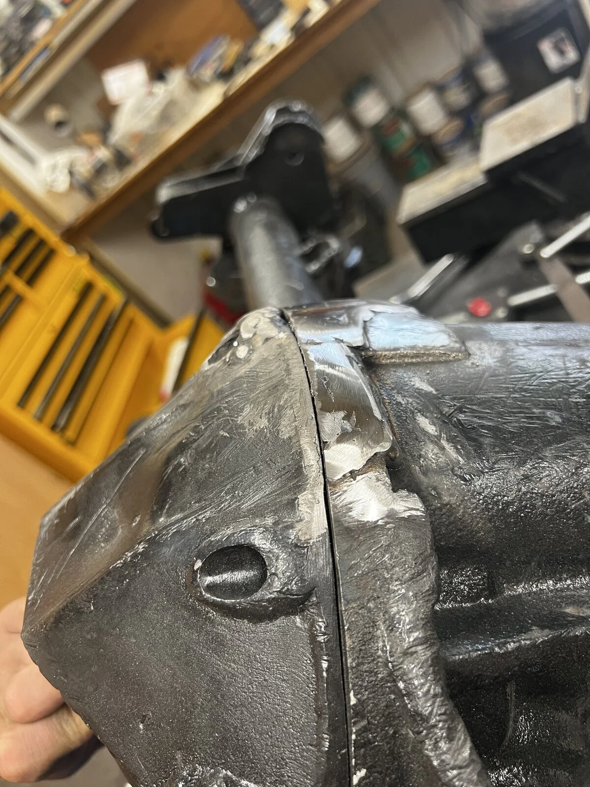

The housing was just a little worn down on the bottom. The barnett cover hangs down a little lower than the housing (this cover is used but was never on this axle).
I wanted to add a little meat to the bottom of the axle and add a āwear layerā to extend its life. Blaine came up with the idea. I started by cutting some small notches in the housing.
View attachment 361061Then bolted a piece of 1/4ā aluminum scrap to the housing as a backer
Weld some beads on

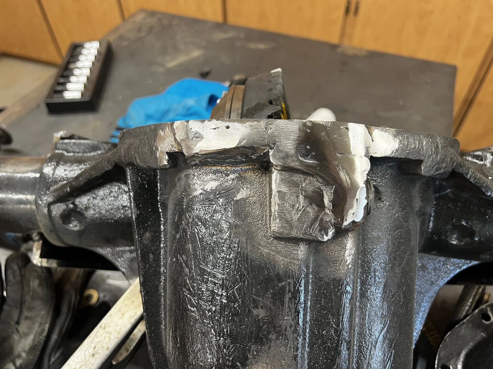

Grind it smooth ish. It doesnāt have to look perfect, itās going to get drug over rocks anyways.
No more lip!
Did you cut the notches parallel to the bottom of the housing?

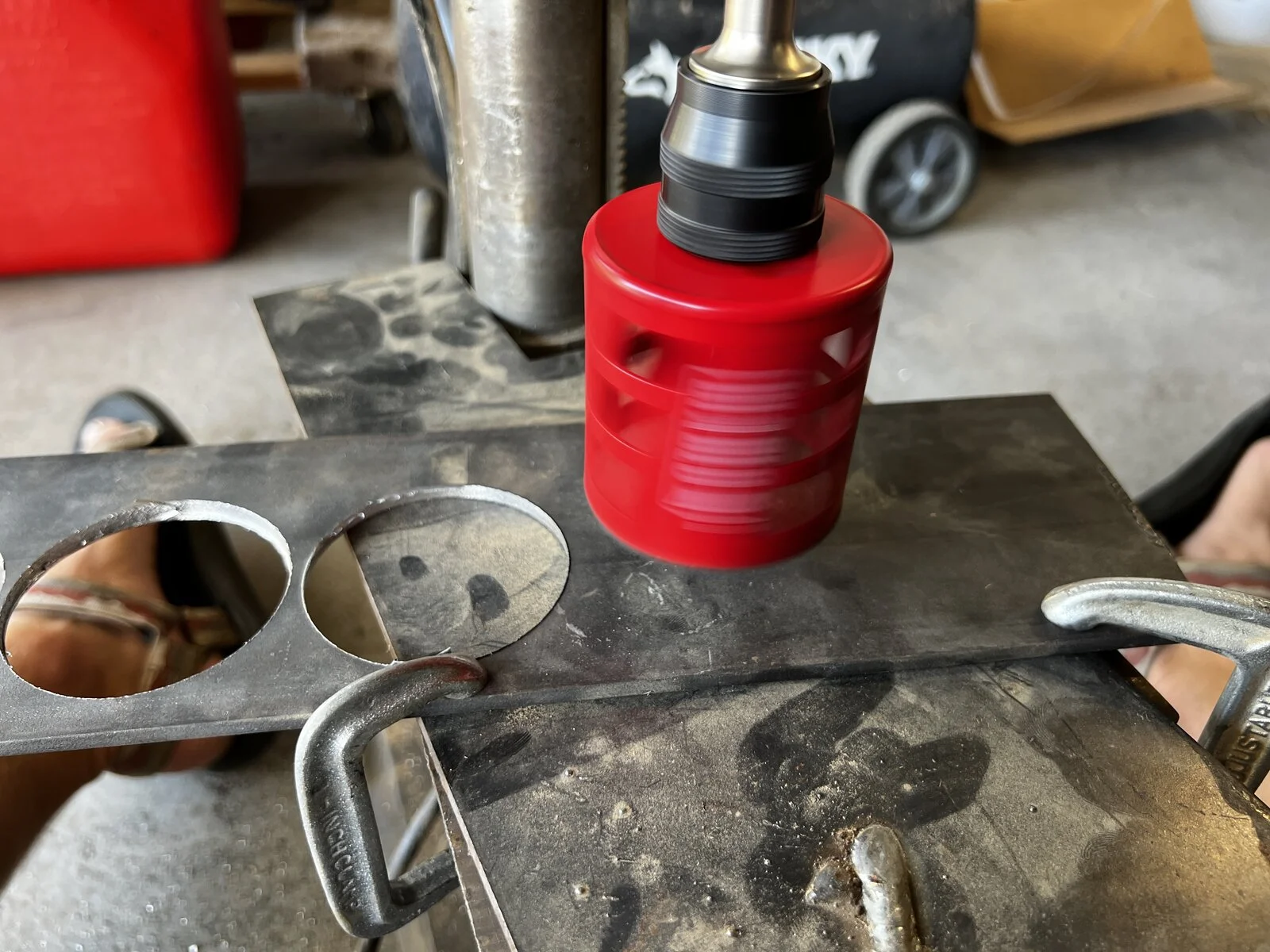

What size are you going with?

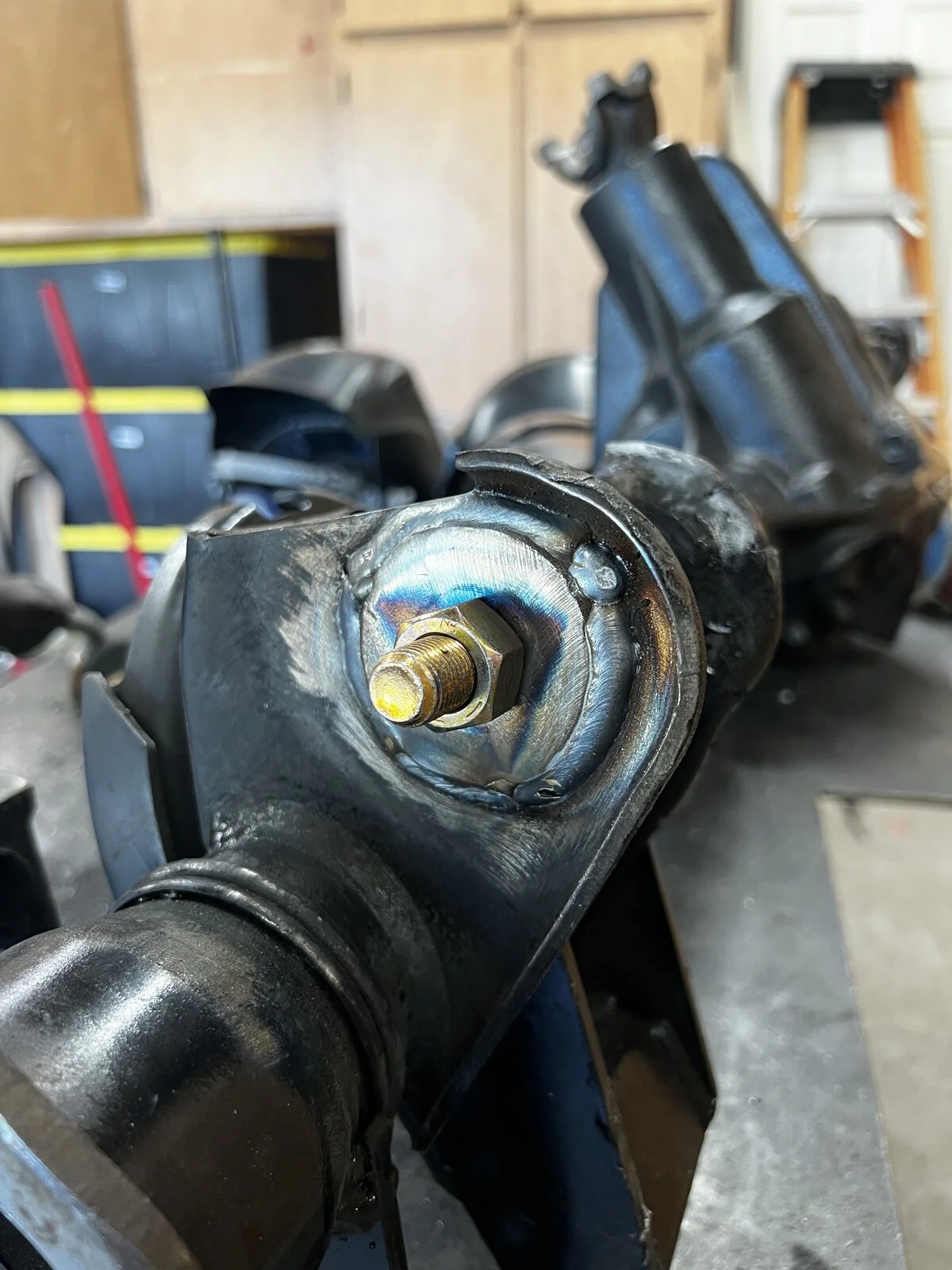

These lower control arm brackets get bent to shit so I am preventatively welding on my home made washers to add some strength.
Next up Iāll trim the flange to the weld.
Are those aftermarket brackets?
