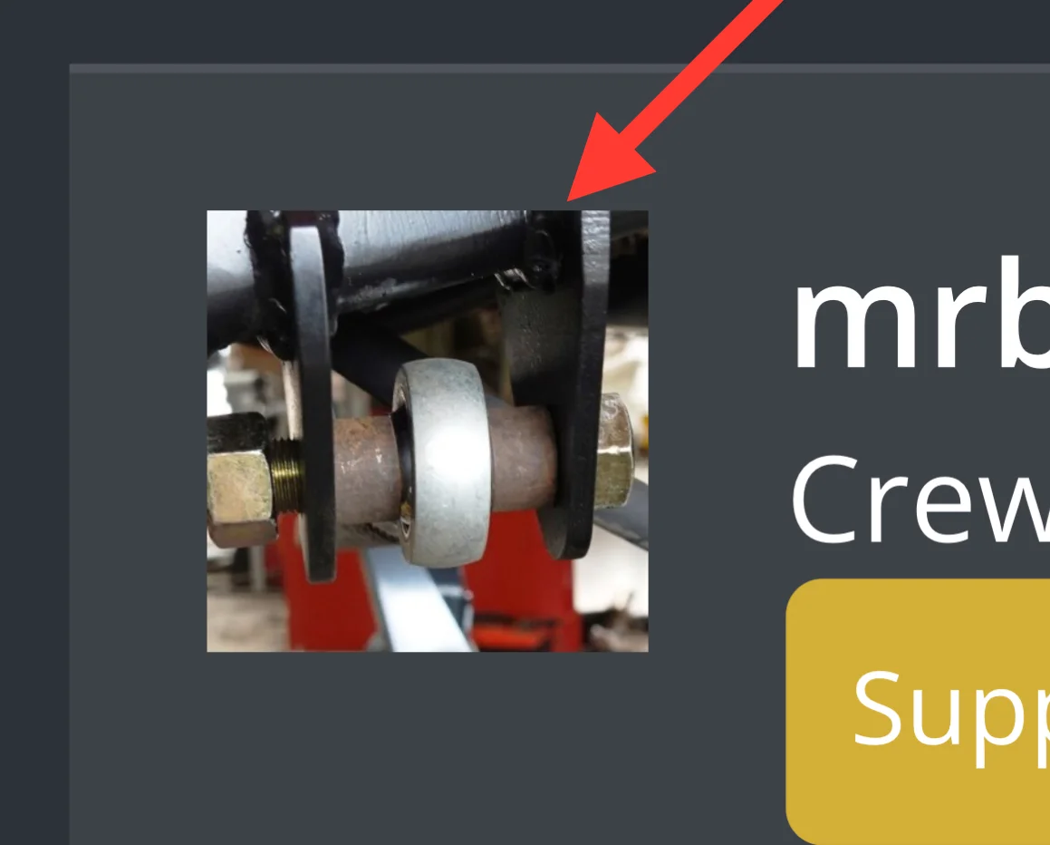

On this topic and your recent design thread, I’ve been wondering about your current avatar. Is that a frame side front track bar mount? If so, that seems stronger/more durable than stock. Using a fully captured heim joint in that orientation makes more sense to me for that purpose.
Reactions: Tob and Apparition
It won't work with a bent trackbar very easily. That one is straight.
