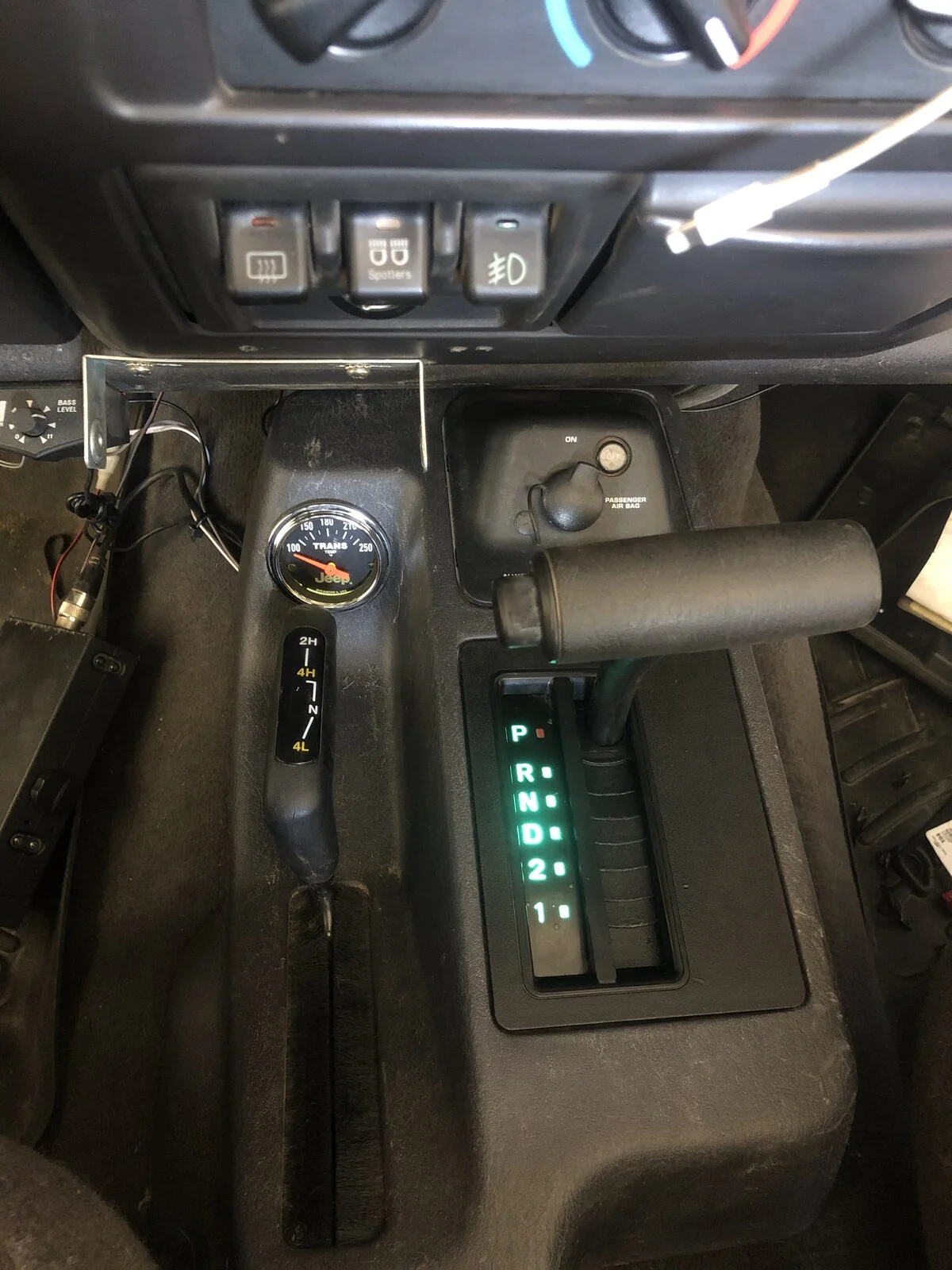

Funny how after all that hard work the most satisfying part is putting the shift bezel on and looking at your new auto shifter

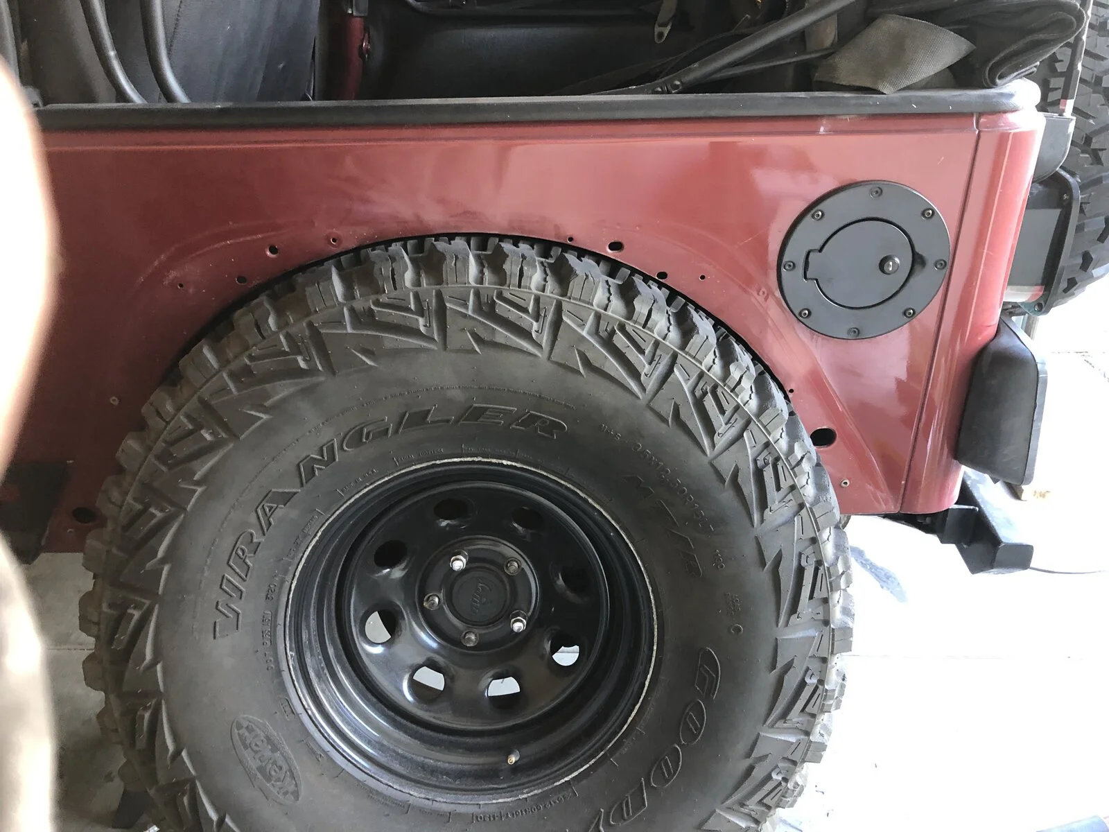

Spent the day today cycling the rear suspension and cutting the rear wheel well to fit my tires. I don’t know how anyone fits 35s without trimming the wheel well. The good news here is that with my old control arms I was losing 1.5” of downtravel during articulation. With the new Savvy arms I’m at full travel, yay! And this gives you an idea of how junky rough country arms are. I was only getting 2.5” of downtravel during articulation when the other side was at full stuff before the joints maxed out.
