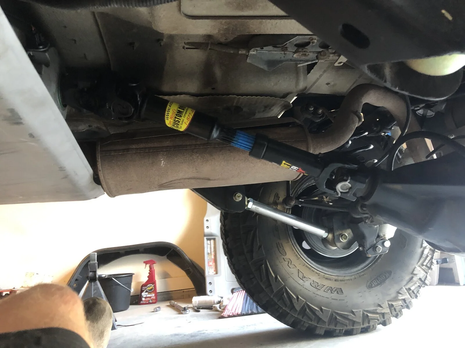

Busy day today! Got the rear shaft back from TW
