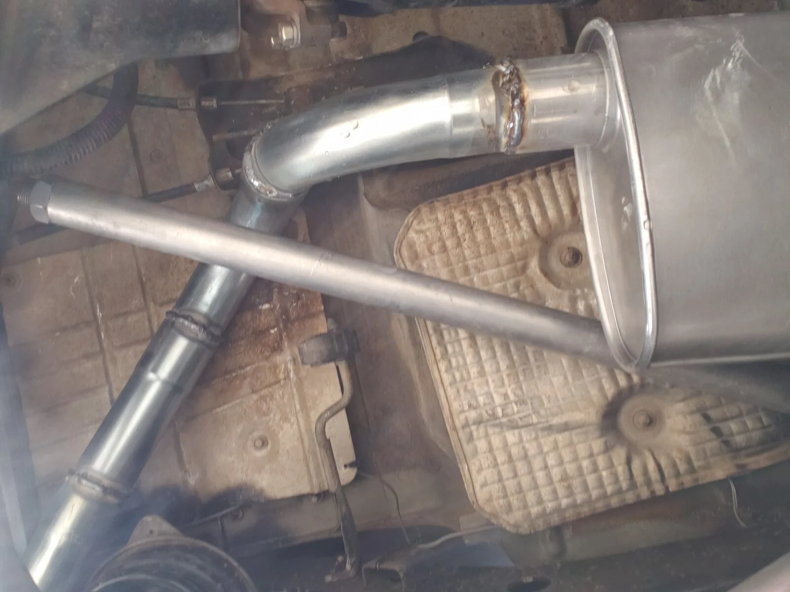

We'll see how far I get this weekend. I have a trip planned for the weekend after mother's day (leaving the 13th). I want to have some de-bug time before I go too...I'm to the "big stuff" point. My dash is mostly installed, and I need to put in the fuel tank, re-install sliders, bolt the seats in, put the driver's fender on, hood, cowl panel, tailgate, tire carrier, check bumpstops because I added 3/4" spacers and new shocks, etc. I probably should make a list. Exhaust mods would be a killer...I have a bolt on turn down though....
I did mine with 4 90* bends and a few straight bits. Wasn't too bad but I do suck at welding the paper thin material. I lost about 7 decibels getting it to come out the rear.
I did mine with 4 90* bends and a few straight bits. Wasn't too bad but I do suck at welding the paper thin material. I lost about 7 decibels getting it to come out the rear. View attachment 245973View attachment 245974
I think mine should be a bit simpler, because I'm sticking with the short arms. I'm gonna need to do something soon anyway...mine is REALLY close to the passenger rear shock. I'm hoping it will be ok though. Its another time suck fab project that I don't need.

The stock and walker 54227 tail pipes normally do not have Clearance issues. I've replace a bunch of careless exhaust shop jobs with the walker 54227 pipe to fix clearance issues.
I've used a banks as well without any issues. If you take it to an exhaust shop, yank the springs out and force them to build around the parts. Otherwise, they'll hurriedly run pipe right through pinch points without giving it any thought.
