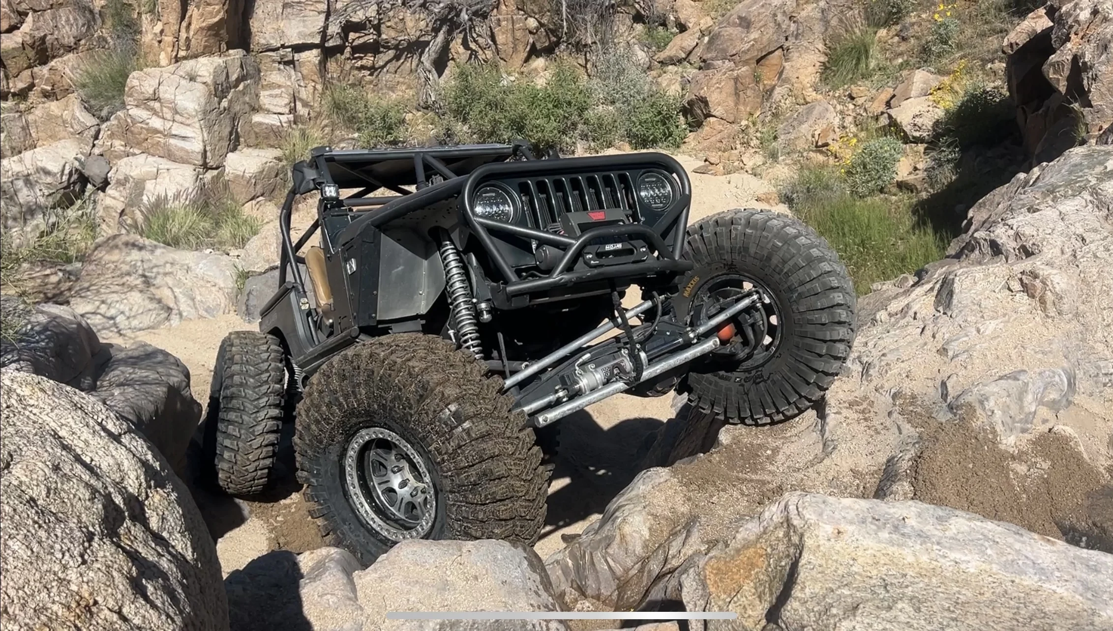

That trail was gnarly. This is the only pic I took. We pretty much just drove and didn’t stop much unless someone got stuck.
Definitely the upper limit of my capabilities. The rocks are so big I was just catching diffs and mounts and you name it everywhere. 35s got swallowed up like it was nothing. The big rigs definitely did better than I did. However, I did hit nail really hard spots that I didn’t get last time I wheeled here and I’m proud of that. The gatekeeper was dug out a lot and I still made it which was cool.

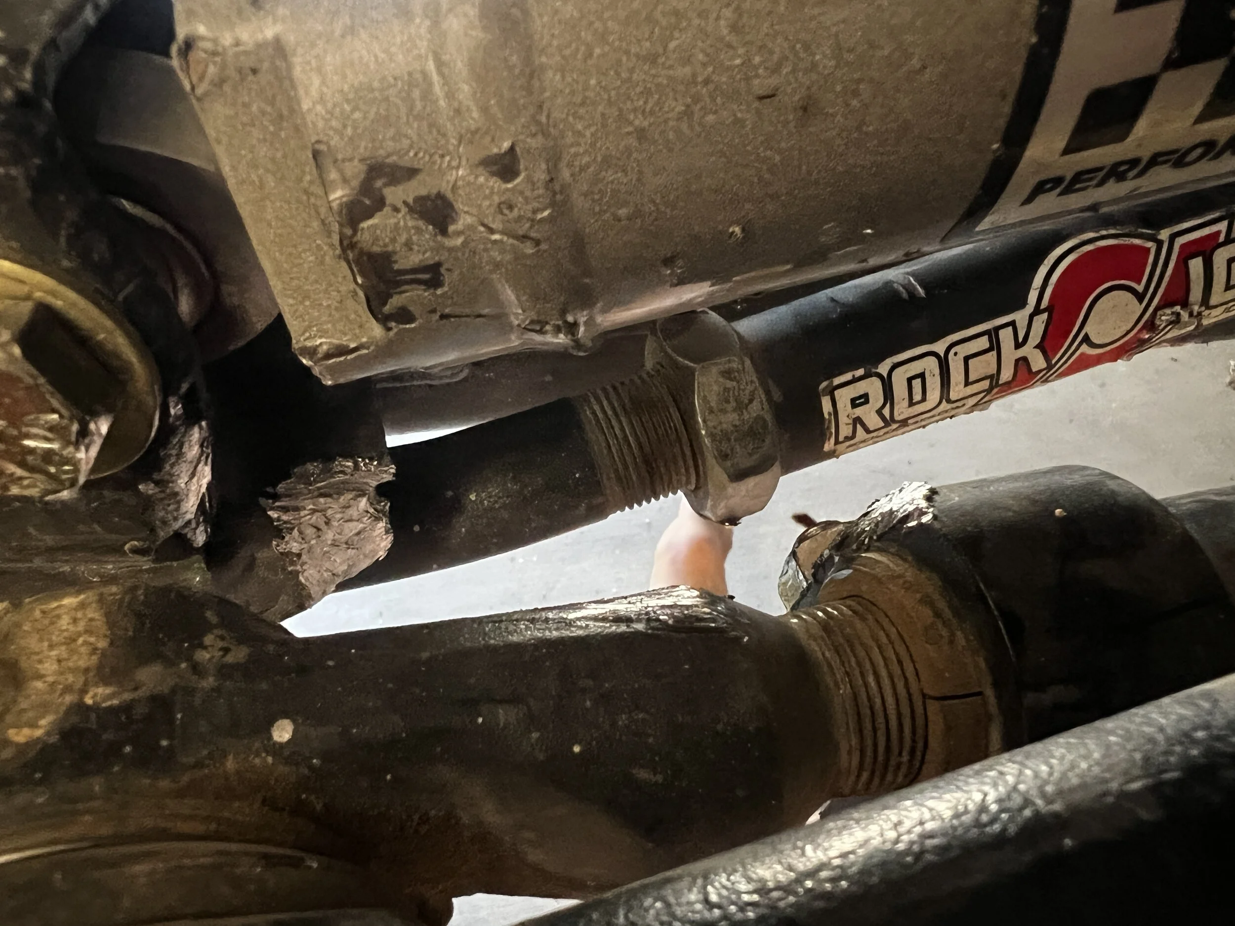

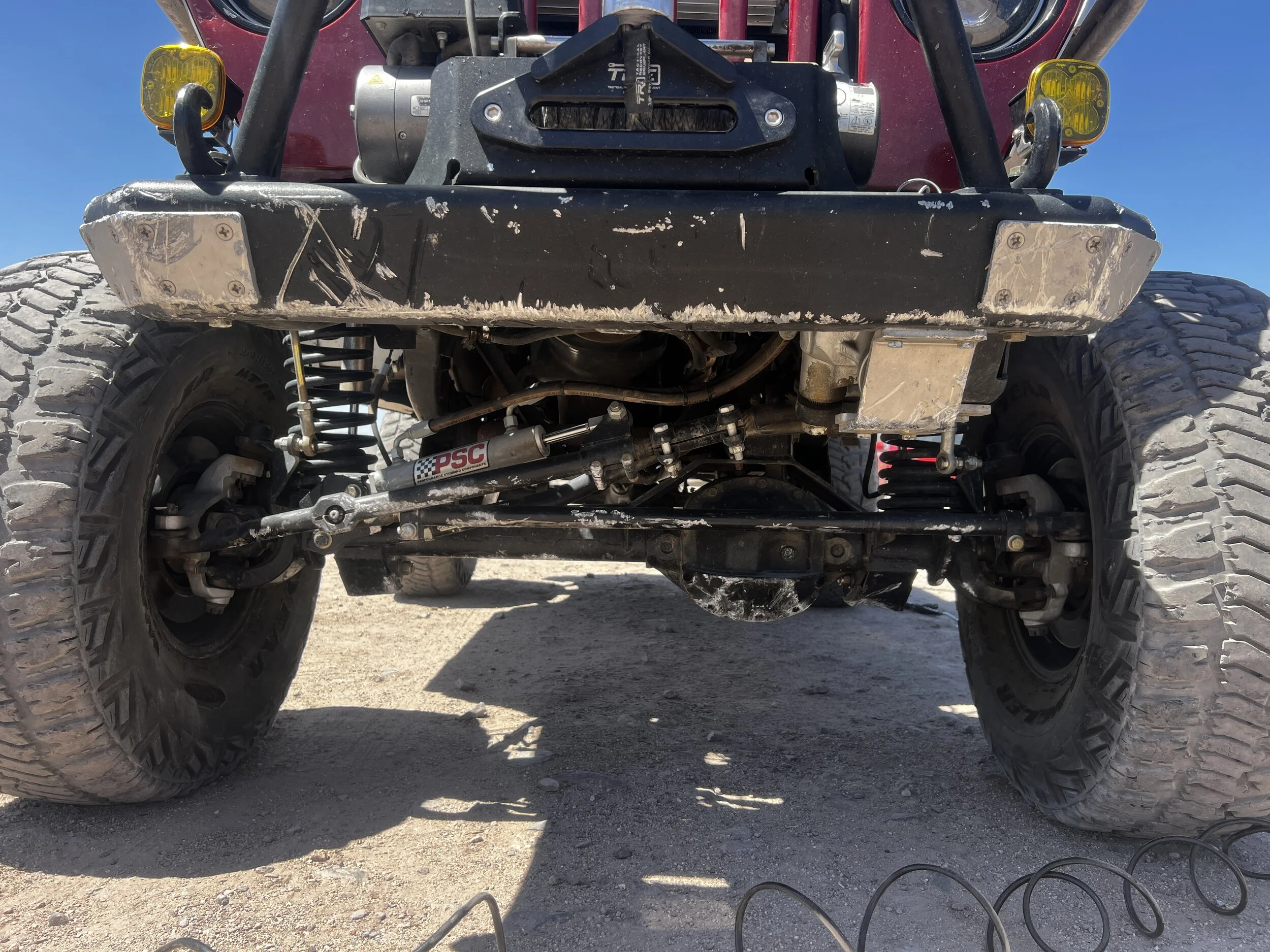

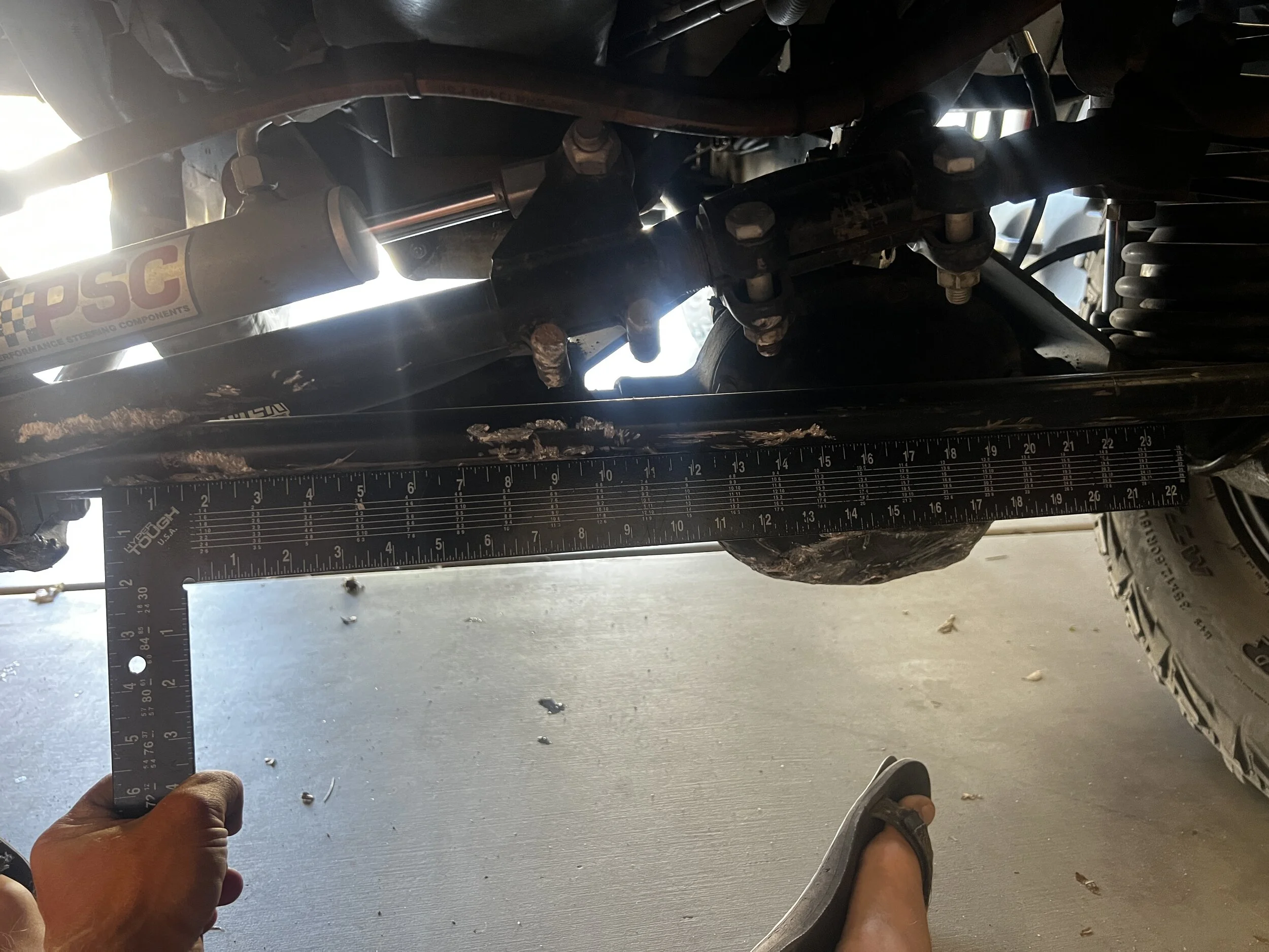

Despite my best efforts using the tie rod as a battering ram, I couldn’t bend it. Kudos to @mrblaine and his kickass tie rod. I did bend the drag link in though and now the tie rod clamp is rubbing everything.

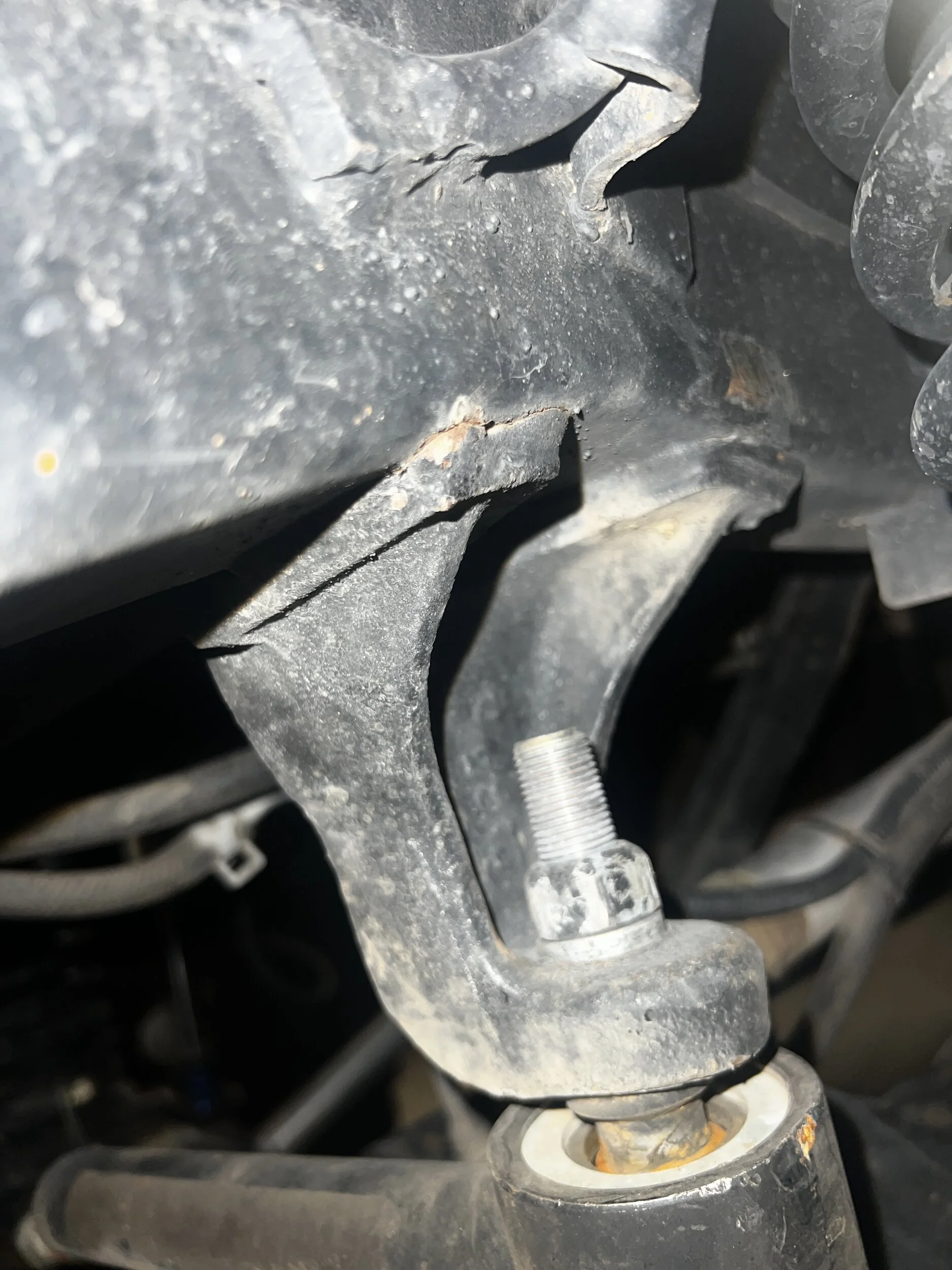

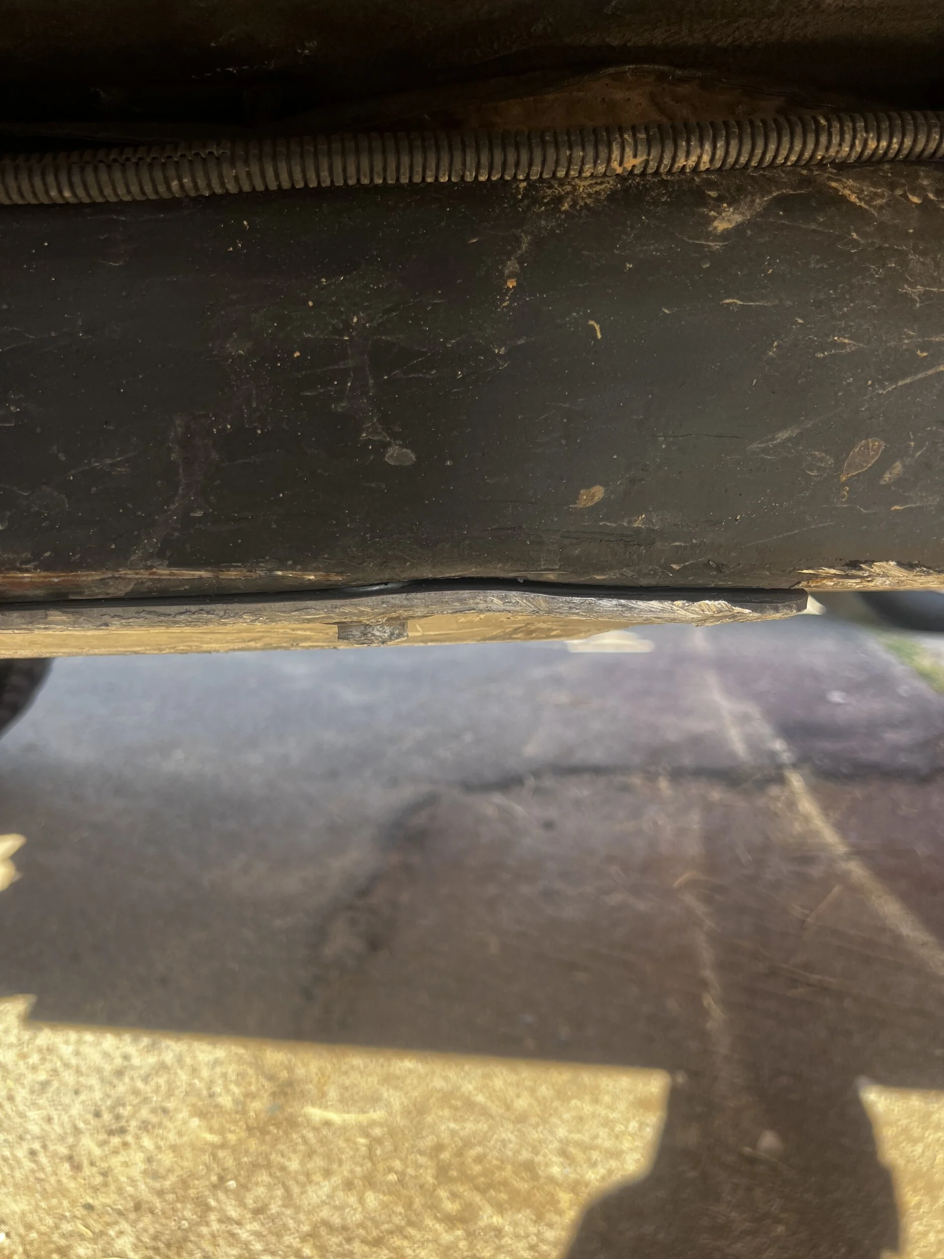

So that leaves me with a drag link that needs rebending and a trackbar mount that is cracking the frame. All signs seem to be pointing towards a mini front stretch soon.

I added a cross member to that track bar mount, it runs from the track bar mount to the frame on the other side. Of course I am in full support of the stretch, but in the meantime you could just weld that crack and then run a cross member.
