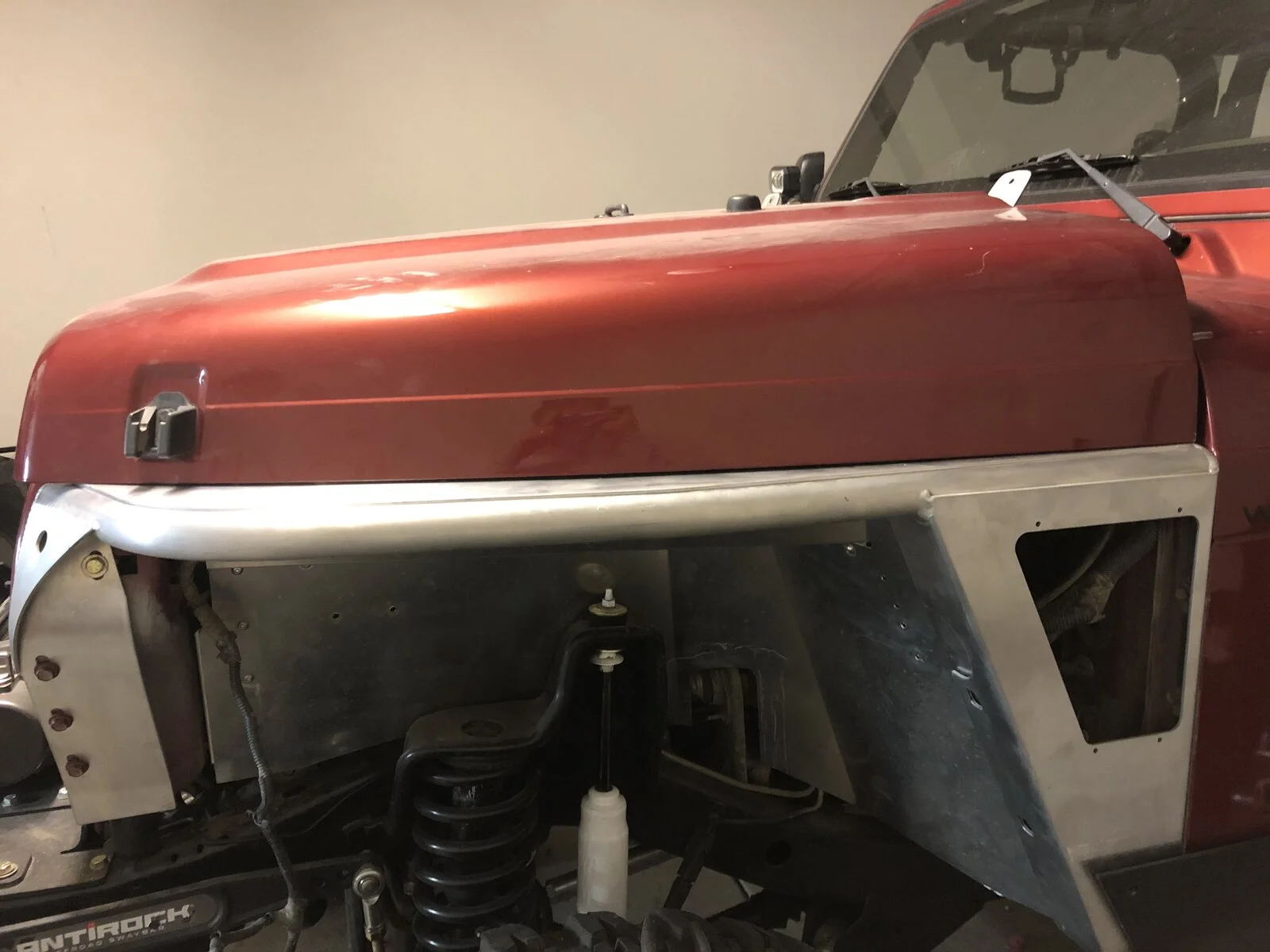

i don't believe i could use GR's fenders because they don't sit high enough for what i cut. my old fenders are raised to the top of the headlamps and most pics show the aftermarket fenders fall just a bit short of that point. but yours appear to be up there high.
the front bolts are in the bottom of the slots, any chance they are holding the front at high spot? can't tell if those are tightened down or not.
or if the fender is really bowed, lay the fender upside down spanned between 2 horses and apply some pressure see if it'll flatten out.
TBH the hood appears to have the worst of it, cutting the hoods is the trickiest part.
i took a big cut off the hood a 1/4" short of where i thought i needed to be. then i put the hood on the rig sitting on the fenders and i lay a pencil on the fender (a #2 pencil diameter gives a nice gap). then slide the pencil down the fender marking the hood. trim and repeat until it's right.
Sweet. I agree I think the hood is causing most of it The grill mounting points are up as high as they can go without touching the front of the hood. Good idea on the saw horses. I’ll try that today. First I want to lay my stock hood on the fenders and just see how it lays with a dead straight cut. Then I’ll do what you said and cut it 1/4” low and trim as needed. To be honest I was considering cutting and using my stock hood anyways because this primed one still needs a lot of prep before it could be painted

Good news guys! My stock hood lays almost perfectly flat on the fender. I think we can make this look good!
had i been a better body worker, i'da loved to keep an extra 1/2" of meat and roll it in giving the hood some structure back along that edge. but IDK how to do it.

Has anyone seen any ideas out there for making a jig for the angle grinder to make a straight cut on the hood? Maybe a block that goes under the hood so you can make a straight cut at a set height? Edit: this won’t work I don’t think the angle of the cut will be the same as the bottom of the hood unless you set the fender at the exact angle as stock.
Ask @tworley , maybe he has some hints here.
