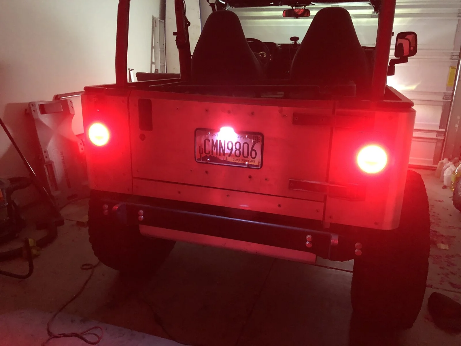

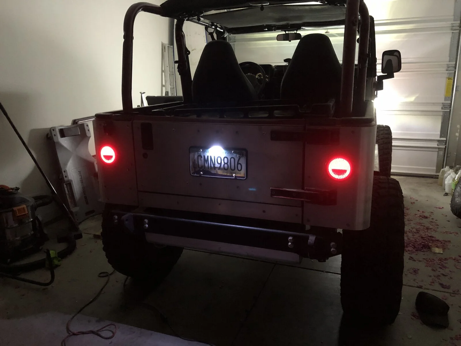

Since I have some time today I will wire in my license plate light too and be legal for the trip.

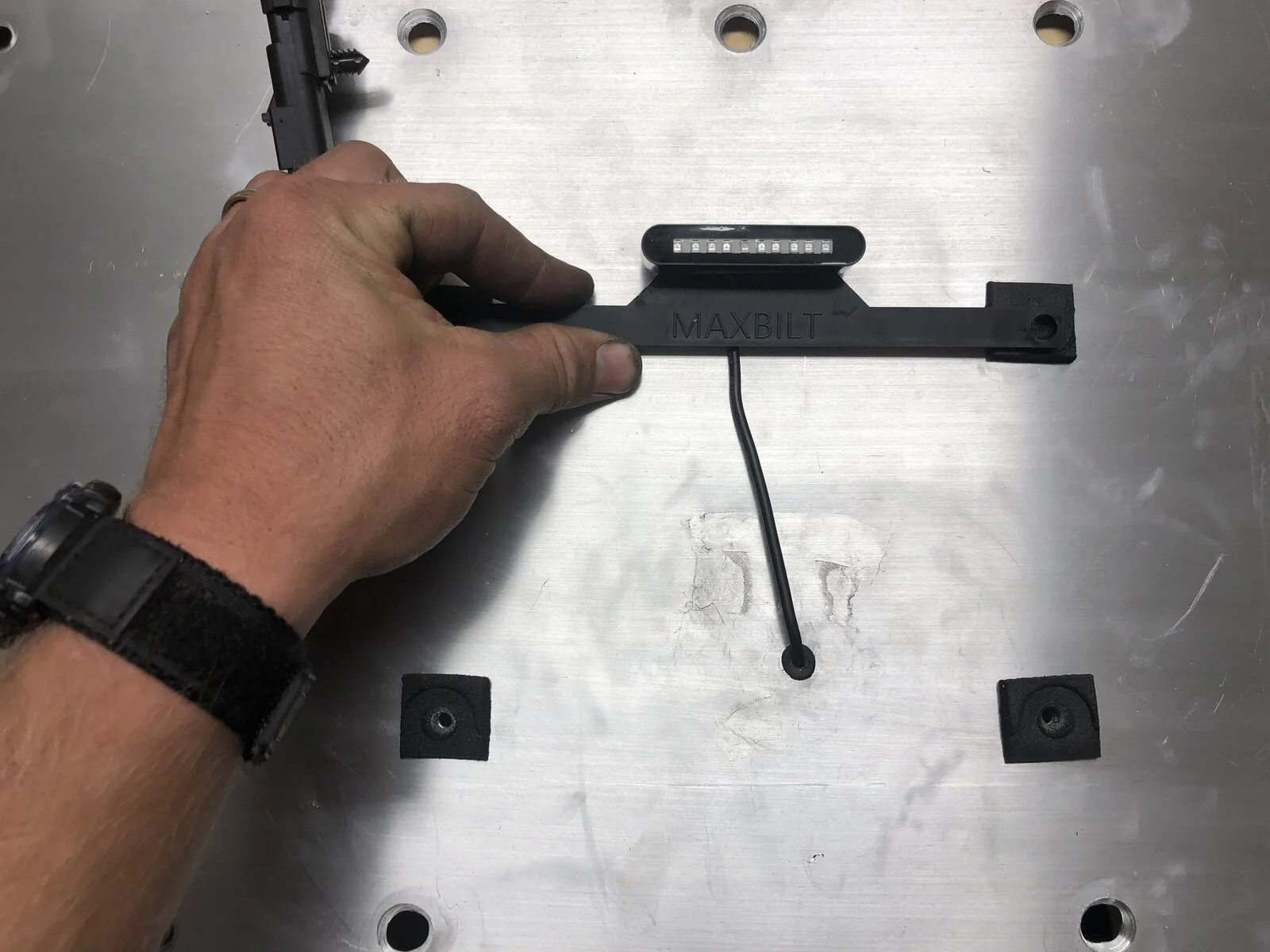

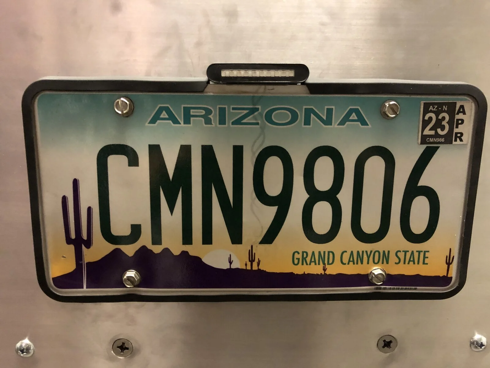

Added a maxbilt license plate light/3rd brake light to my tailgate

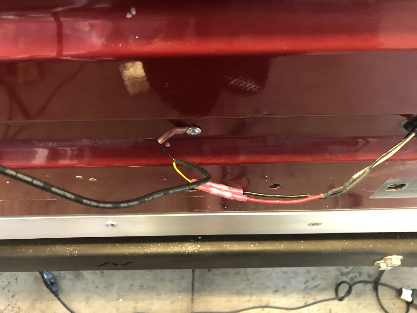

Pretty simple to add the license plate light. I converted the tailgate ground wire to running light by tapping it into the passenger taillight running light. The white/orange is brake light power and the black is ground. Splice the black into the black/yellow running light wire.
Then add ground behind the tailgate armor
Then drill a hole in the armor right where the cavity is in the tailgate underneath the plate area. Run a rubber grommet and good to go!

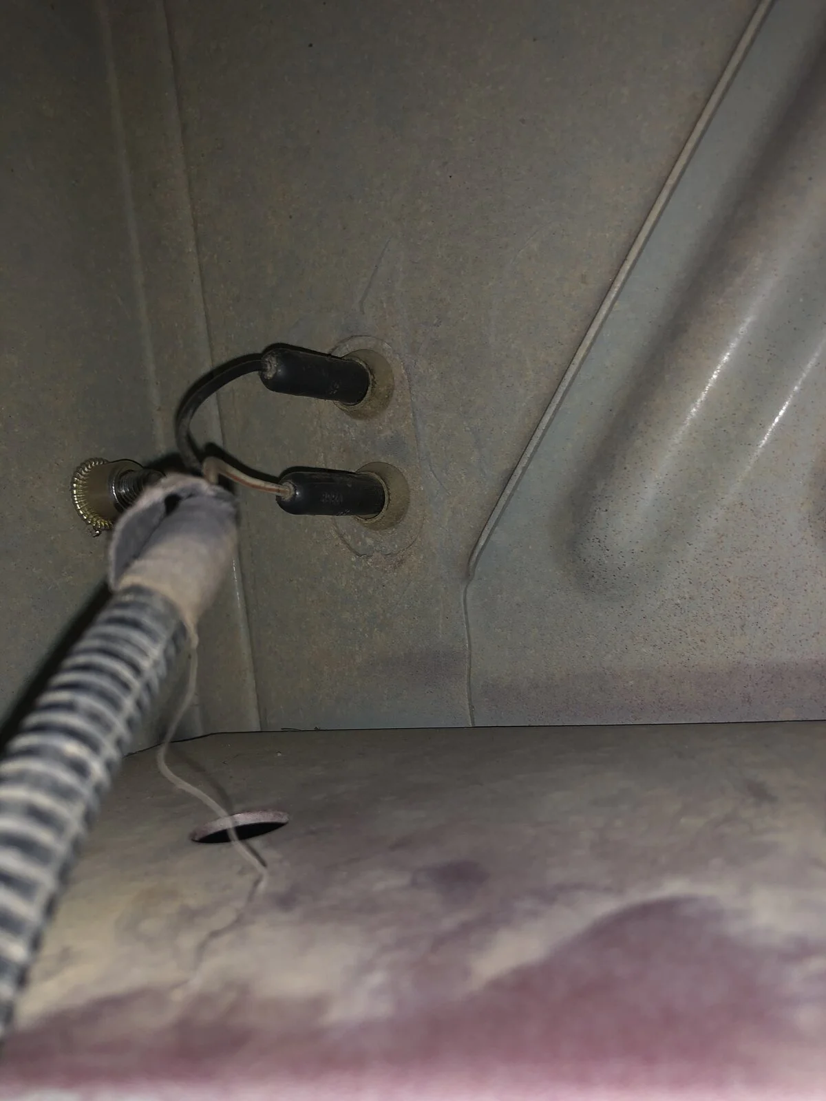

Very clever. I was going to buy a three pin door switch to do the same. Still might, but your idea is a good one too!
https://www.summitracing.com/parts/dak-mgs-3
Reactions: JMT and starkey480
That’s pretty slick! Didn’t think of changing that.
That is a @mrblaine trick. I think he uses them for clients that want power windows and locks...and still want to remove their doors. I knew the TJ only had two pins for the brake light...so I thought I'd change it. But.. grounding through the tailgate and using those two pins for two seperate circuits is very clever. My only concern would be the slight clearance in the hinge pins necessary for the tailgate to actually move and having a bad ground condition rear up.
We've been using the tailgate as a ground for a long time. It has not been an issue yet. Certainly far easier than messing with the 3rd brake light contacts and changing that whole mess out.
