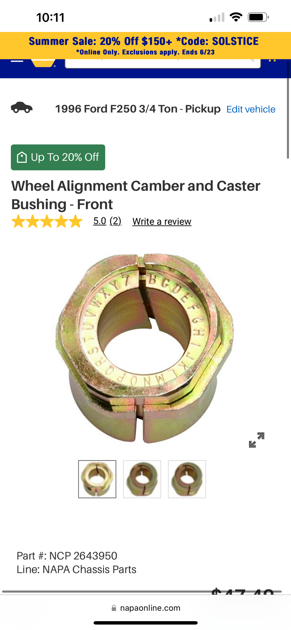

I’m pretty sure the bushings are 2 piece adjustable. They were already in there. Maybe I’ll take it to someone that specializes in I beams and can just put the right bushings in to give me the desired caster

This is what they look like
This is what they look likeView attachment 536081

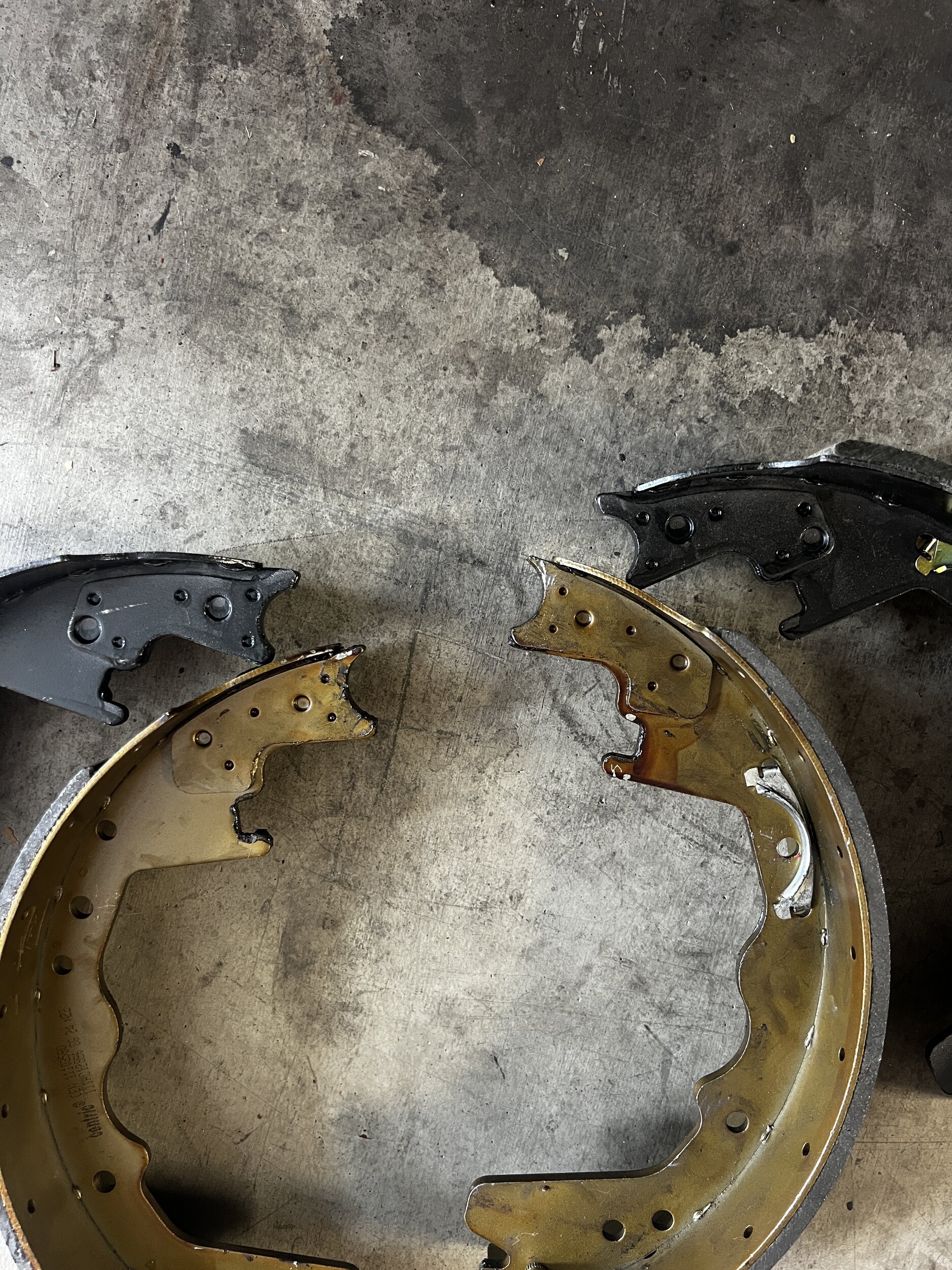

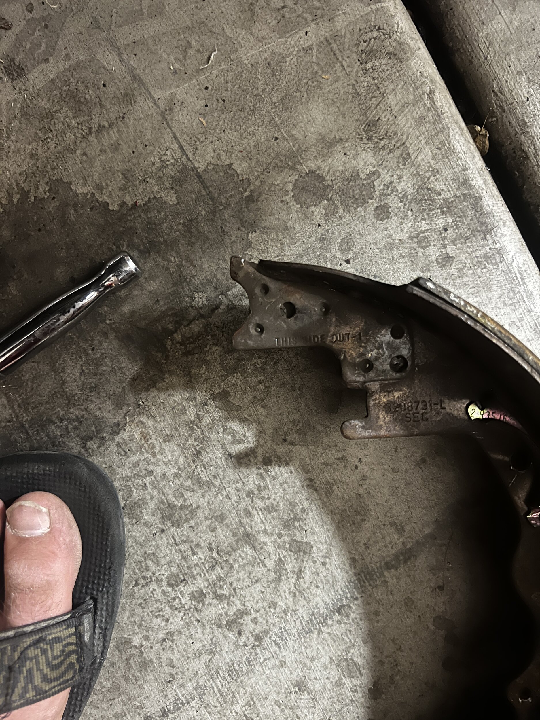

Here’s the old shoe. Note the upper left hand corner of the shoe there is a pronounced vertical face. The parking brake lever pushes against that to push the shoes out.

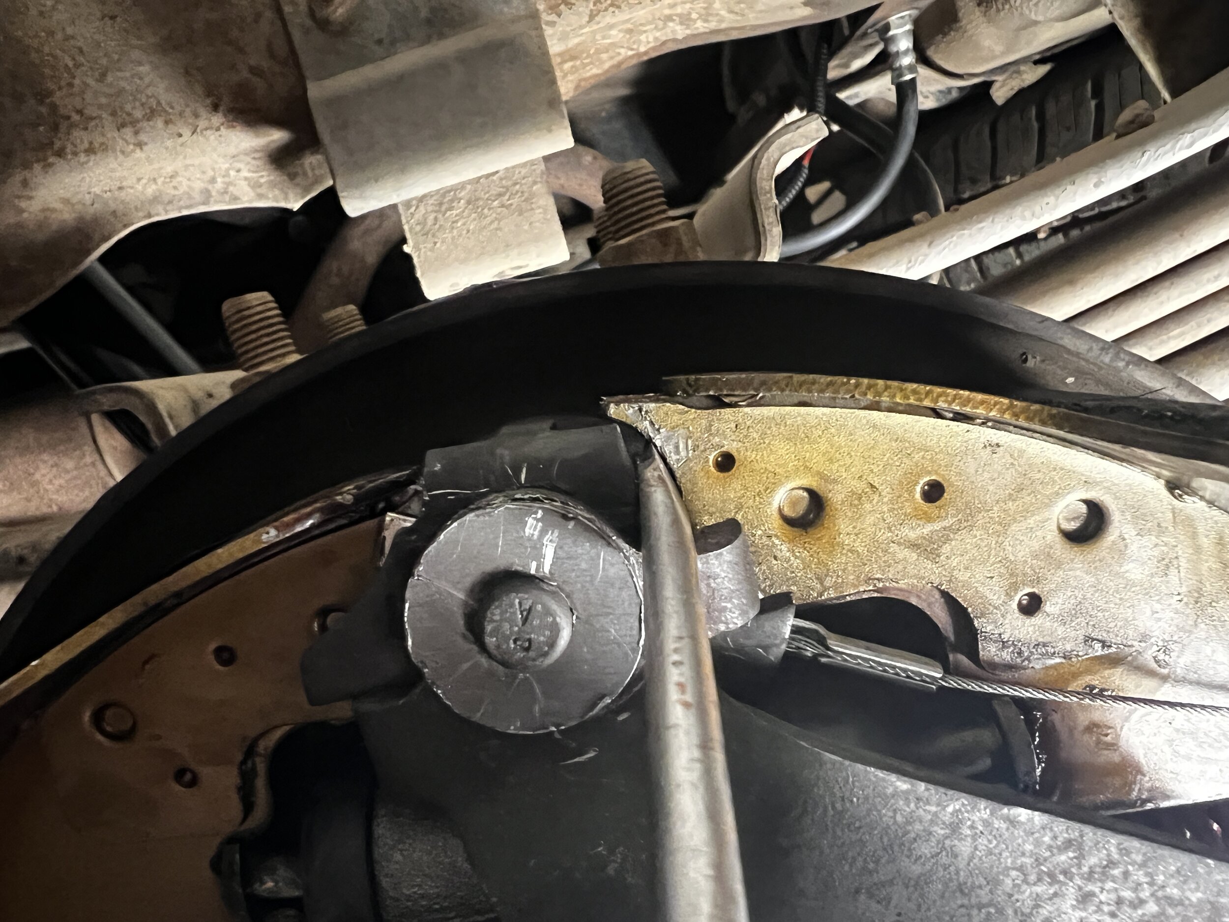

Here’s the shoe they gave me. I have a screw driver prying it up and out but there is no face on it so the parking brake lever just slides right over it

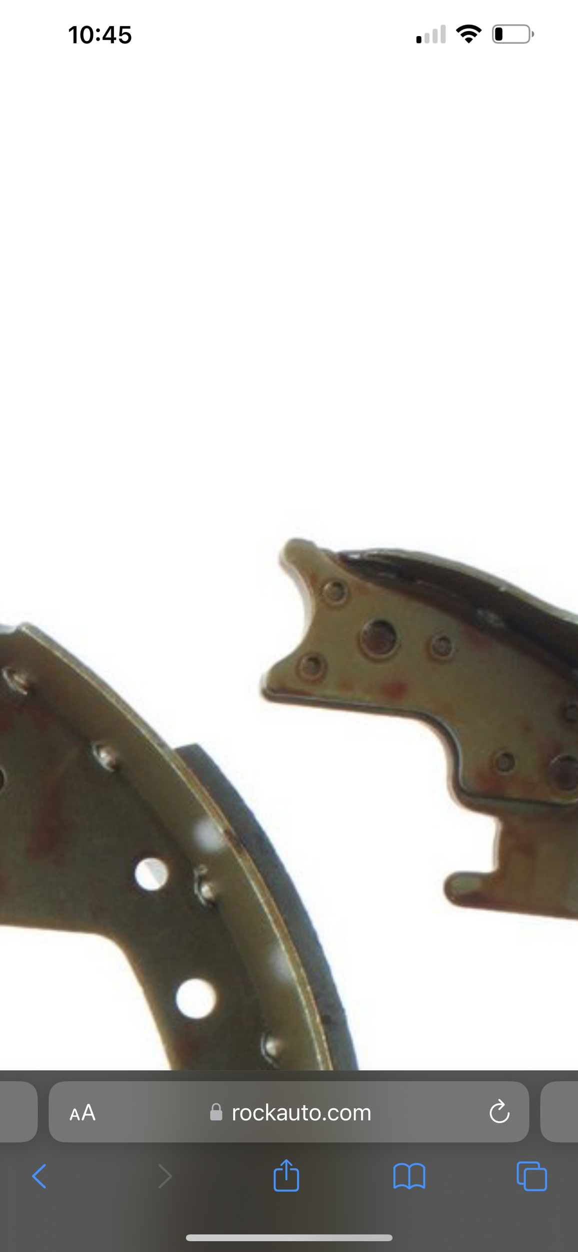

Am I being a tard and missing something? Or did rockauto send me the wrong shoes? The left shoe has the correct part number on it so idk if it’s just a manufacturing error? I looked up a picture of the part number I ordered and it looks like it should. If I have to do all this shit again I’m buying some drum brake tools because that shit sucked

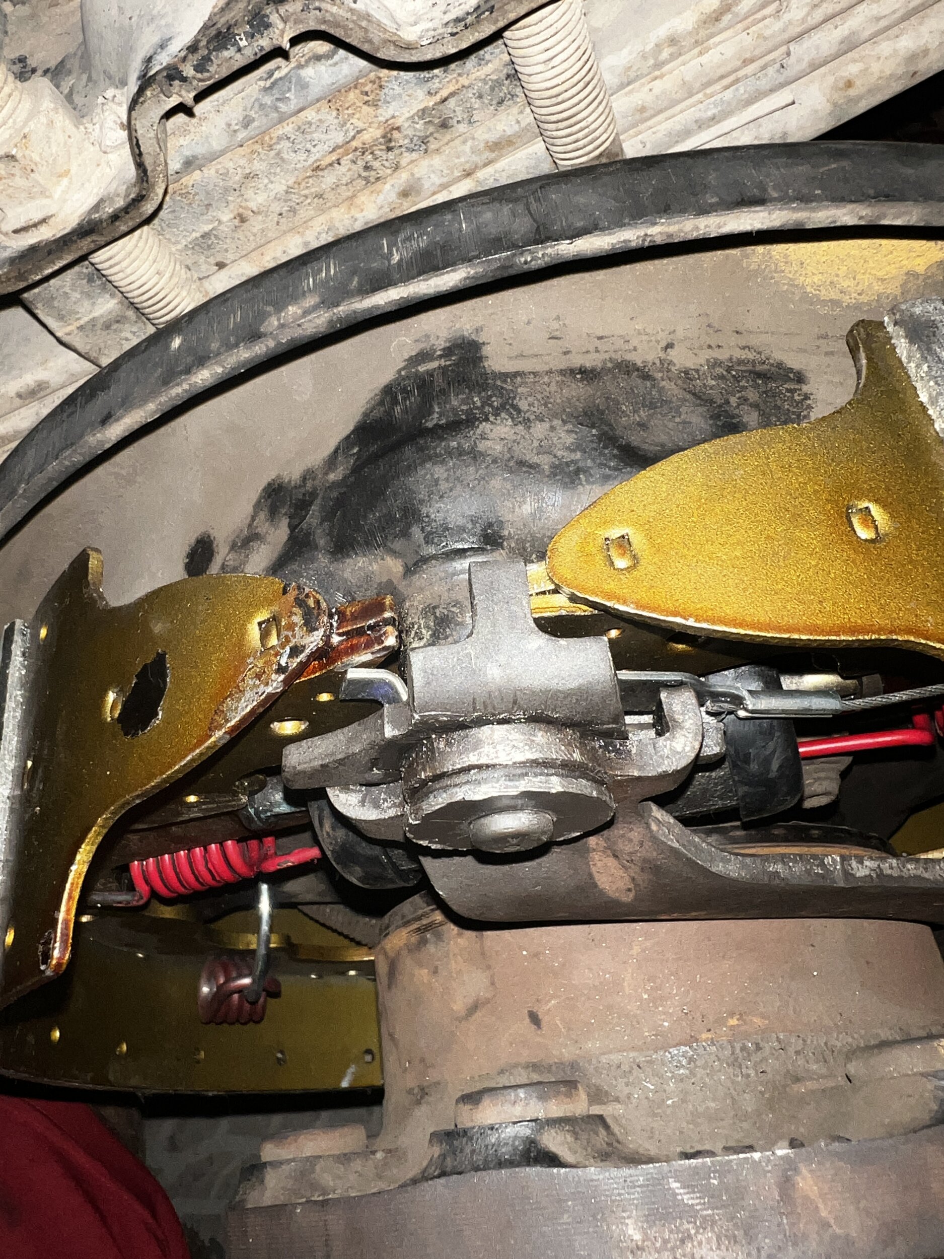

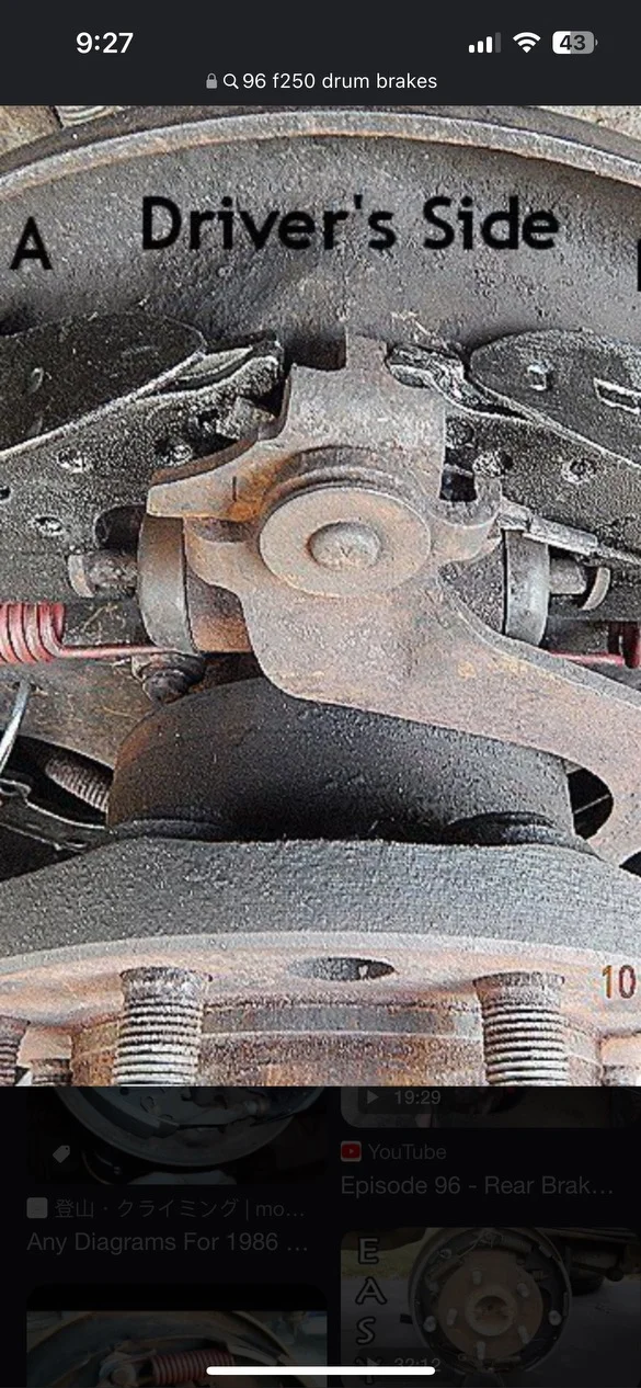

Here’s how it is supposed to look
But it slides right over the shoe
First things first with drums.
-ALWAYS do one side at a time so you have a reference on the other side when putting parts back on.parts can look similar at first glance but need to be put back exactly how they were to function correctly.
- most drum systems have a front and rear shoe with different sizes of friction material and or shoe shapes. Are yours mixed up?
-yes your new chinese parts can absolutely be wrong. Use your old parts as a reference.
For occational work on drums a few screwdrivers and vise grips to pull the springs into place are ok. No need to buy a bunch of tools. Be very sure you aren't overtightening the adjusters for the drums.

Looks like the shoes just didn’t have the square head on them so I got sent bad shoes somehow. Just got some Napa shoes that have the right square head.

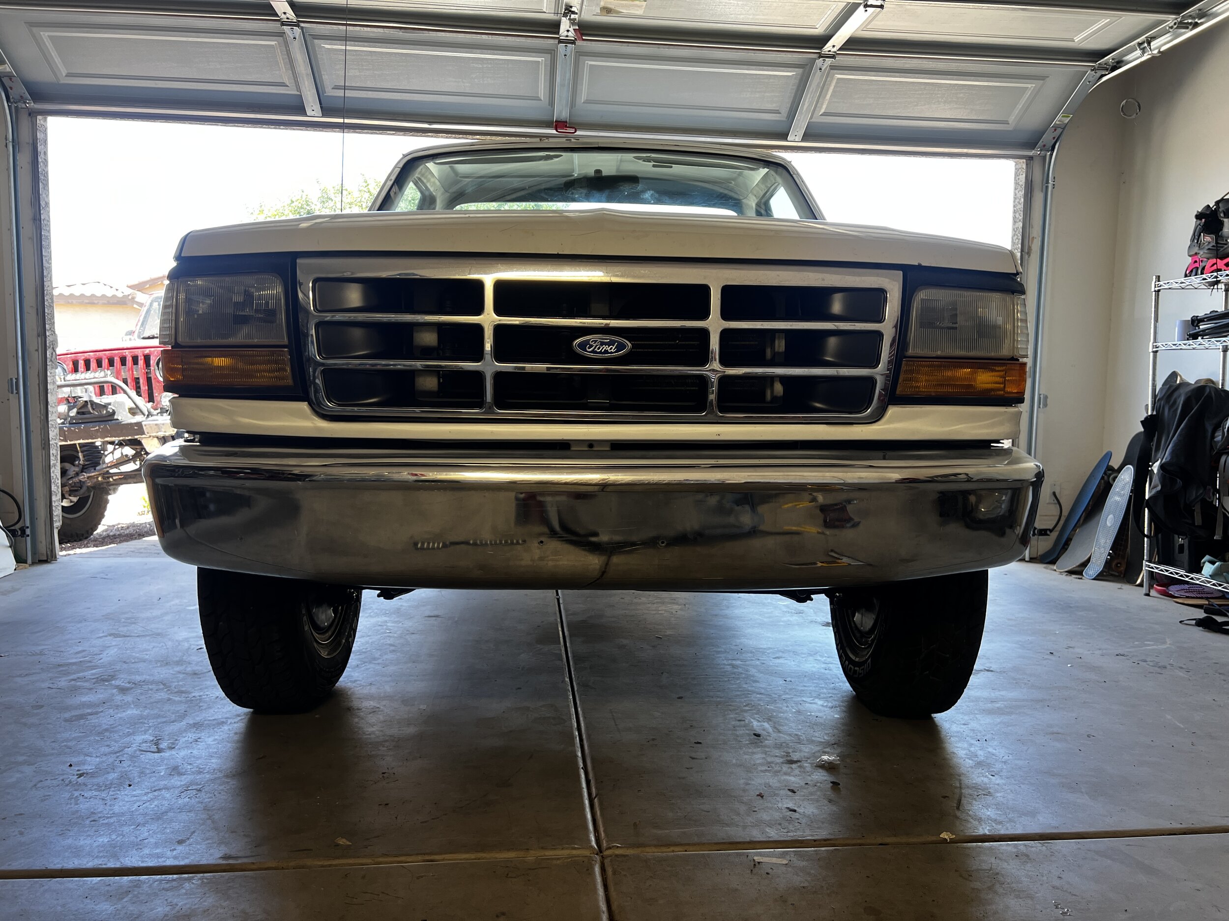

Got the cracked windshield replaced and chrome headlight bezels on. Bumper is raised up and square. She’s looking like a new truck now.

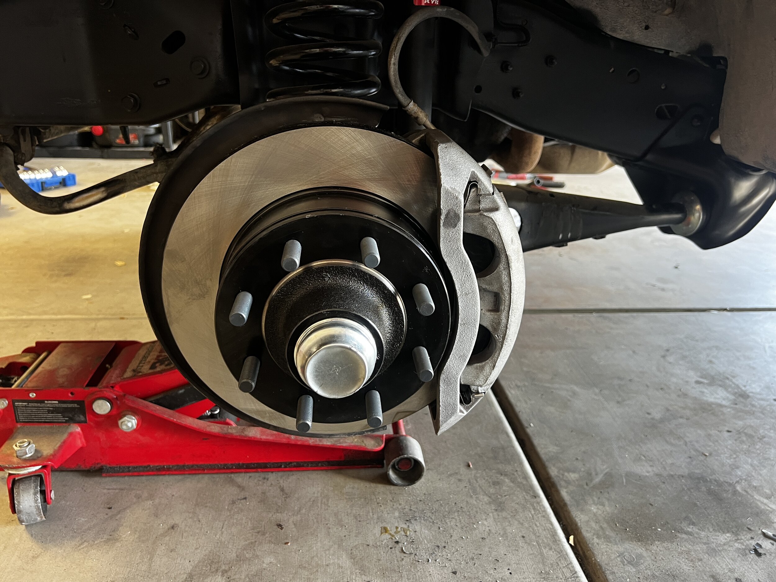

New pads and rotors.

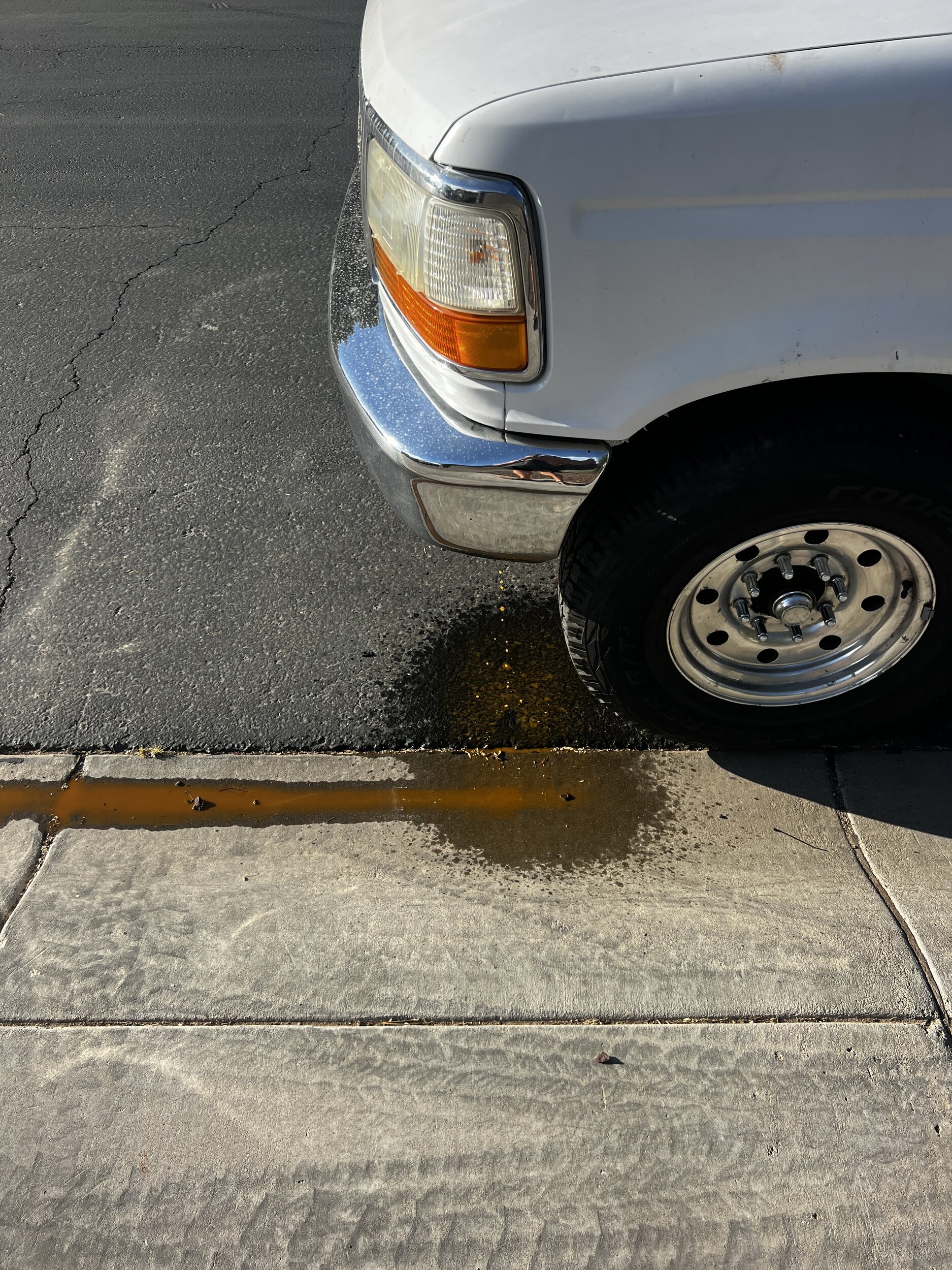

I go to break in the pads and then come home. I’m talking to my wife and look out the window and see the truck leaking coolant everywhere.
I’m really hoping it’s just a bad radiator cap. I picked up a cap and some coolant since the coolant looks terrible. And here I thought I was all done with doing car projects in the heat for a while 😅
