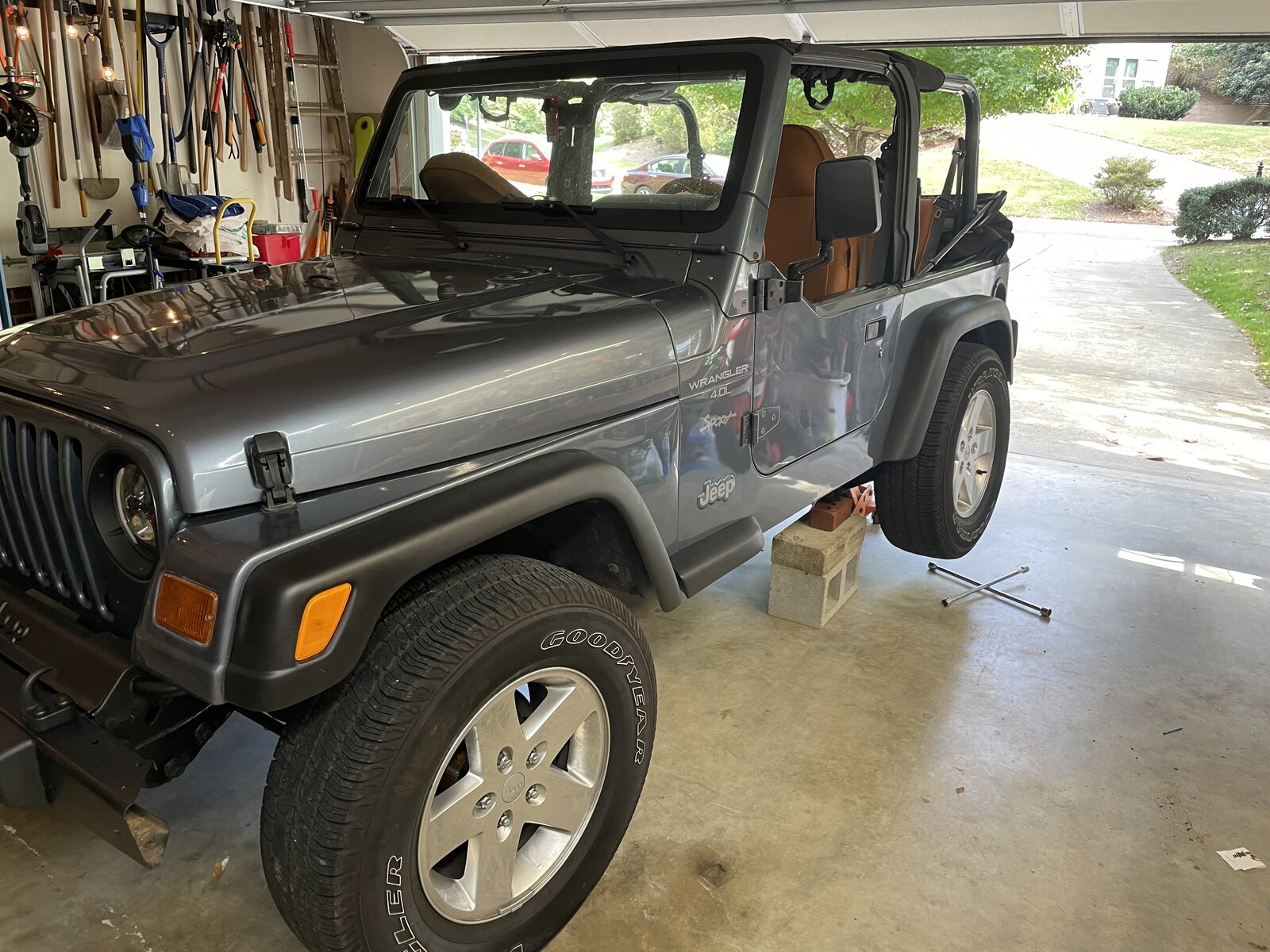

After months of research and test driving, I finally ended up with a ‘98 gunmetal pearl tj sport with a manual transmission and 6cyl engine. Currently has no lift and 31s
Here it is the day after I bought it:
Since then, I’ve done just a bunch of small cosmetic changes, new headlights and new seat covers are the main things. Here it is what it looks like today:

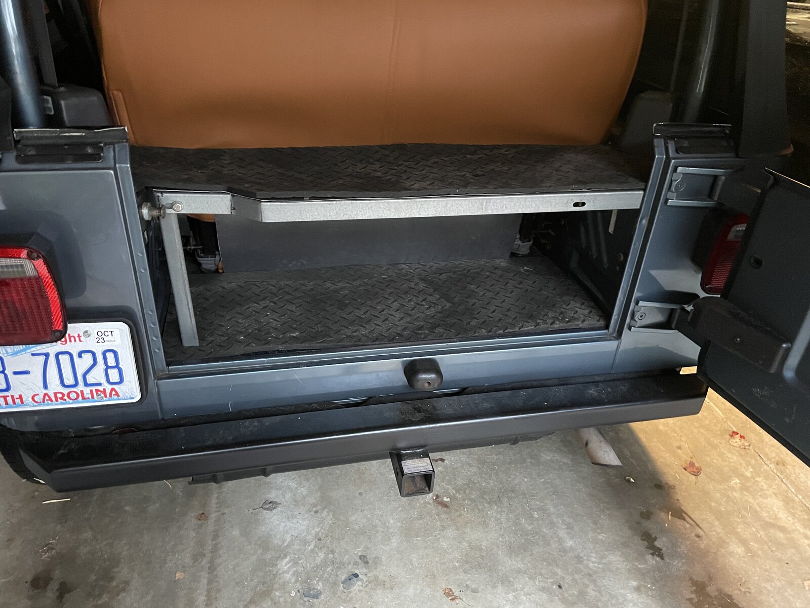

And just yesterday I did my first project ever involving metal stuff (I’m a woodworker) and built a small compartment in the back that I can actually lock if I have the top off. Not at all fancy or perfect, but good enough for me, and I’m really happy with it.

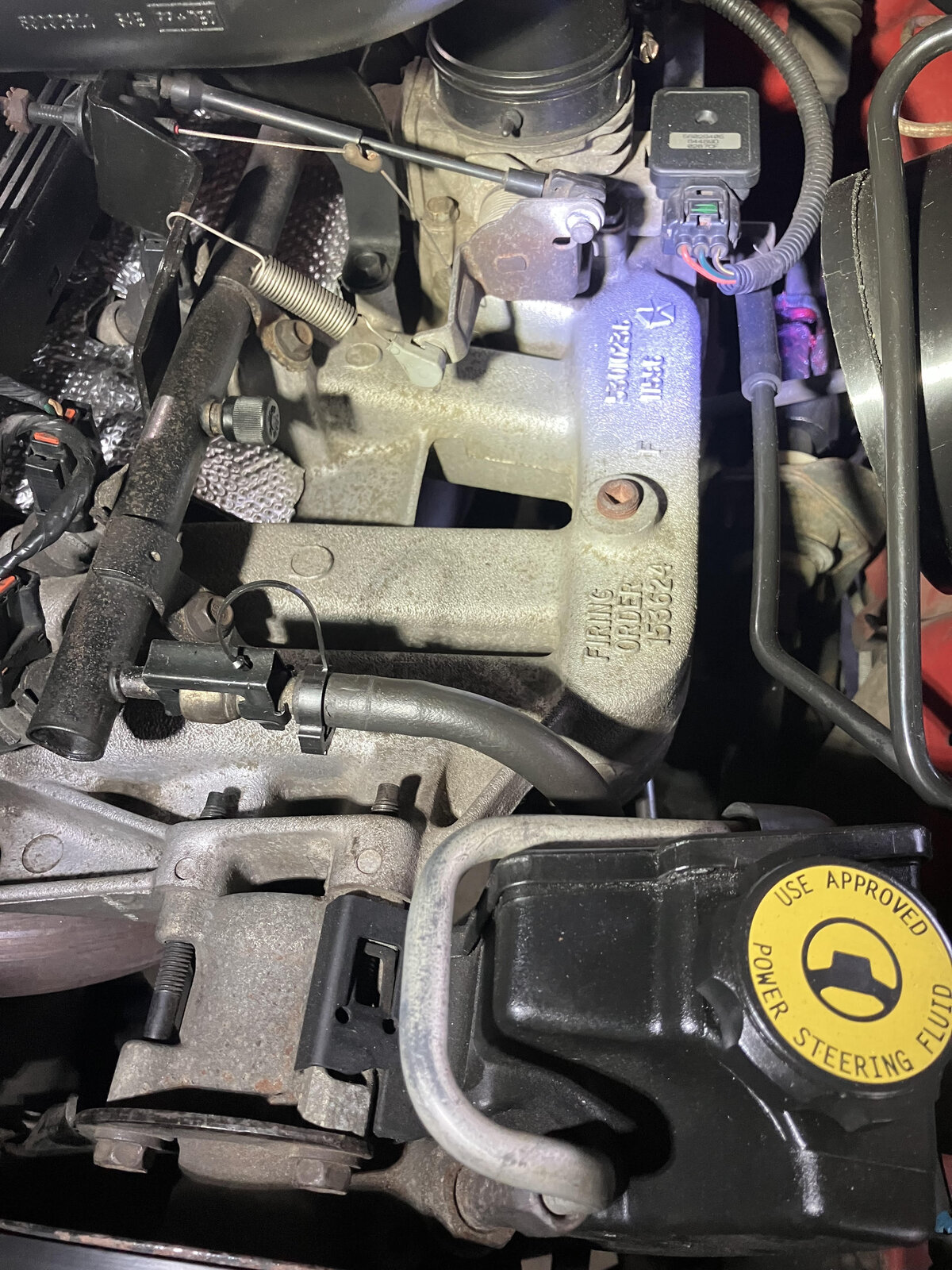

Other thing is I have no idea what this thingy is:
What is it? It looks like something is supposed to be attached to it? Also, that tube just to the left of it that has a white cap, it is completely cut off at the bottom and capped at the top, so it doesn’t go anywhere, is that supposed to be something important that I should fix?

You can tighten the bolts that secure your oil pan which should hopefully stop the leak. Look up the torque specs however, as they aren't cranked down too hard. The white cap on the tube that is completely cut off should be your differential breather hose and should be attached to the top of the front diff. Re-attach it...

Oil pan gasket seal it looks like. Also take a look at the timing cover seal and/or the harmonic balancer seal.
EDIT: Not the intake manifold temperature sensor. The IMT is near the firewall. Yours looks to be a vacuum. Though I am skimming the manual to find what exactly. Mine is plugged on my 97 model. I would guess it has something to do with the purge valve

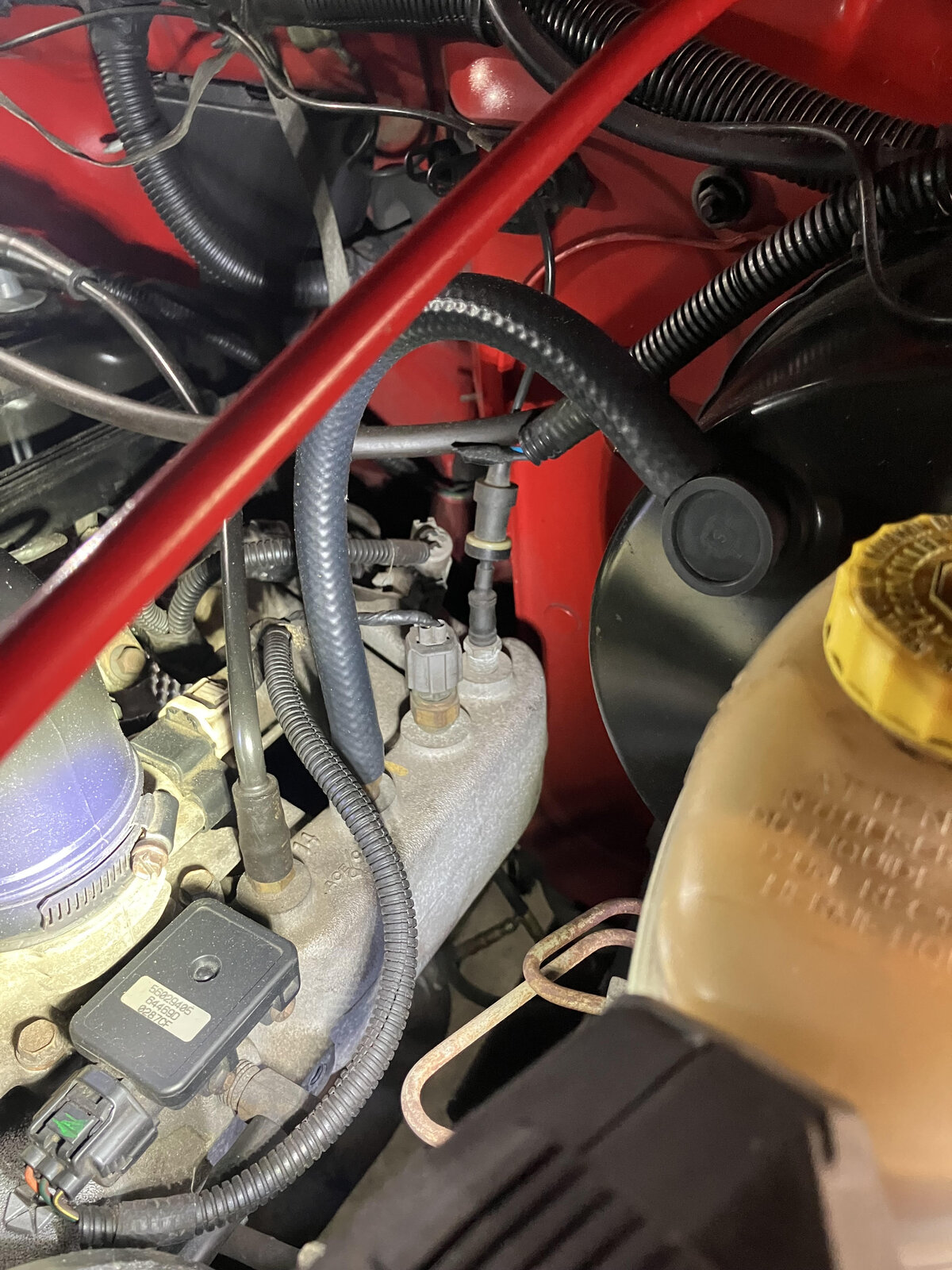

I believe the item in the red circle is where the IAT sensor is located on later TJ models. See pics below:
1997 TJ where port is plugged...
1997 TJ IAT location...
2003 TJ IAT location...
Jeep bounced the location of the IAT around for years. Beginning in 2005, the IAT location moved to the throttle body intake tube. Check your 1998 to see if the IAT is located near the back of the intake between the throttle body and the fire wall. I am not certain of the location for your year.

Maybe a forum member with a 1998 4.0 can chime in, but it looks like from this crappy picture of a 1998 4.0, it has that port capped off. I would assume yours is missing a rubber cap of some sort and that your IAT is located near the rear of your intake between the TB and the firewall.

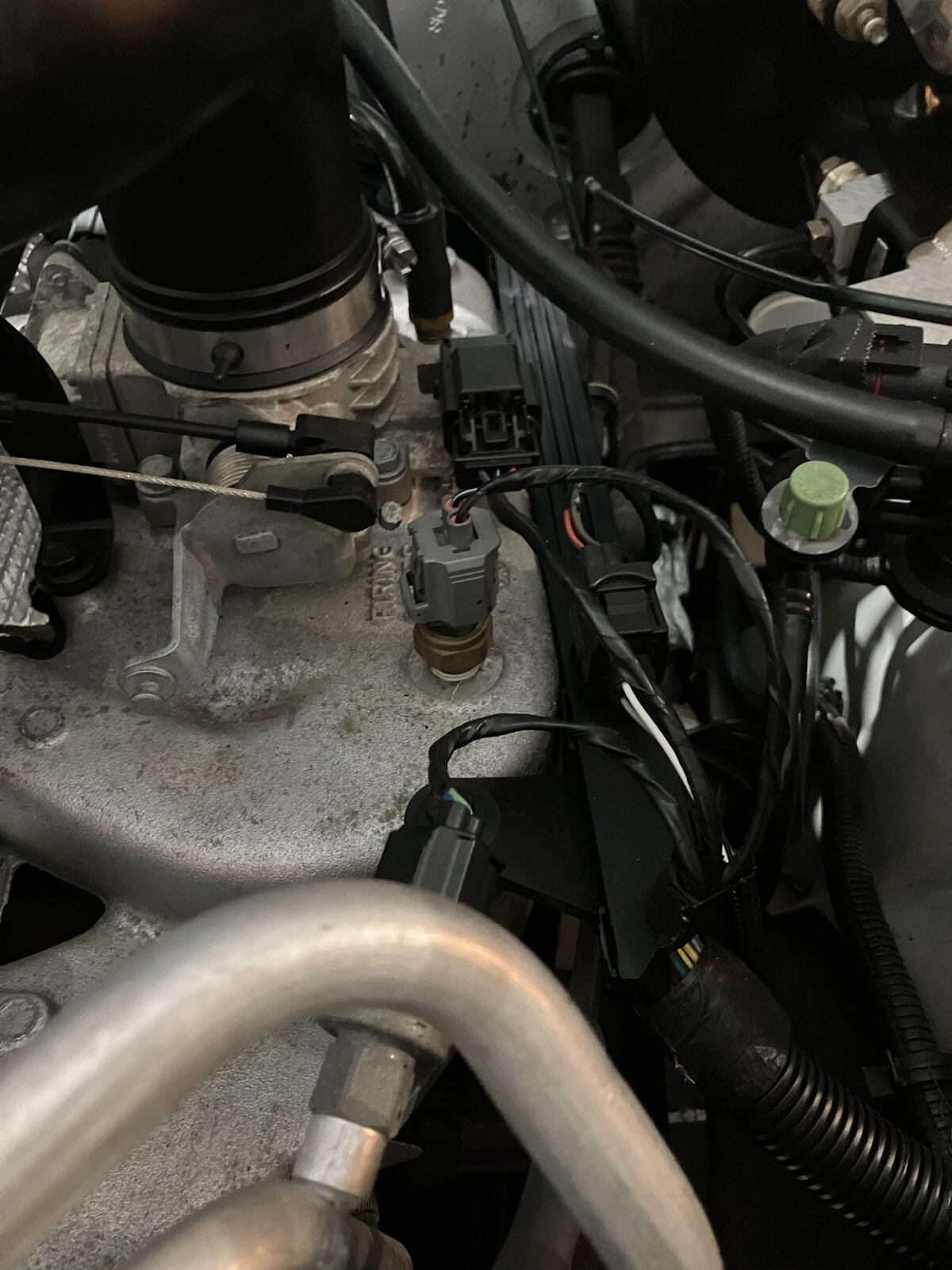

Makes sense--I was seeing all sorts of locations for it when researching. I had posted the 98 location from my manual. Hang on...
