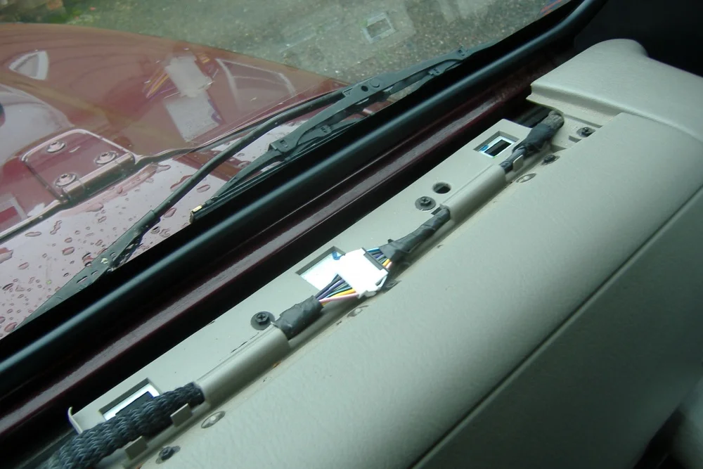

Even if you have the harness under the vent, you will still need the harness that goes up the window to the mirror.
Not sure of the part numbers.
Also, not sure if any mirror other than Mopar is plug-n-play.

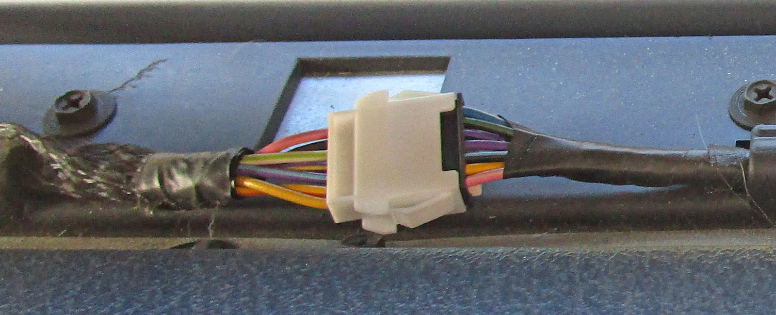

Here's mine (2005). Pin 7 at the bottom. Colors are close to the FSM, but not absolutely perfect.
On the right, the second wire down from the top looks green/gray in this picture, but in another picture it looks black. Must be a reflection of the sky or something.

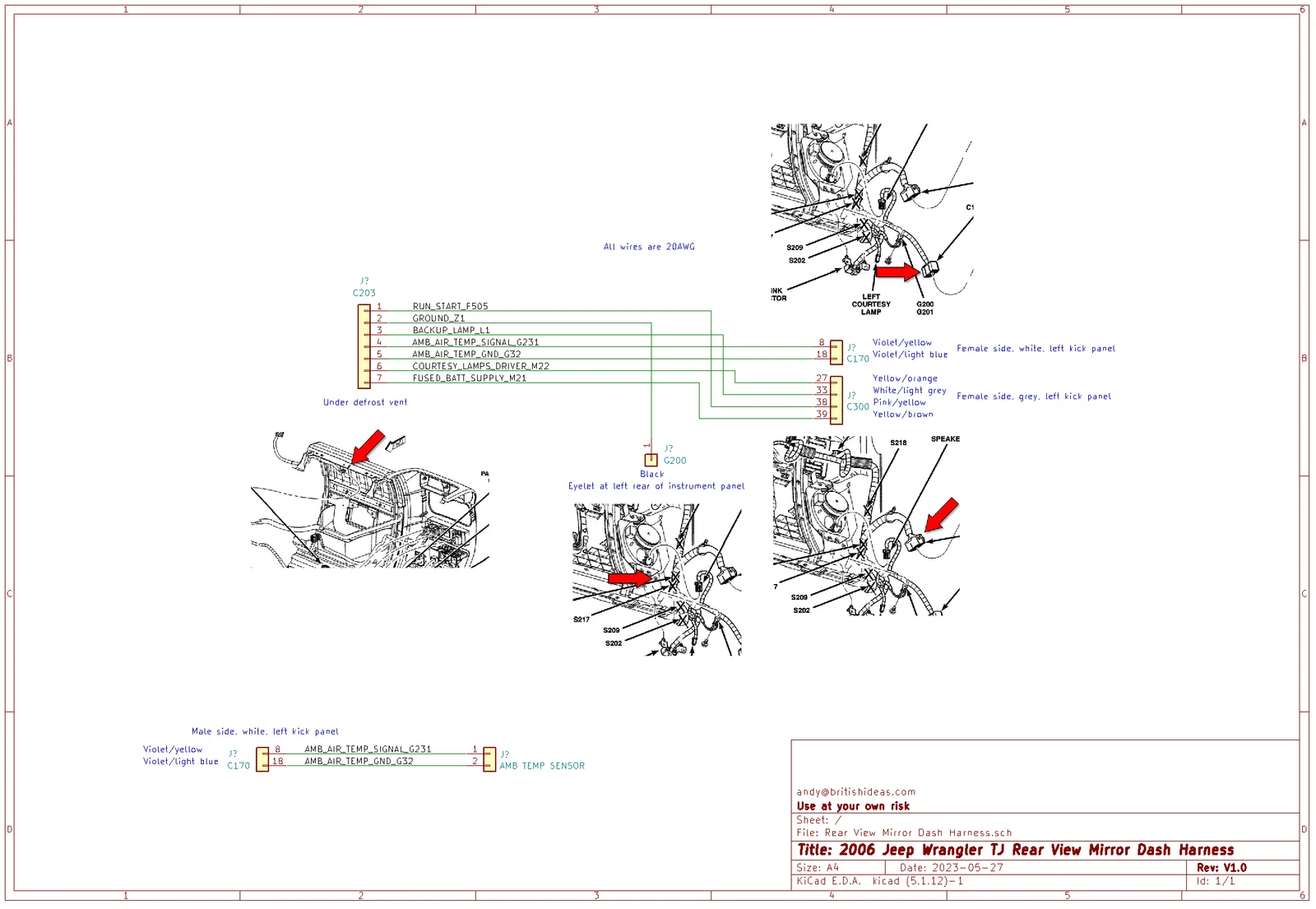

I made a diagram of the retrofit harness if your Jeep doesn't have one in the dash. All three connection points are in the same area near the left speaker.
Please let me know if you spot any mistakes.
Thanks! Andy
Thanks! Andy
