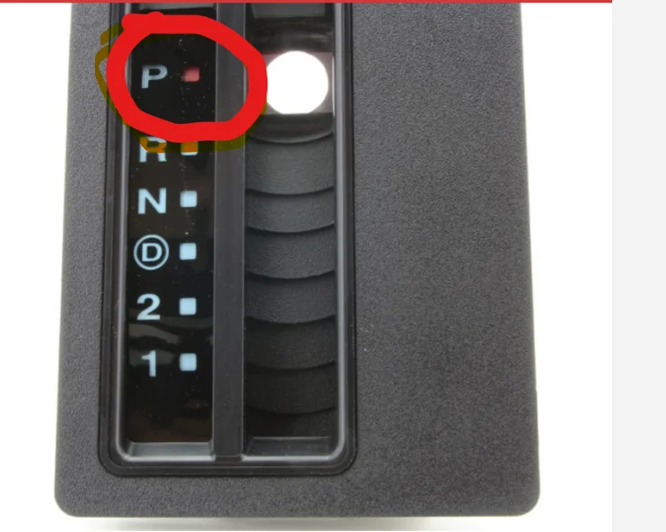

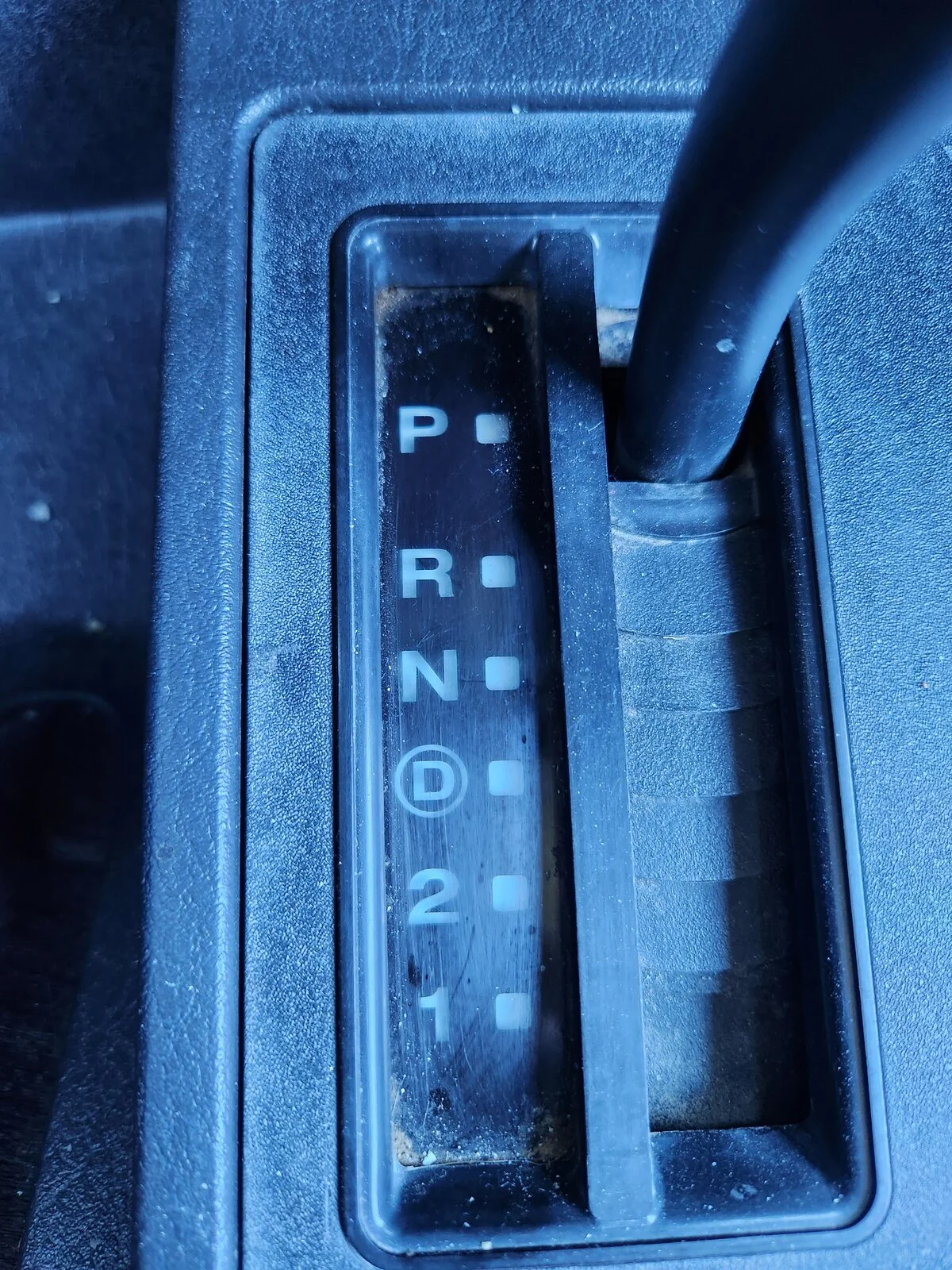

Does anyone have a fix for the shifter position indicator where it doesn't move up/down with the lever?
Mine looks like it's stuck between Park and Reverse as i can just see some slight shading in both squares. I would have assumed it was just a bit of a marker attached to the side of the shift lever.

There's just a small plastic piece that keeps the red shift indicator aligned with the shifter. I'd pop the shifter up & out of the console and take a look. I can't believe ChatGPT is blaming the shift cable for that issue or saying being in Park has anything to do with the overhead interior light.

See if @zebra12 ’s fix will help you out.
https://wranglertjforum.com/threads...your-jeep-wrangler-tj.9151/page-7#post-633128
