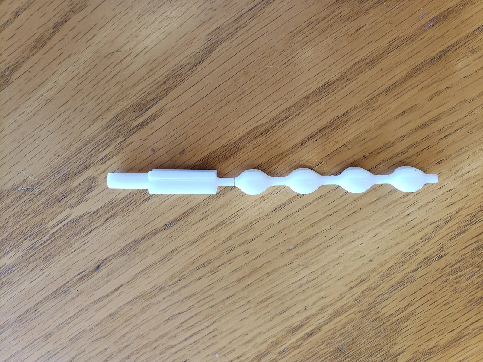

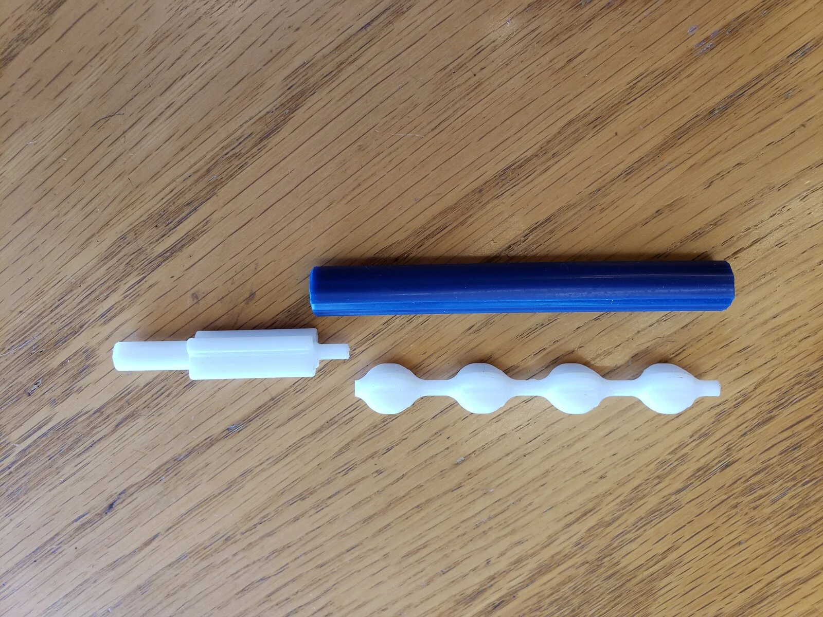

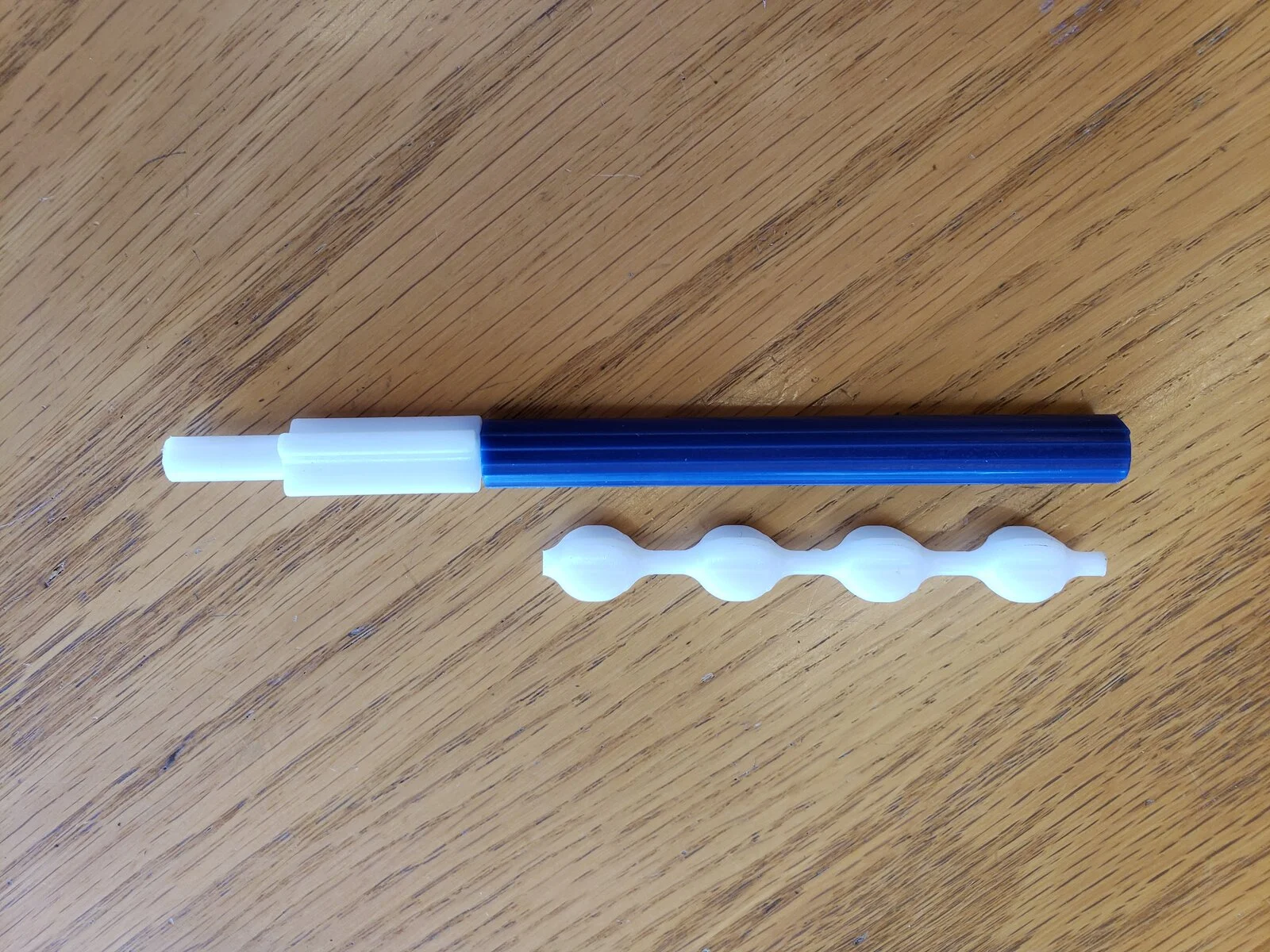

The white rod that inside the shifter tube has broken. Some have used a plastic chopstick but I used a plastic clothes hanger and drilled a hole in the end then attached the original top to the piece of hanger.
Pull up on shifter handle and you'll see if the rod is indeed broken.
That's what I used to repair mine though I didn't think of connecting the old broken part to the plastic coat hanger piece. Great idea!

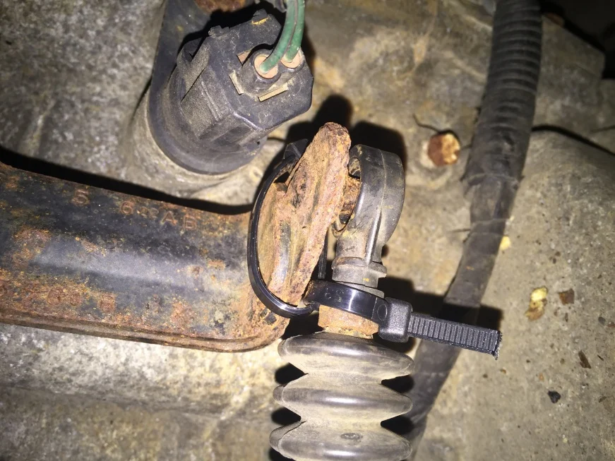

Sounds like OP isn't having that issue... they said they can move shifter without the button, and the transmission stays in park.
I do not have an auto, but almost sounds like the shifter has more issues than just the button. Does the auto shifter still need the button pressed if the shift cable is not connected?
X2, I'm thinking the white nylon bushing that holds the shift cable to the transmission shift lever on the passenger-side has failed. They fail often enough that I bought a spare to carry with me, this is it... https://www.amazon.com/gp/product/B007NPDSAE/?tag=wranglerorg-20
There is a good chance that is the OP's issue, I had the same problem 3 yrs ago, but Holy F-in crap!! $9.04 for that tiny little piece of plastic? I was irritated when I spent closer to $6.00 back then and I didn't think about getting a spare. But hey, at least that seller offers me free shipping (in under two weeks). All I can say now is, Please go away Brandon!!!

I had this happen to me just last week. It's easy to temporarily fix with zip ties like this. I'm working on making a 3d print for this part, cause it seems like it takes 2 weeks to order. I don't know if I could ship the printed parts out to people on here though haha
