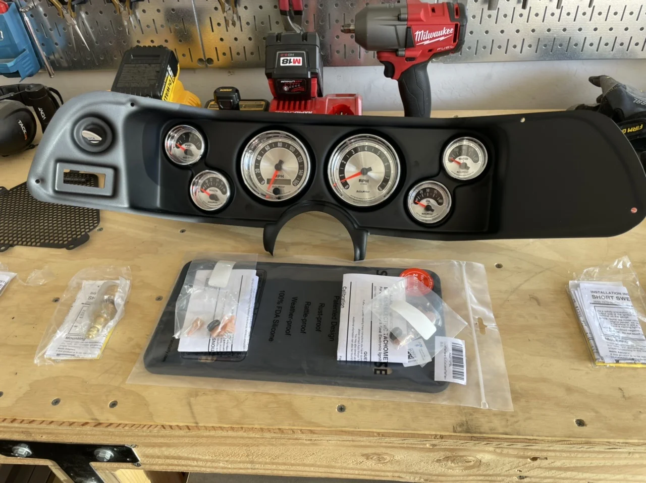

I’m doing some wiring on my ‘72 Camaro Z28. What I am doing specifically is installing the Autometer American Muscle dashboard and gauges.
To do this each gauge needs a power and a ground to start with. My question is about the wiring and what I should do.

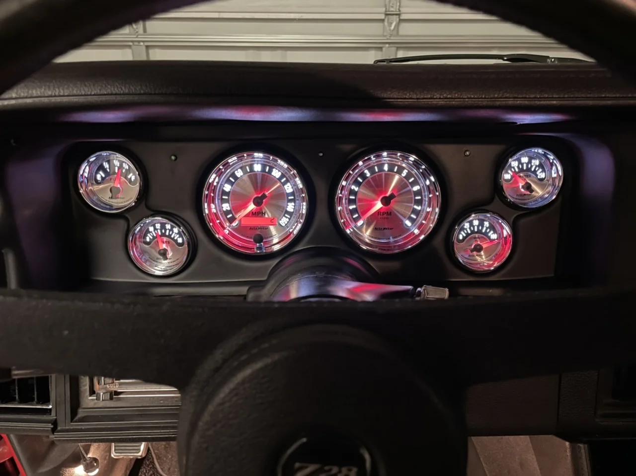

Daisy chain is all done. Now I’ve got to wire it to the car and hope everything works.
Reactions: NashvilleTJ

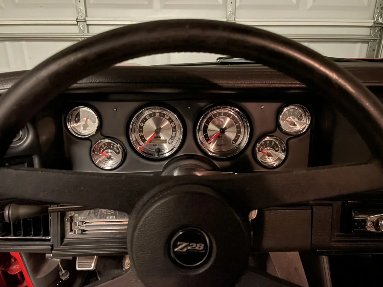

Thanks for the help, everything turned out great. The real PITA here is that these old things don’t have tilt steering so I had to drop the steering column to get the gauges in there.
That looks sharp, Chris. Nice job. Everything working?
Everything worked on the first try. That's good because I was honestly expecting something not to work. I spent a lot of time sorting the wires out though and paying very close attention to what goes where. Needless to say I was happy when I fired it up and everything worked. Certainly an improvement over the factory gauge cluster.
