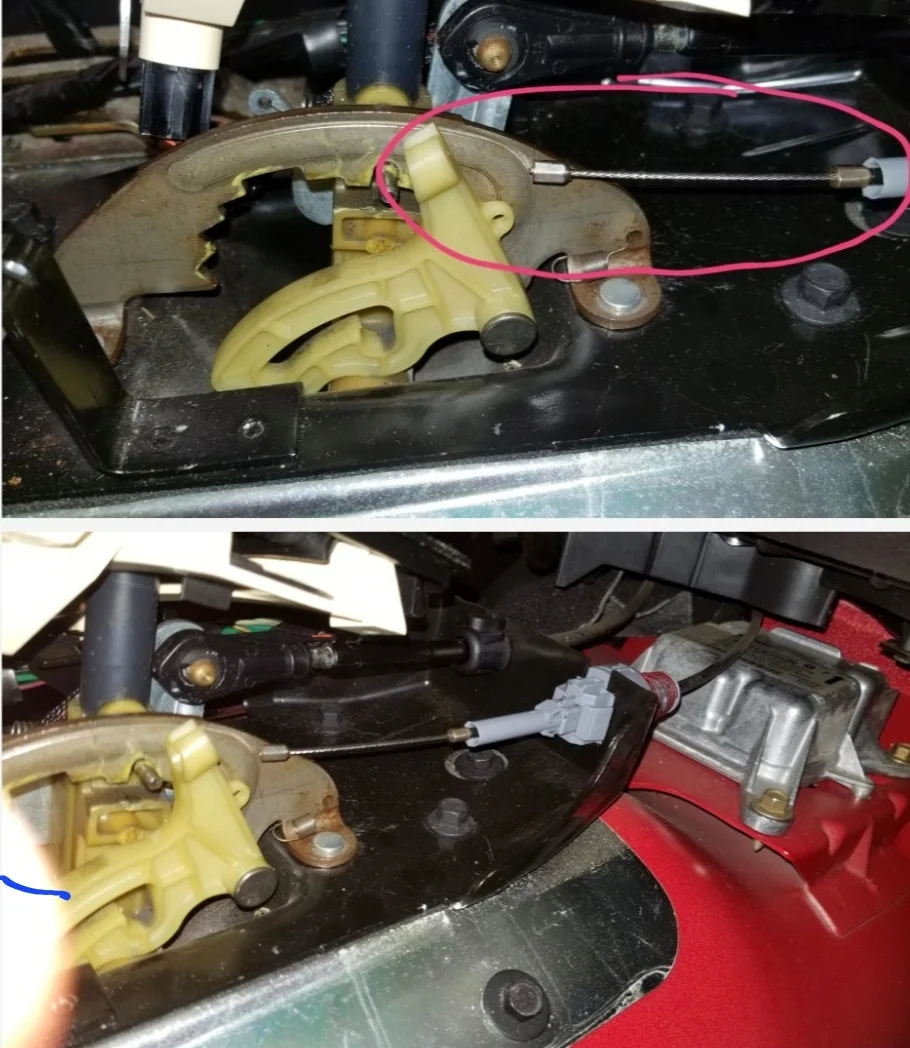

Wondering if you also disconnected the park interlock cable at the ignition tumbler or just at the shifter location?
Q: What did you do with shift Interlock cable?
Purchased this lever, mostly for aesthetic reasons to go with my Rubicrawler levers and Tuffy console. Since my transmission and everything is currently out. Staring at interlock cable right now. Just not worry about it?
He mentioned the interlock cable on the first page. It looks like you don't use it.

Yeah, I read that. And instructions mention disconnecting it. And nothing else. I was just wondering if I can safely remove it completely, or need to stuff it somewhere.

Yep, I removed it completely. I assume you can leave it in there disconnected but that didnt make much sense to me.

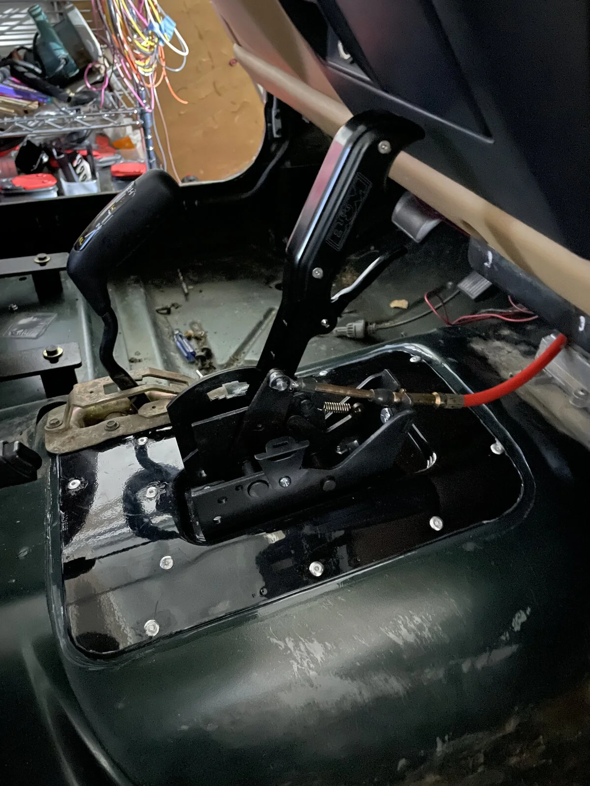

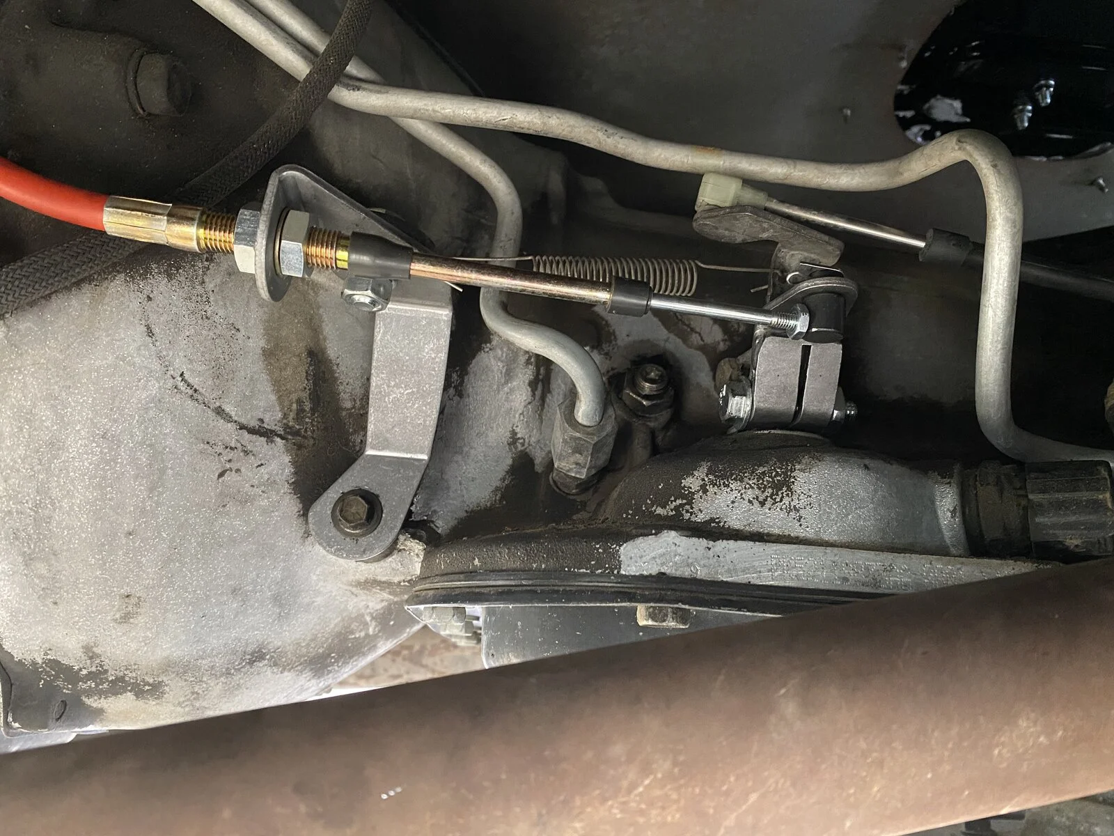

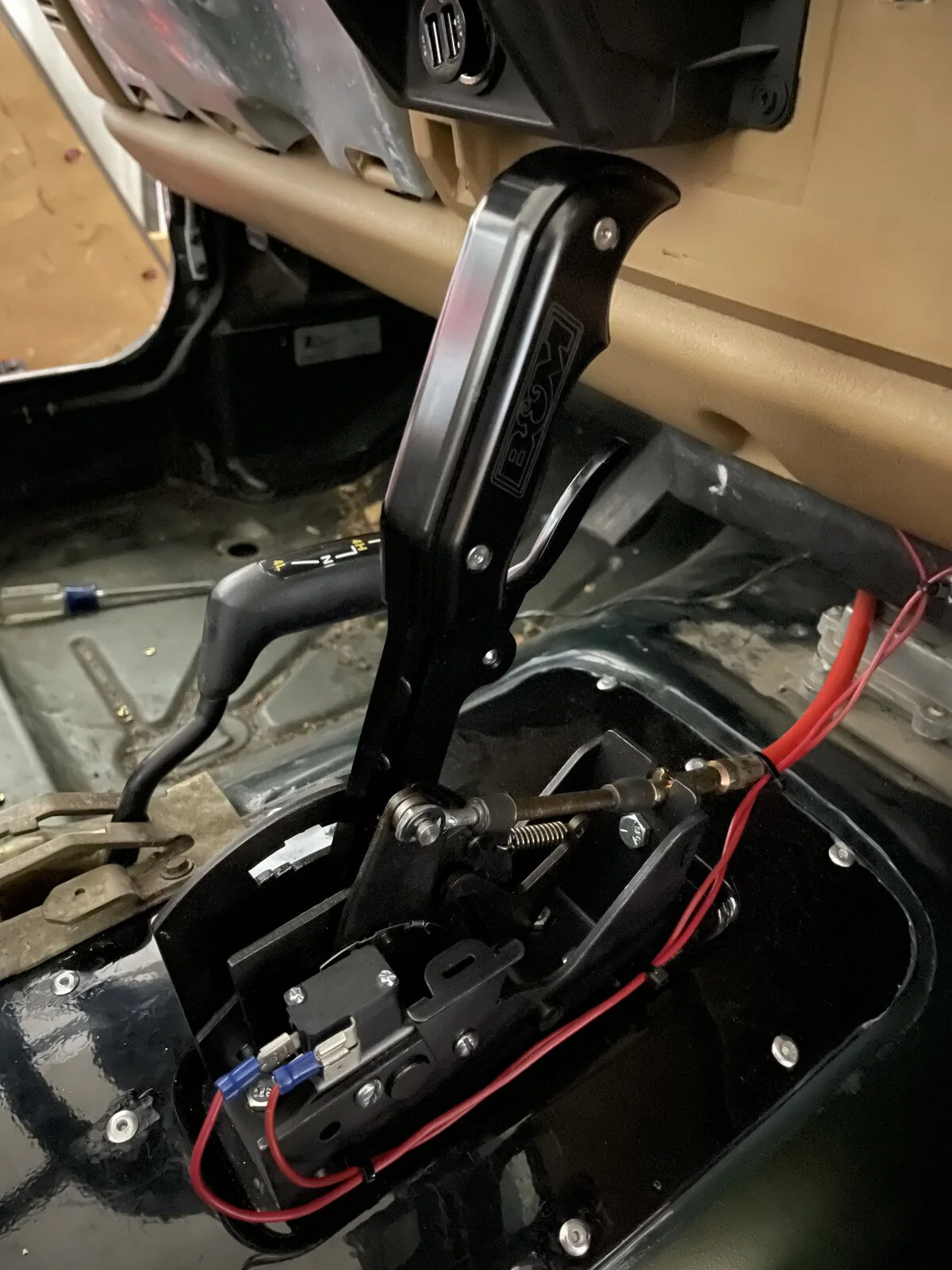

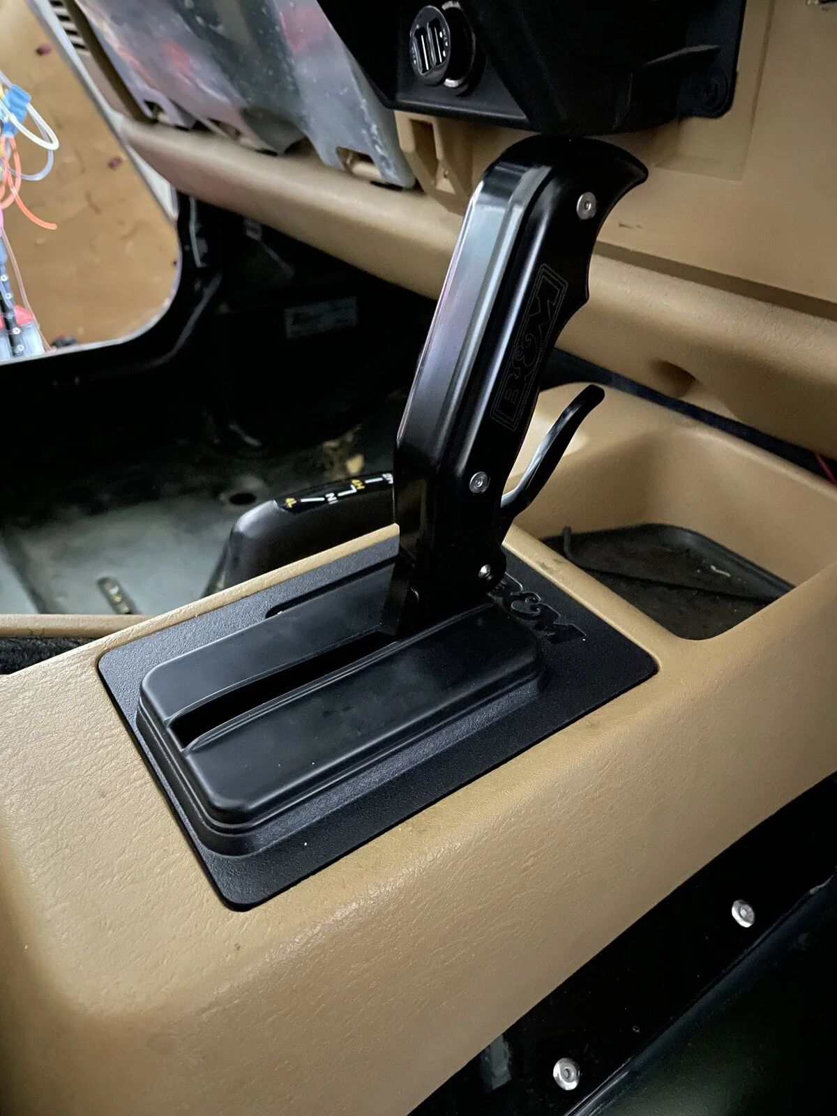

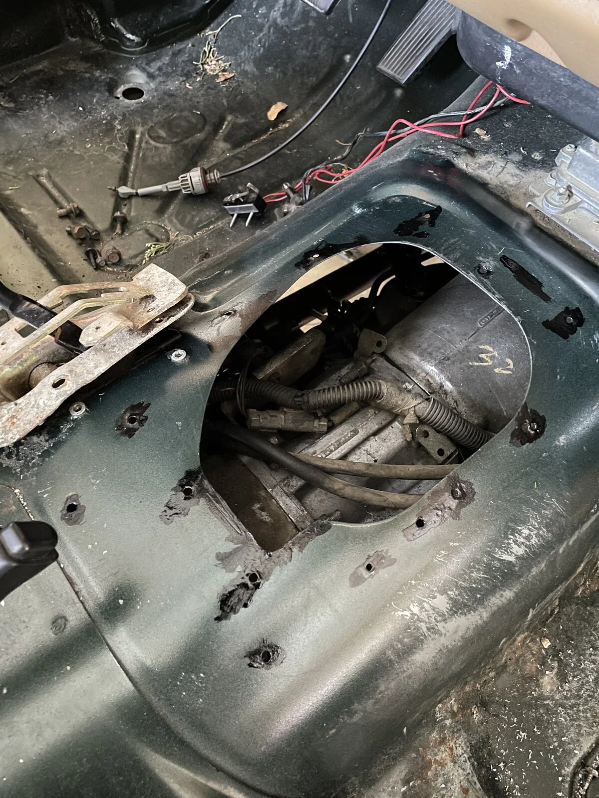

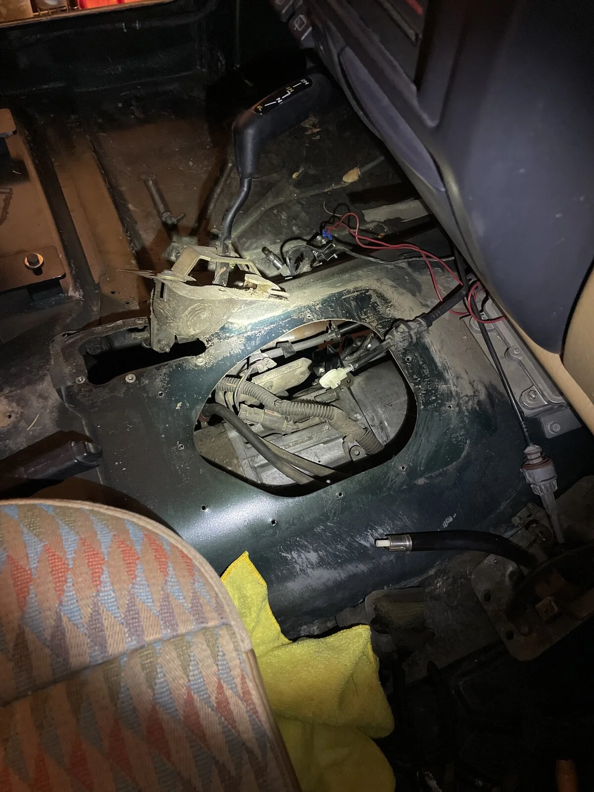

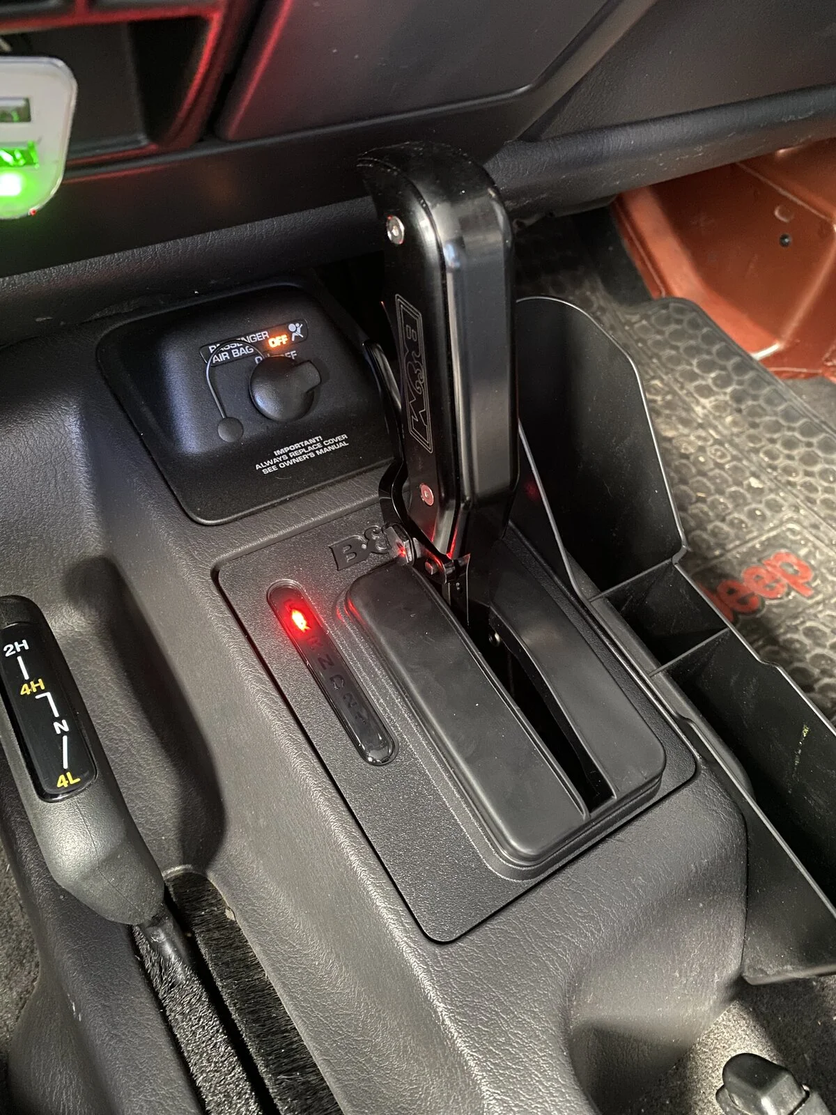

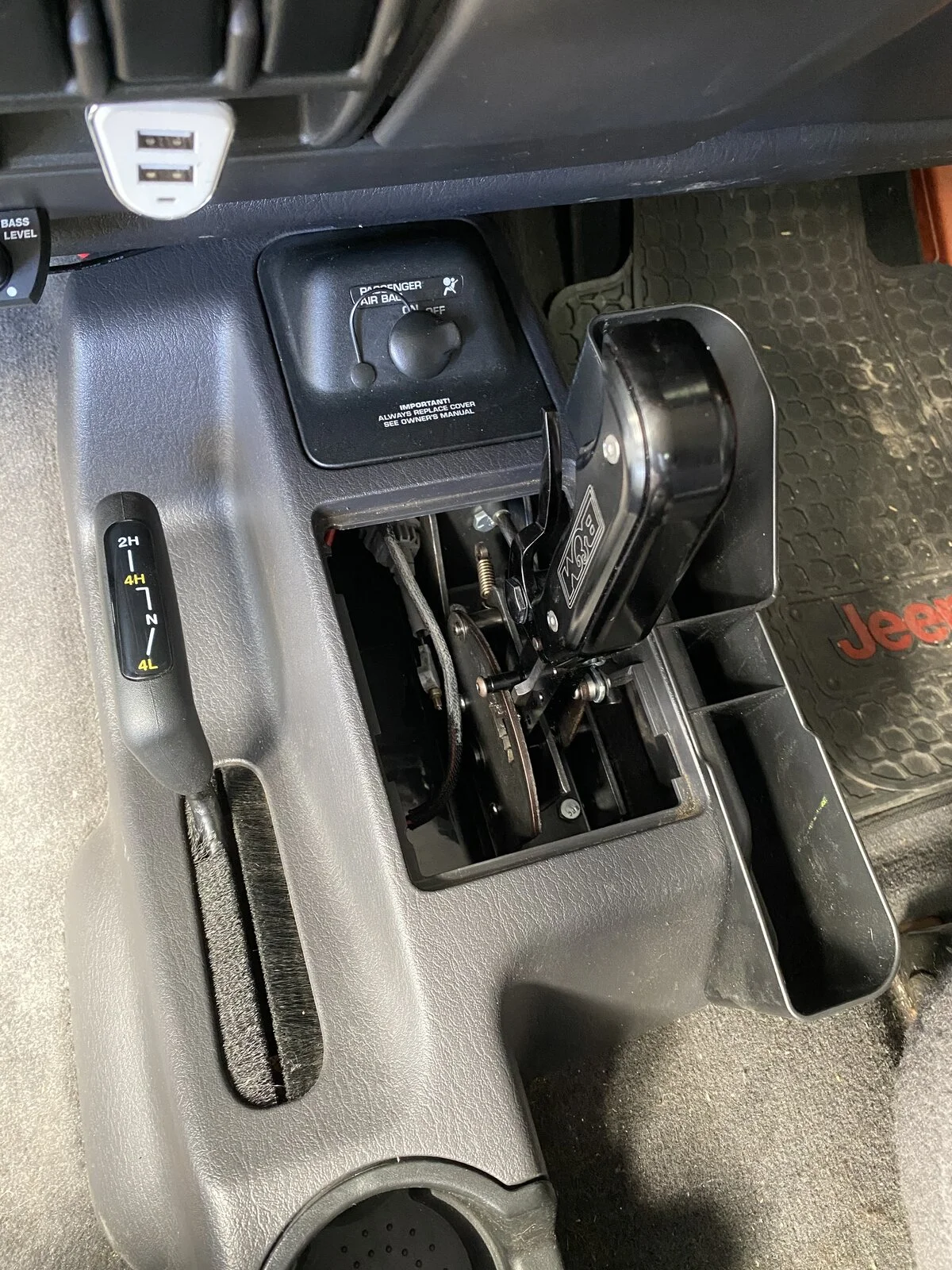

I thought I’d share some pics of this, as I hadn’t seen any pics/reviews of it yet.
Background: this is my fourth CJ/Wrangler but my first automatic. Although the auto is well worth it for both city traffic and my wife’s bum knee, I kinda miss the manual shifting. To try and scratch the customize itch and fix the annoying issue where the stock handle popped off constantly, I got the B&M Magnum Pro Stick shifter part number 81187.
Install was smooth enough and I love both the look and the feel. Completely unnecessary, but hey…oh well.
Let me know if you have any questions.
I'm doing the same install what did u do with the other Grey cable ?? 🤔 thanks
