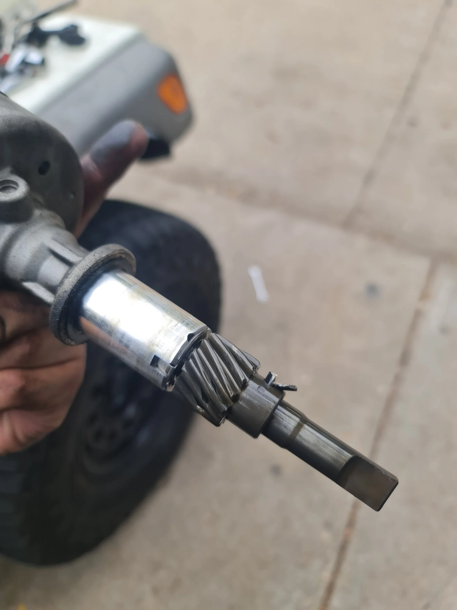

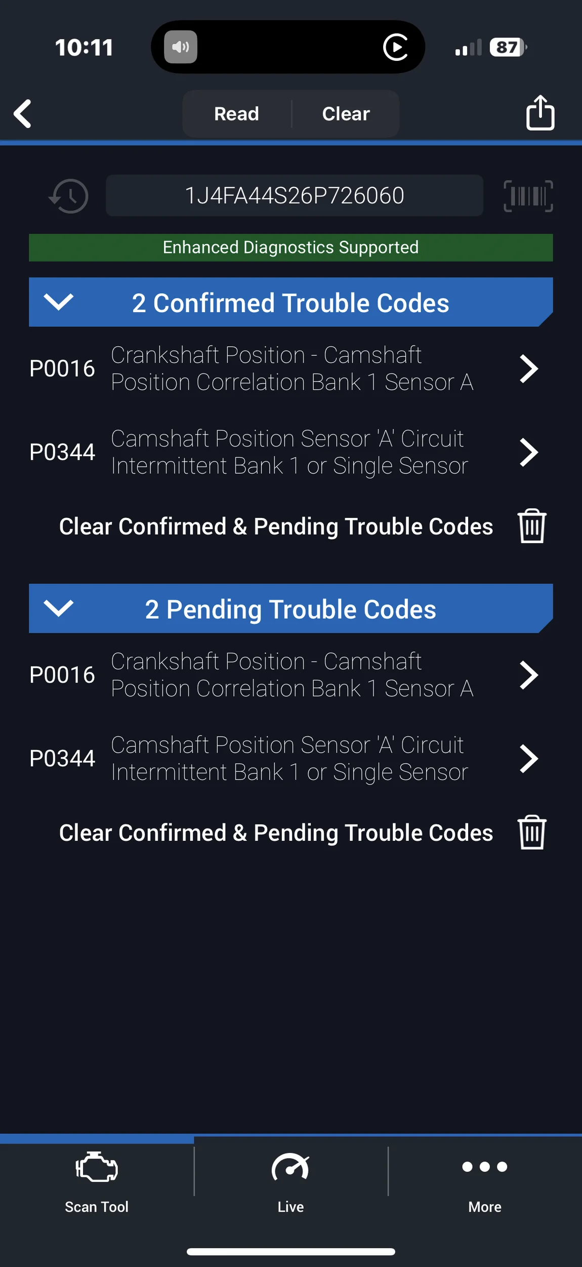

Started the Jeep this morning to relocate it in the driveway and threw a code. I’m thinking it’s probably the OPDA as I did hear a little bit of squealing three different times. Does this mean I should leave the vehicle parked till I replace the OPDA
The only thing that will damage the engine is if the OPDA seizes. Only way to check it is to pull the OPDA and see if it's binding.
So you might as well replace it.

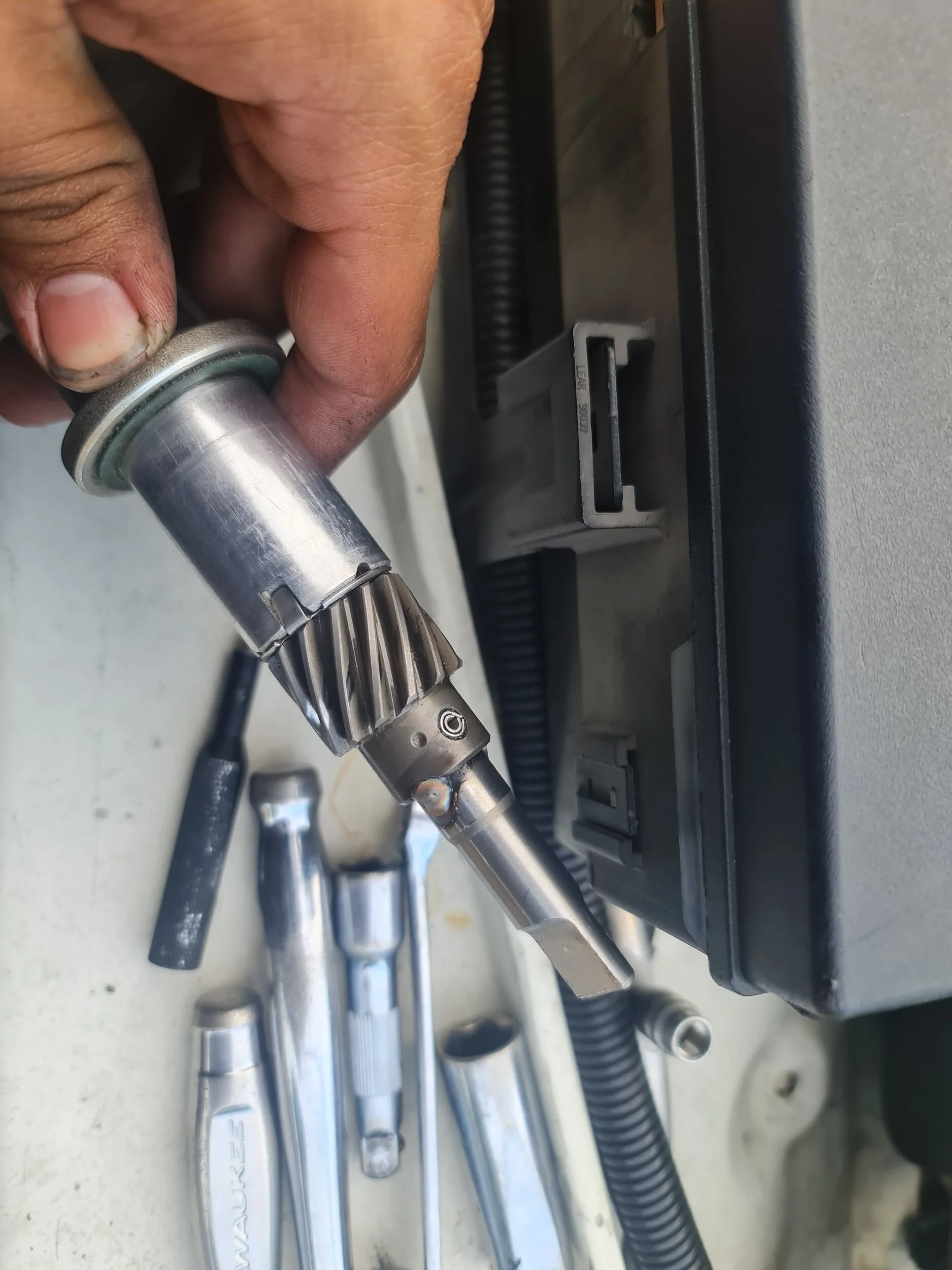

Check if your Opda gear is still fully on !
My sees Limiter ALOT lol so I'm not surprised this happened to me! Even though this is a new crown unit (about 20k ish miles since my cam swap a little over a year ago)
I had the same codes,to fix my issue I just tack welded the gear and did some new roll pins
