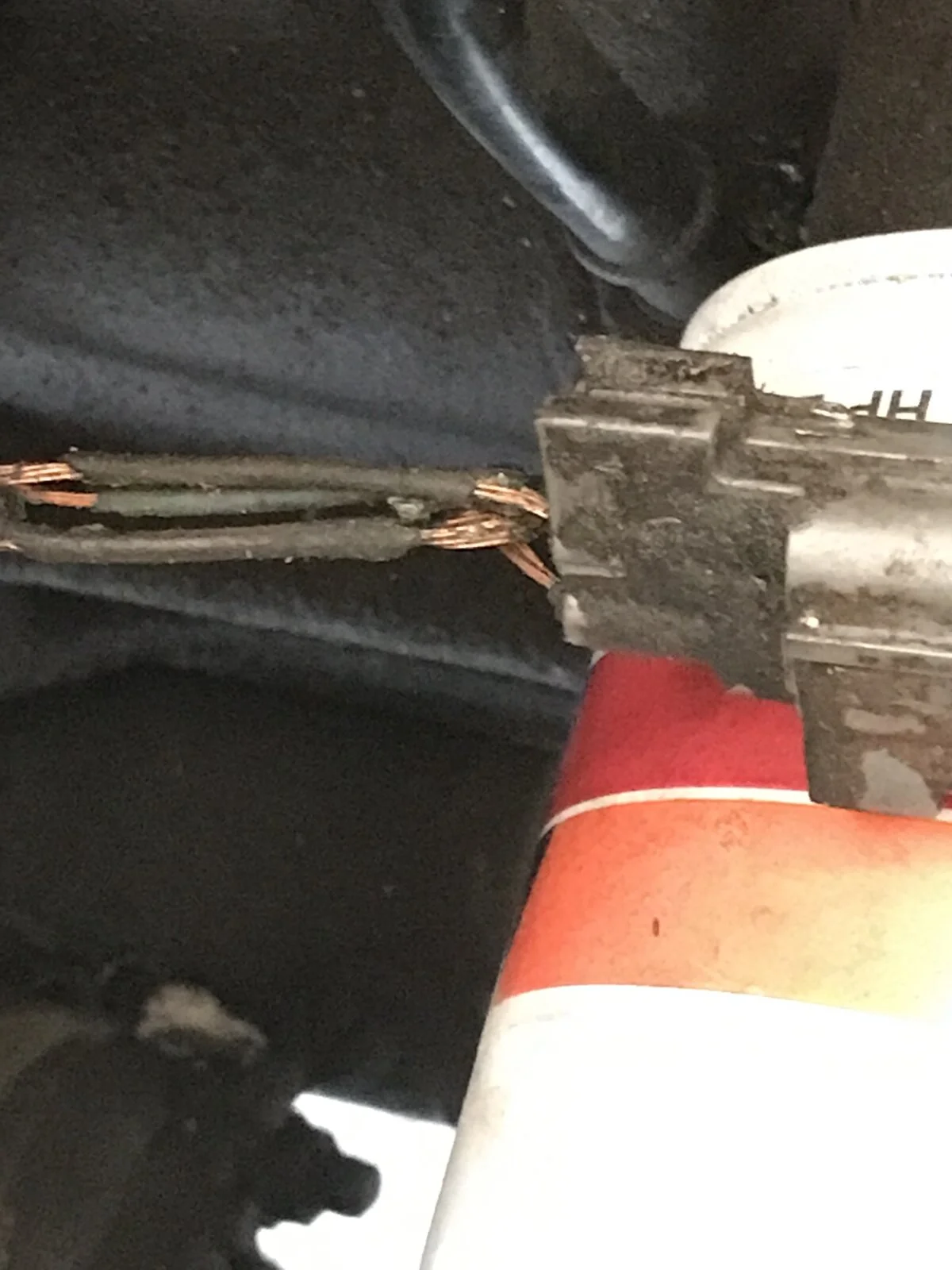

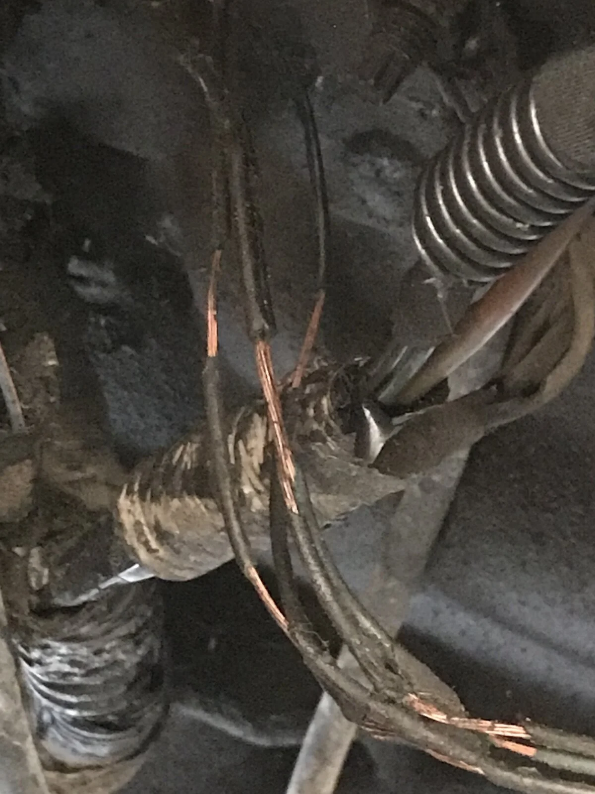

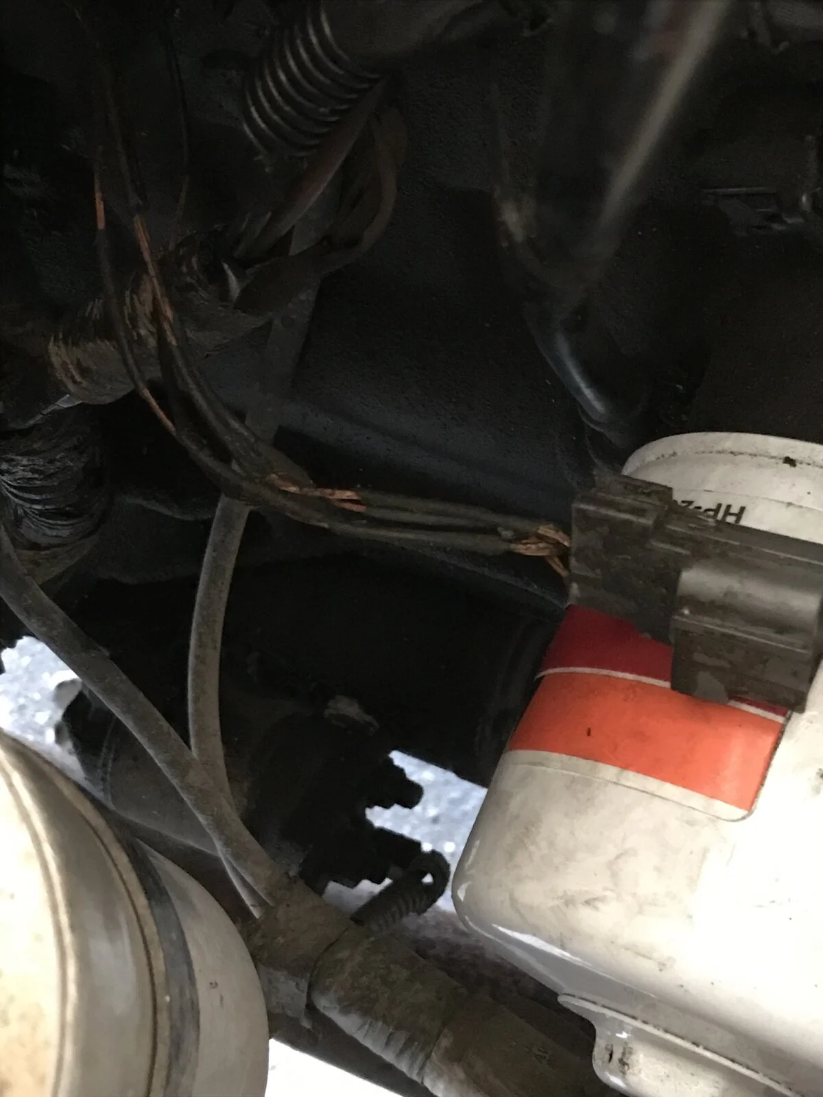

So I was able to get the connector that comes off of the main wiring harness and found this. I really suspect this is one of the issues that is causing the codes to come up. I am not sure how to fix this though as it is coming off of the main harness. Not sure if I were to take this to a shop if they can cut off the old harness and put a new end. I really don't want to be hit with having to replace an entire wiring harness for just the 1 O2 sensor.
Reactions: Wranglerfix
I apologize for the delay in responding as my phone has been acting up. That wiring harness looks like it has been through the war and back. Where is that located?

It's no problem I appreciate you getting back to me. Yeah it definitely has seen better days. This is the part of the harness that has the connector for bank 2 sensor 2. It sits behind the valve cover, i was able to fish it out from behind to more closely inspect it.

Hey Mike I was able to fix the problem albeit I kinda fixed it with a band-aid sort of fix just to see if this was this issue and just haven't gotten it permanently fixed. I ended up replacing the valve cover gasket and was able to determine that a good majority of the sensor wire for this bank was in horrible shape. I simply first tried pulling the separate wires on the harness apart from each other, wrapping each part in Tesa tape where the covers were gone and cleared the computer. I drove it for a while to see if the codes would reappear and thus far they have not, i have about 200 miles since I did this and all my sensors are ready for emissions testing.
I don't drive much anymore as I work from home now so typically it really only gets driven occasionally. This was able to fix the few issues that I have with the heater circuit and some other problems with this bank also running rich. I haven't gotten to doing the permanent fix yet but will likely see if I can get a kit to replace this section of the wiring.
