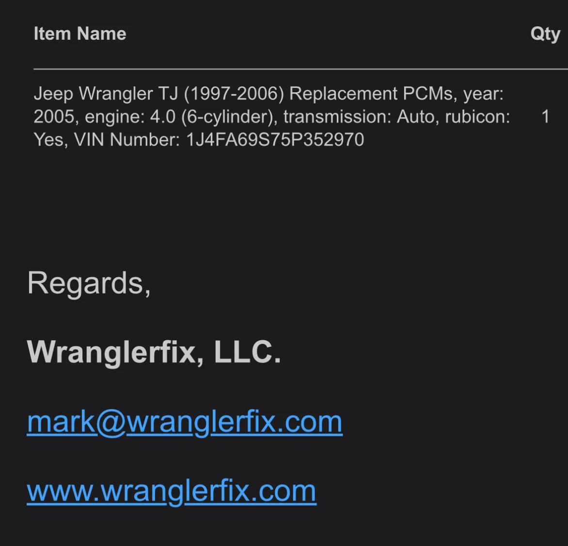

thanks for the details MikeE024. What was the P/N of the PCM you got from WranglerFix?
I just ordered and will try this out with my Diablo tuner once the new PCM arrives.
  • USA Proud
Reactions: Wranglerfix
Hey man not sure about the PN but here’s my order info. I have a 2005.
Make sure to reinstall the stock tune to the old PCM before removing it from tue rig. Doing so will unlock the Diablo and allow you to install the Banks tune just as you did in the past.
Before going down the messier path that I had to take, try hooking the Diablo up straight to the WF PCM to see if it will take the tune without any fuss. It’s possible that the software will play nicer for you than it did with me (needing to be synched to the application on the computer).
Would love to hear how your experience goes.
