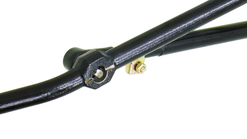

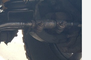

Well, The ZJ rod is about 7/8-1" in diameter. Currectlync is about 1.5" diameter. Also, on a currectlync, the tie rod to drag link connection is a dead giveaway...
Plus, there isn't a sleeve on the Drivers side of the currectlync, and there is on the ZJ steering
ZJ stuff
Interesting mine does not have that sleeve. Looks like the correctlync on their website too.

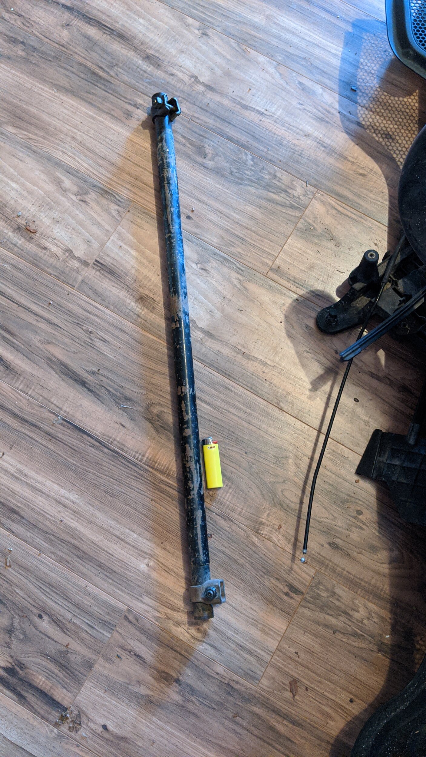

Lighter for scale all my measuring tapes are outside

Ok whew thank goodness. I also don't know what drag link I have. It says it doesn't work with the OEM drag link on their website but I've been using it for a while now so whatever lol

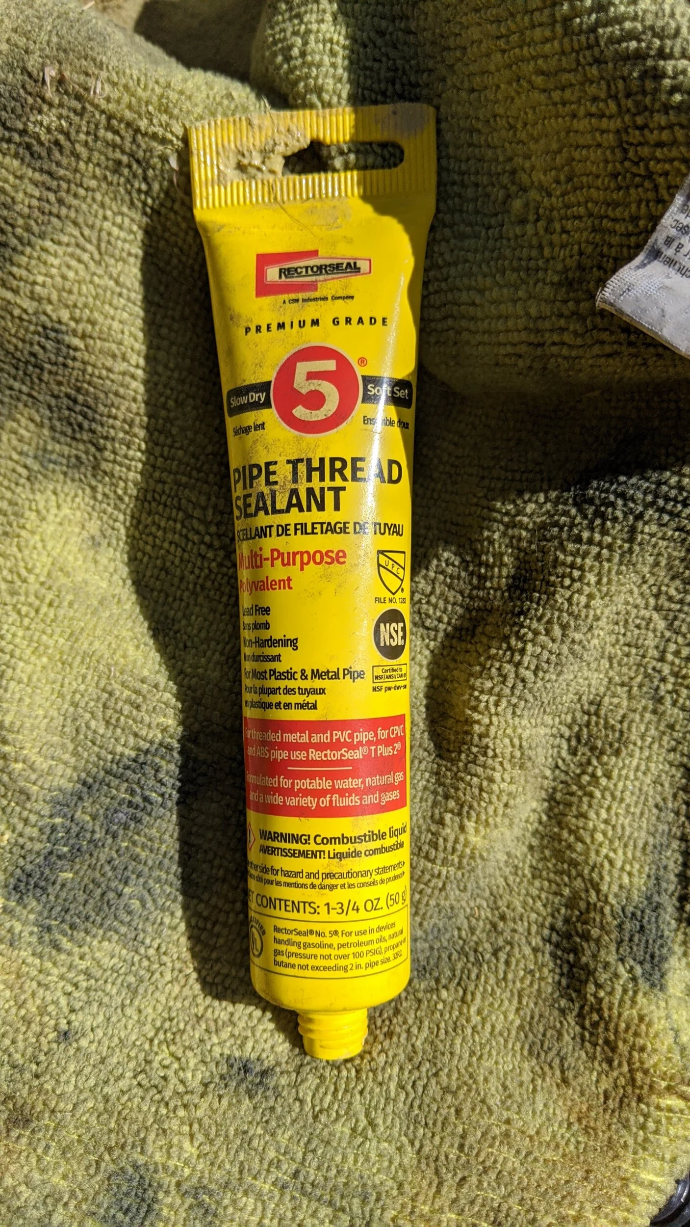

Video isn't loading right now. But. Air compressor is alive and working. I think the China special regulator I got is broken, but it's going. It also is leaking. What's everyone's favorite thread sealant? Whatever I bought clearly doesn't work very well
What sealant did you use?
