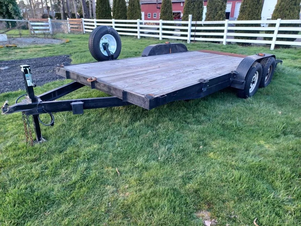

I like aluminum too but I don't like the $$$$$ that goes with them. My 14' steel trailer with wood deck weights 1600lbs. And Irun was saying his aluminum trail is under 1100lbs for a comparison. Both can have a gross combined cargo weight of 7000lbs.
Yep lol. It'd be nice but I'm not really willing to pay for it. A wood/steel trailer with a jeep on it is still 1/2 or under of my tow capacity so I'm chillin. Trying to spend 2500$ or less soooo

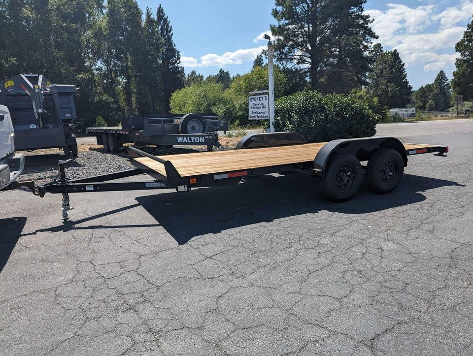

Lots of junk like this. Not perfect but good enough to start with.

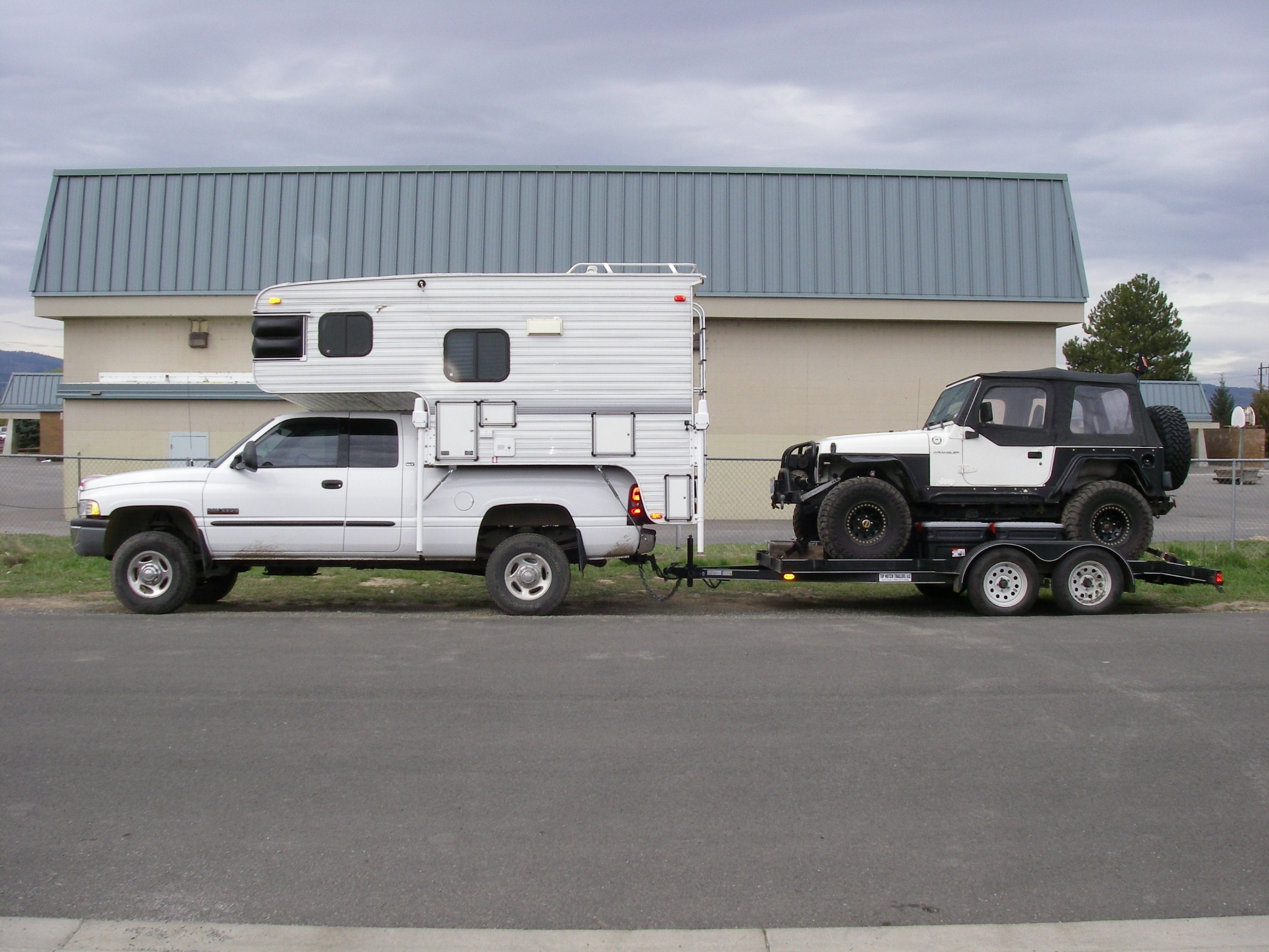

Do you think there are any extra considerations for a trailer that will work with the truck camper?
Your camper isn't any longer than your truck so no you should be OK. I ran a 12" stinger with my S&S camper.

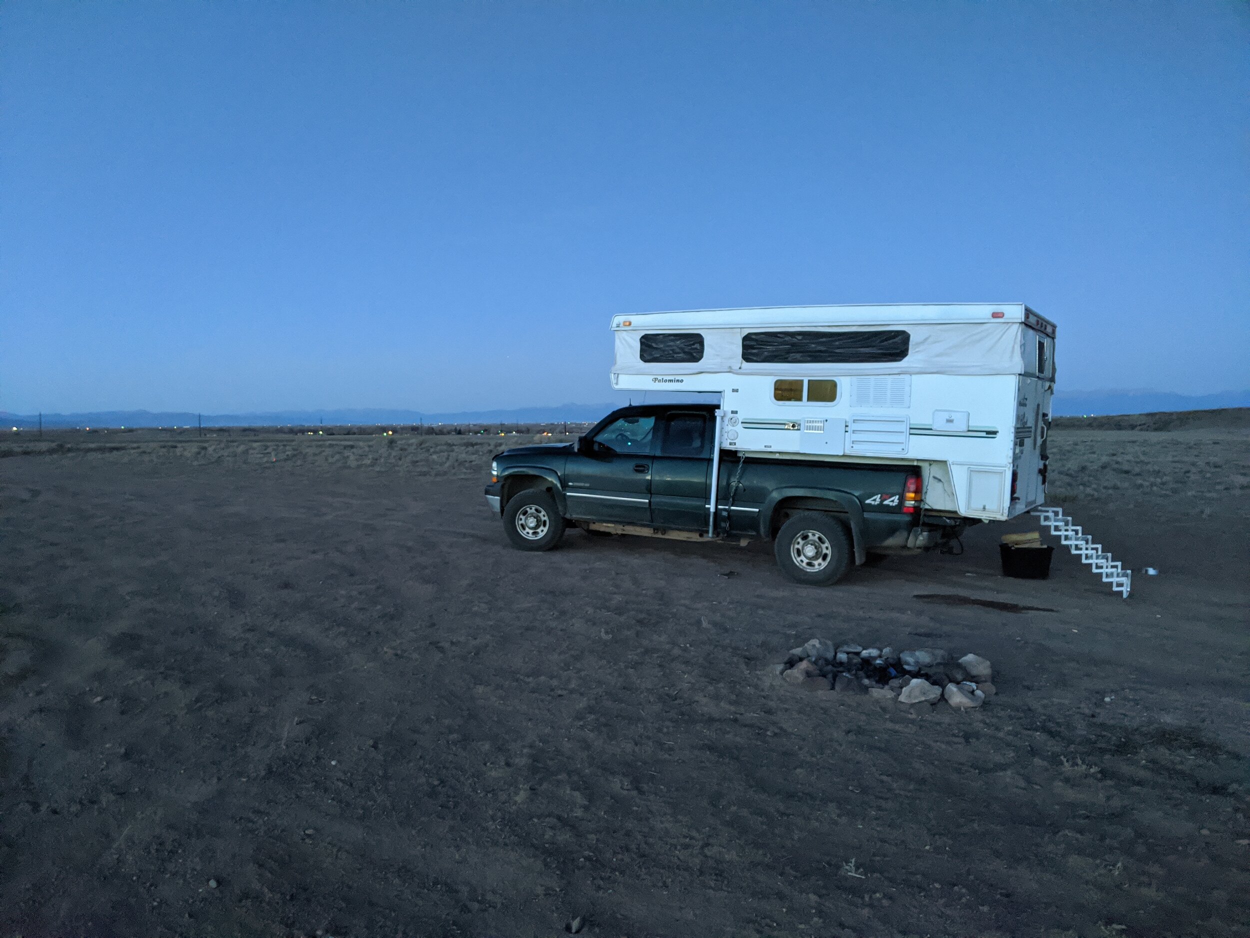

My camper does stick further out than yours. It looks like the tongue on that trailer is relatively short? I was also worried about needing to relocate the jack (not a huge deal) but it looks like it slides right under your camper.

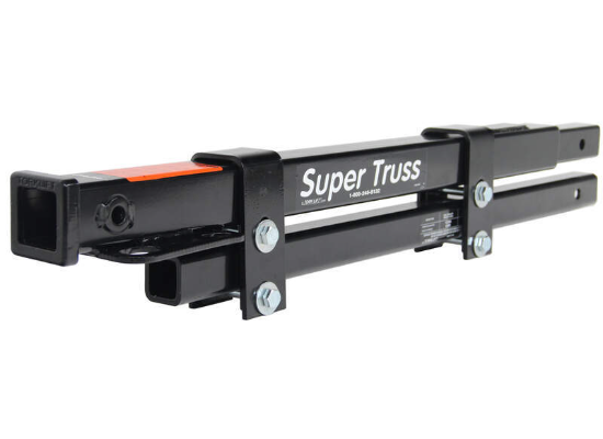

You'll need to measure from your hitch to the end of your camper. Then get a hitch extension but you will have to pay attention to it's weight restrictions. You might have to run a Super Hitch (dual receiver).

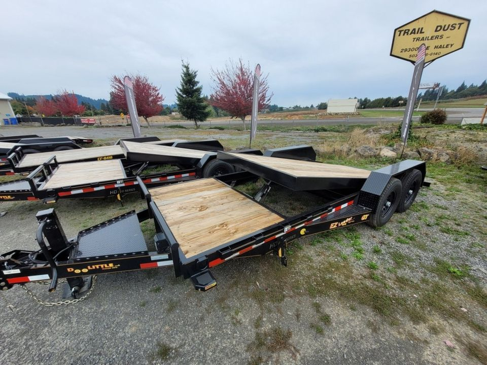

I want a tilt deck like this for my next trailer as I'm too old to lug ramps around anymore. My motorcycle would get side loaded on the front.
My friend has a trailer like this except the entire thing tilts instead of a portion.
He actually told me to avoid them he says they're a pain in the ass, he says he has to use 2 hi lifts to get it to be where he needs it. Do these have some kind of powered tilt motion?

The Super Hitch is this
Has a weight capacity of 6500lbs. Or 12,000lbs with a weight distribution hitch.
https://www.etrailer.com/Hitch-Adap..._0DHN1Okm3PkxmVYKQOk6_IAAG-lNRSxoCzrUQAvD_BwE
I have not seen anything like this. This is because an extender lowers my rating? If I need one.
