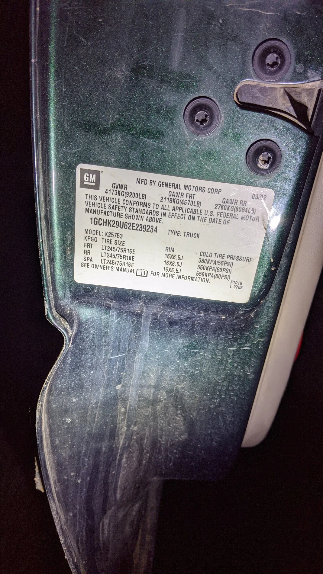

You can start by just looking at the door card and making some rough calculations. How much is the camper? What is your GCVWR and GVWR? Axle Weight Rating? How much does the trailer and Jeep weigh (probably around 6000 lbs, give or take). Take 10% of the trailer load and apply it to the Rear axle load.

Dry weight of camper 1401lbs
GWVR 9200lb
Looks like rear axle weight rating is 6048lbs
Guesstimate my junk + water at like... 400lbs max extra?
if the trailer + jeep is 6k, with 600lbs on the rear axle...
That puts me at 1401+400+600=2401?
That is a really wide margin kinda seems like I am not doing it right

You're leaving out the unloaded weight of the truck on the rear axle.

Don’t forget the weight of the truck…that comes right off the top of the gross weight ratings

Where do you find that?

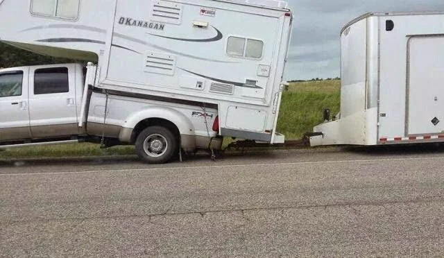

PSA...
This is what can happen when you overload a truck with a hitch extender and a camper..
You can always lighten the tongue weight of the trailer a little by moving the vehicle further to the rear of the trailer deck. Just remember you need to maintain a forward weight bias... I believe its something like 60/40% infront of and behind the axles. That will give yu the lighted tongue weight and still keep the trailer stable.

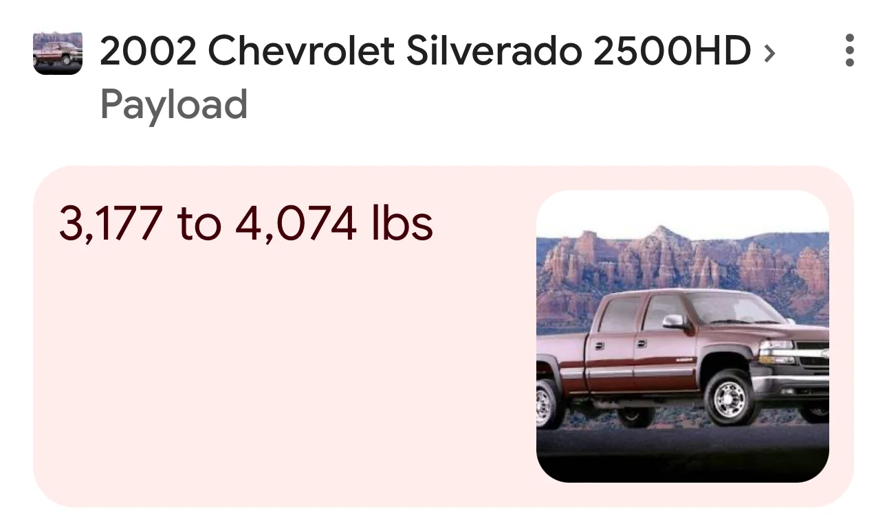

ye but payload for what?
There’s only one payload. It’d be all the additional weight your truck can carry, including the tongue weight, cargo, camper, passengers etc.
I’d confirm your specific payload but that should give us an idea.
That is the GWVR minus truck weight to get to that figure right?
