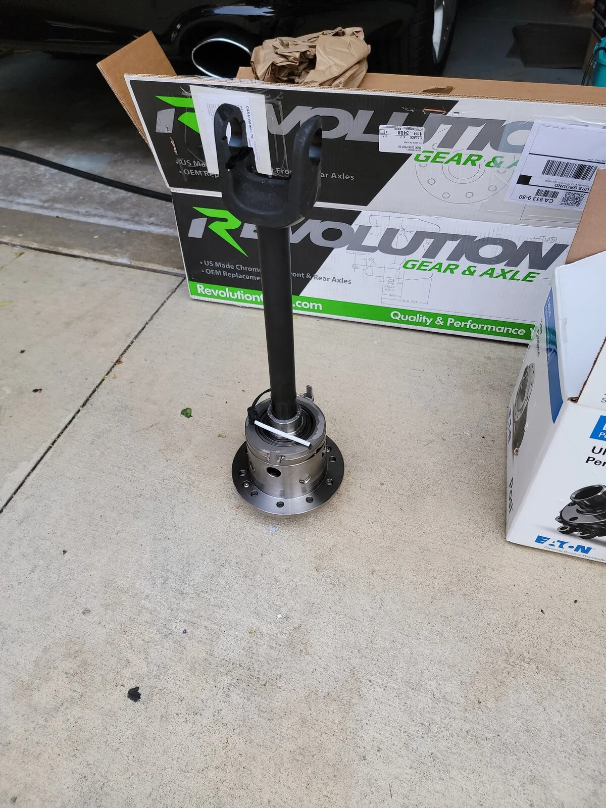

I am having a run of bad luck with my front locker install. Im building my Dana 30. I trussed and sleeved it and welded gussets on the c’s. I purchased a 30 spline Eaton elocker 4 for my Dana 30 from Quadratec. The first one they sent was a 27 spline locker. They corrected the issue by sending a 30 spline locker. I grabbed my driver side 30 spline shaft and verified the fit. I dropped my Dana 30 off at my local trans. Shop and had the locker installed. I picked my axle up and brought it home. The drive side 30 spline shaft installed no problem. The passenger shaft would not spline up. Long story short, I removed the carrier and discovered the drive side of the carrier was 30 spline and passenger side was 27 spline. WTF MAN! This has cost me a month on my build, 2 sets of bearings, $30 in dif oil and my sanity. I had to cancel my birthday rock crawling trip. Has anybody ever heard of this happening before? I will be contacting Quadratec bright and early come Monday. They better make this right!

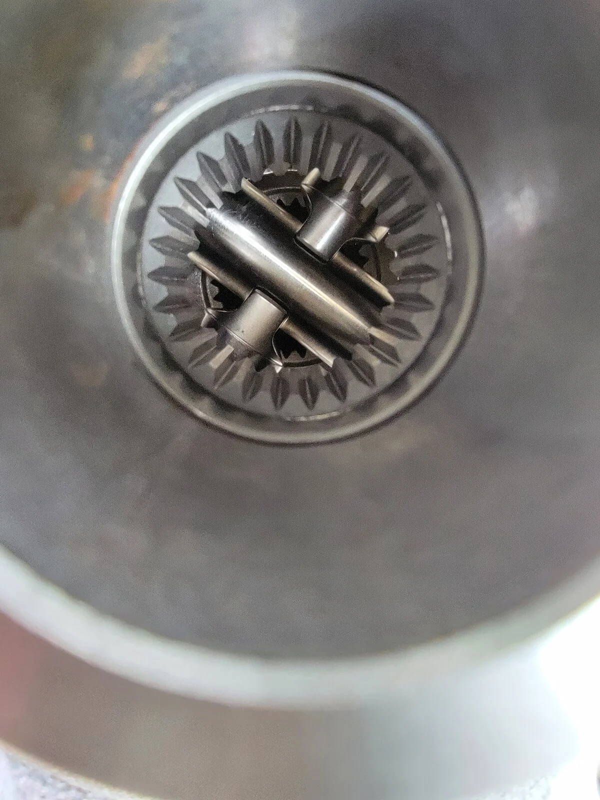

When I removed the carrier, I grabbed a sharpie and a flash light and counted splines on both sides no less then 3 times each. Even though Ray Charles could have seen the difference in inside diameter and the size and shape of the individual splines.

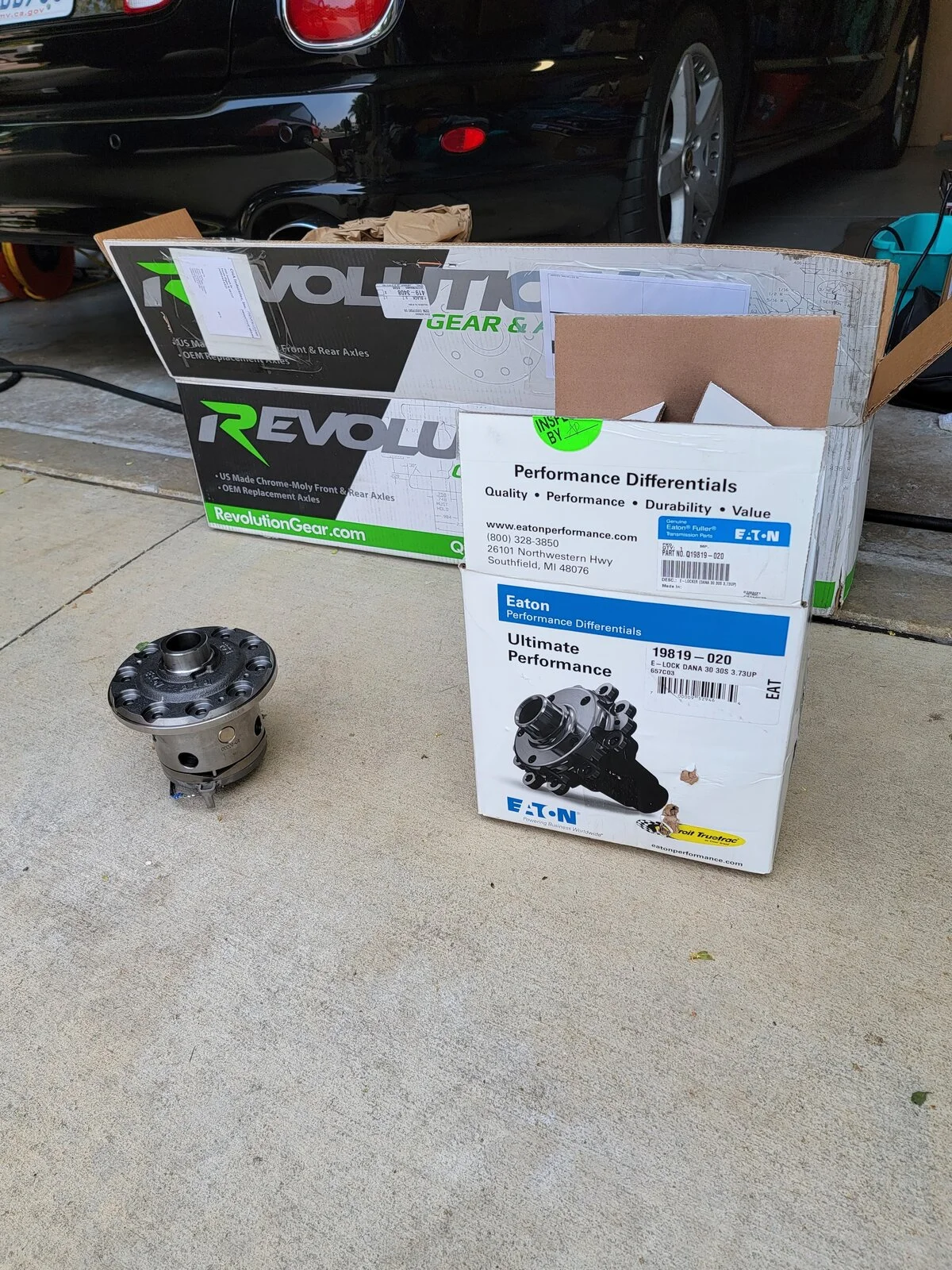

Eaton E-Locker Dana 30, 30 spline. Here we go again....
First side good! 30 spline axle fits well.
Second side...Like I said in my previous post, Shit!
Count 'em up. 27.

Well there we go! There’s a bad batch out there. Sorry your having go through this also. Eaton has some explaining to do. Good luck J.

I get that! Just curious if it could be isolated to a batch Quadratec received from Eaton. There’s no telling how many lockers got assembled incorrectly. If the ones they still have in stock are fucked, Quadratec sending a new one will help neither of us.
They only way for them to know is to open the box and check. Since there are two, that could be two or two thousand. Eaton has a giant problem on their hands now.
