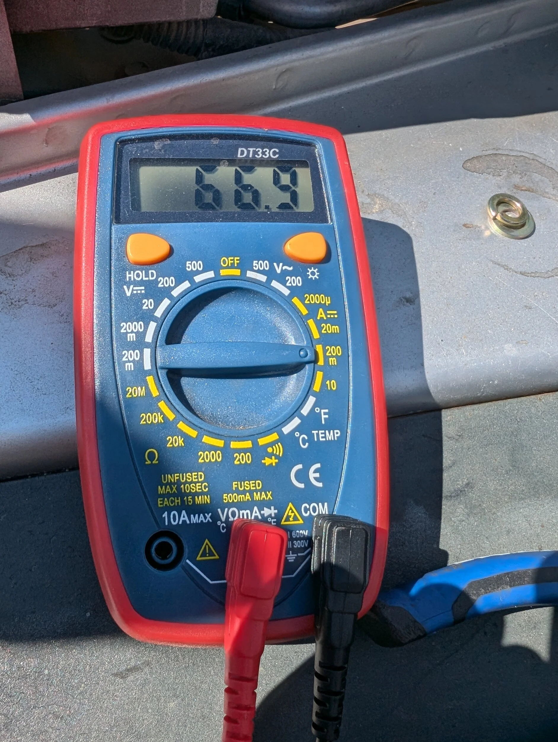

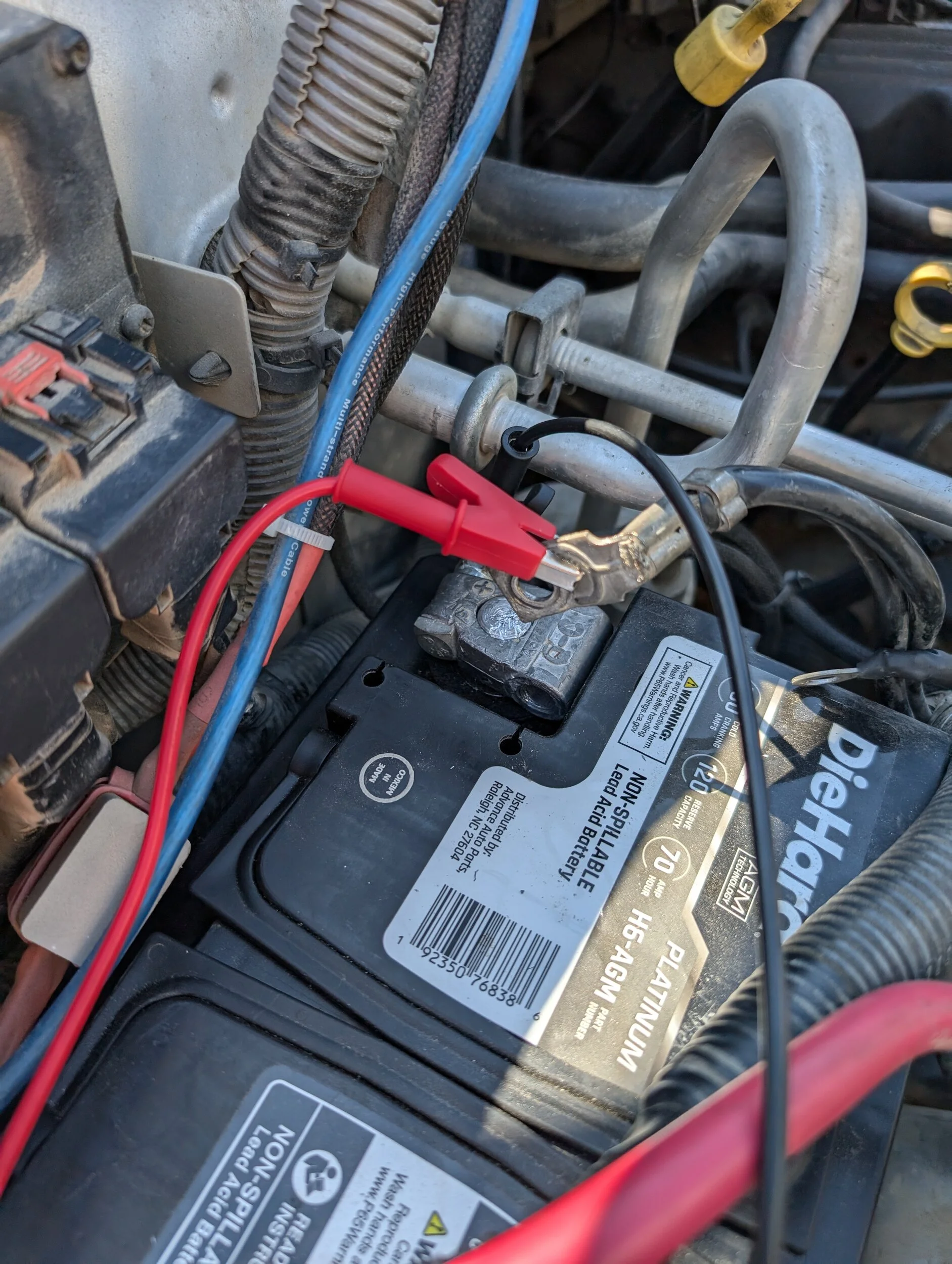

My battery has gone dead a couple of times, so Im trying to track a drain.
I'm using a multimeter set up in line on the negative battery terminal.
It shows 66 milliamp draw, I think. See picture.
When I pull the access.2 10 amp fuse, it drops to 24.7.
Is this something that would drain a battery over 3 or 4 weeks of sitting?
Yes, 66 mA is a bit much. Need to put a volt meter across all the fuses and see what's pulling.
Reactions: richardh
Seems like Access.2 is drawing 40mA. When I pull that fuse, the draw is 24mA.
What is Access.2?
