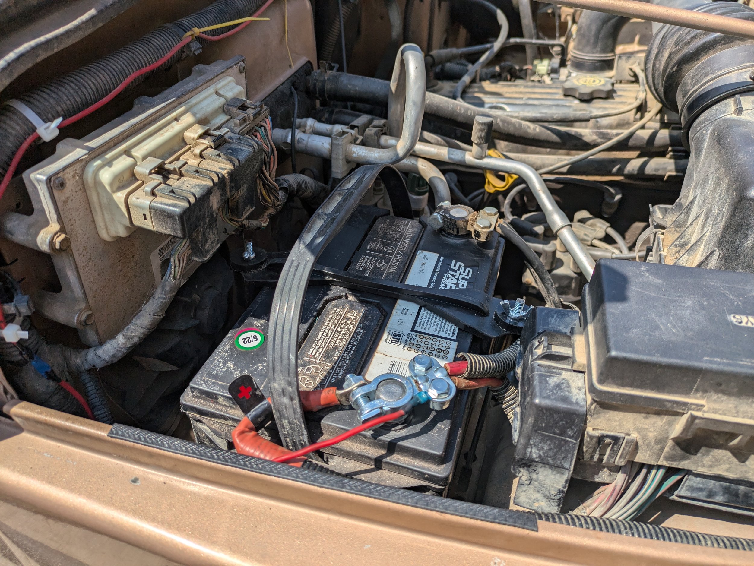

Battery terminal contacted edge of tub, TJ exhibiting weird driving behavior afterwards

Thanks for everyone's input and recommendations. I got the edge trim as recommended as well as the tie down bracket. Replacing the battery terminal connector seems to have resolved the no start condition and she drove normally this morning.
If you are ever in our area, stop in and we'll be glad to repair the cables with some very nice crimped on cable ends and I'll even throw in a set of military style battery terminals. The reason I'm glad to do that for free is you have managed to pick the very worst type out there and they will only lead to issues later. They are so terrible it should be against the law to sell them.

I've still got the original cables with the factory ends in great condition. Is there any advantage to me cutting them off and going with military style ends? I already put slightly longer bolts through mine to fit accessory wires.
The main advantage is the ability to bolt up more connectors. The disadvantage there is most of them have 3/8" bolts so all the accessory terminals need to fit that.
Thanks for the offer Mr Blaine, would love the opportunity. I'm more than willing to tackle an upgrade like this unless there are specialized tools/techniques needed though.

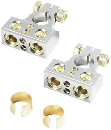

Is there a particular connector you recommend? I've currently got a winch and a wire for lights that are also needing connection points.
Appreciate your willingness to help me unf*** this battery situation. This Jeep is going to be my sons first car and my weekend wheeler, so I want it to drive well and safe.
The good crimper isn't cheap so that would be the first thing you'd need.
