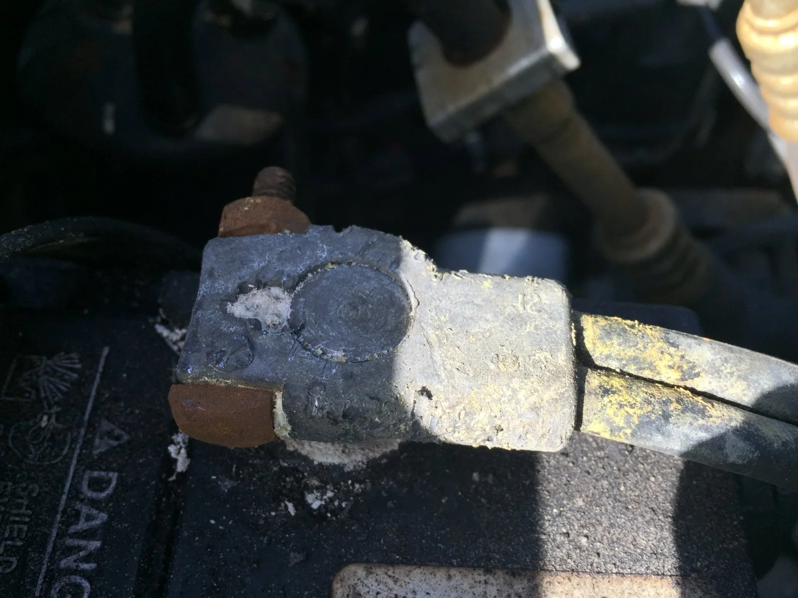

Hey guys,
My battery terminals at the ends of the power and ground cables that connect to the top posts of my Jeeps battery are cracked from what looks like age and being removed so many times. The metal is very soft and doesn't seem like it will last, so i'de like to either swap the terminals or get new cables altogether.
I'm curious to know if anyone has any experience with swapping these out or has any particular terminals they would recommend for a solid replacement? or will any cheap replacement set work just as well?
Thanks in advance.

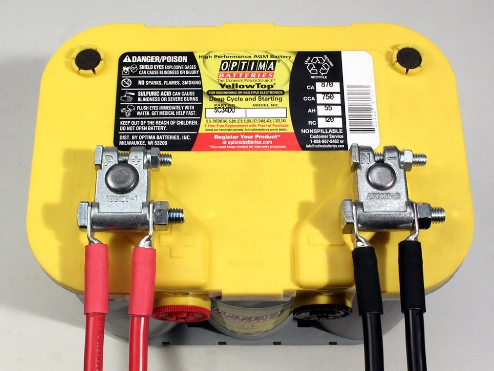

If your cables are in good condition and you have a torch/solder laying around this is what I did: https://www.amazon.com/dp/B00X36RILW/?tag=wranglerorg-20
Oh man, thats more along the lines of what I was looking for. Were yours shot like mine or did you just wanna upgrade when you upgraded your battery? Also, did you cut your power + ground lines or heat the old terminal up and pull the cables out? Just curious...

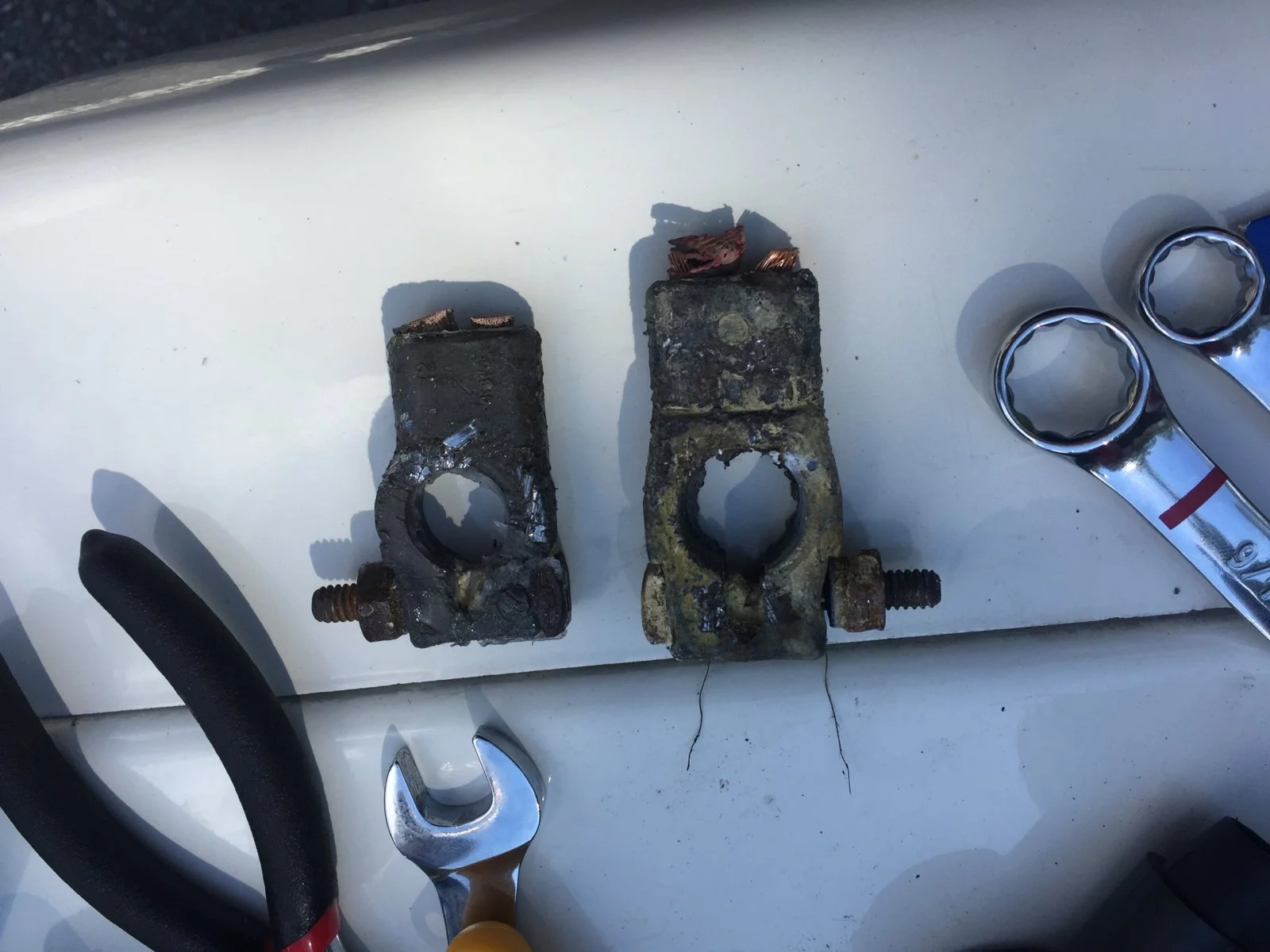

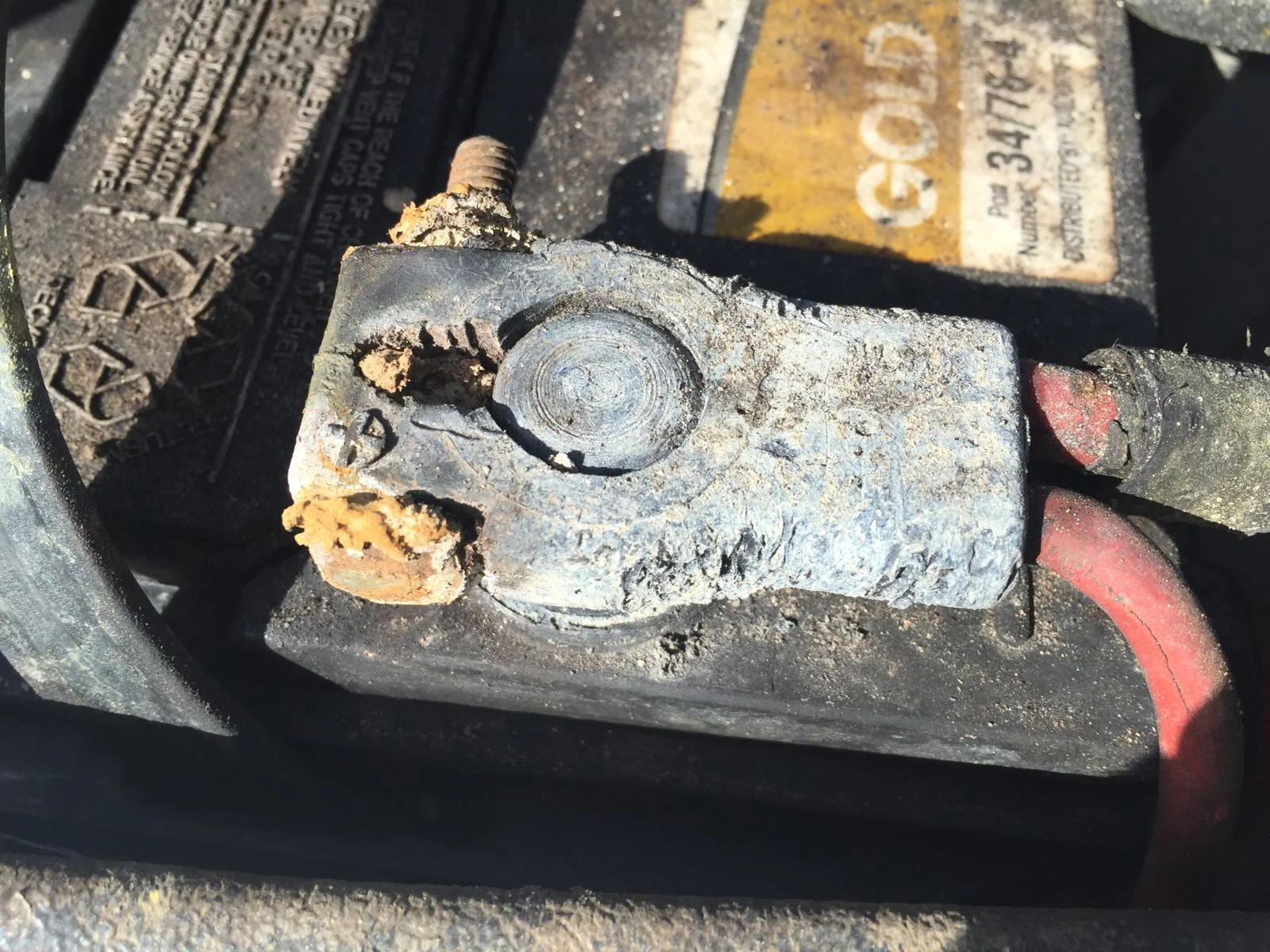

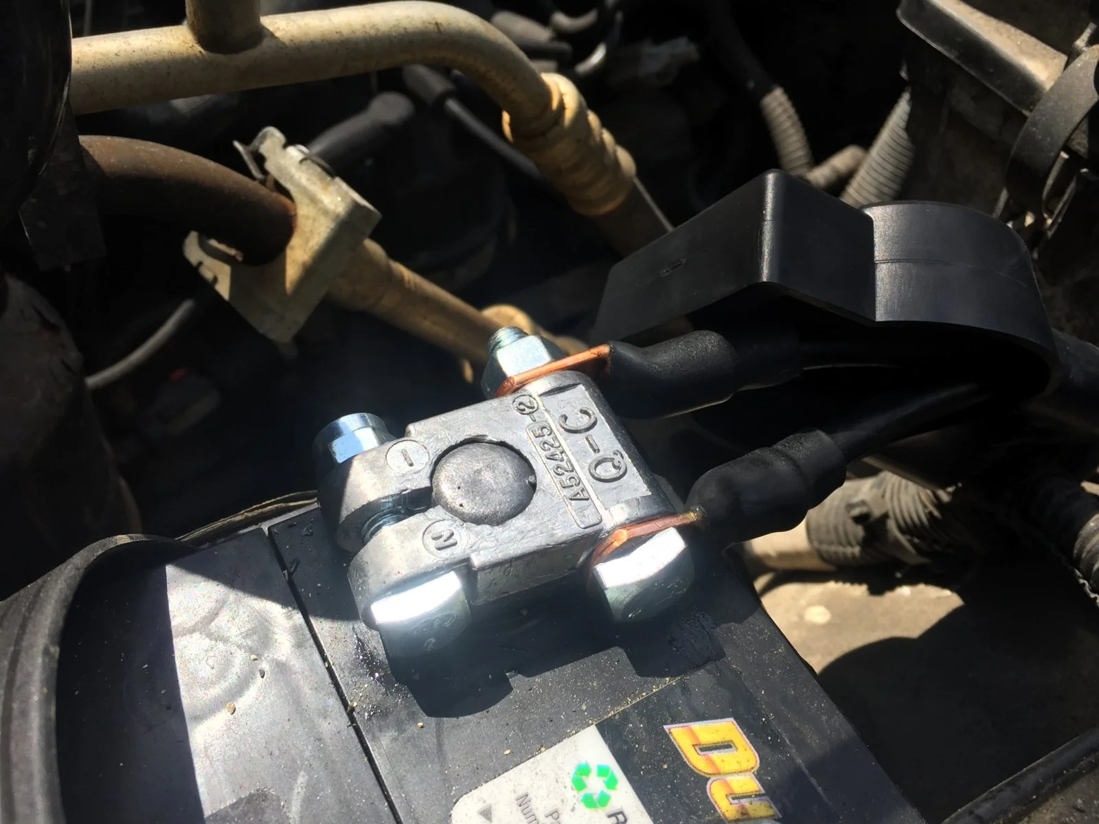

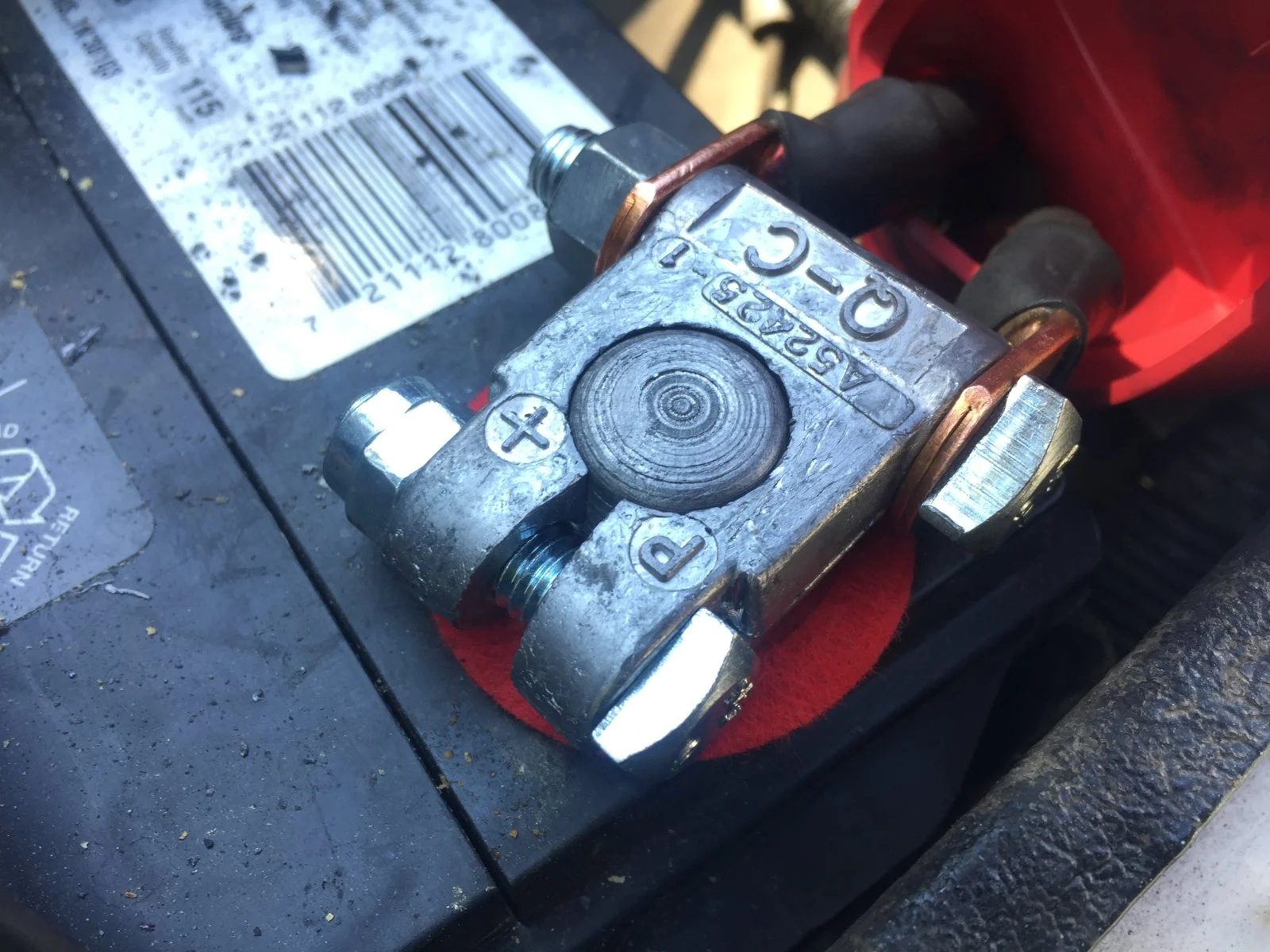

My cables were in good condition, so I opted to cut them & pull them out of their previous terminals and use a torch with solder in the copper eyes to attach them. 30,000 miles later still new as ever. Here are the photos before & after when I first got the Jeep. If I needed to replace the cables I probably would have had a shop make me a set. I'm interested to know why you wouldn't want to solder the cables to the copper eyes to attach to the battery terminal connector, because I thought that was the proper thing to do.
Reactions: mikespine and EJD
Crimped connections are the norm cause it's cheaper and faster, but I wouldn't fear the solder. Thing I don't like about crimped connections is it allows battery corrosion to form inside the crimp over time. Solder seals that connection. If your cables are getting hot enough to melt the solder, then you have a serious problem somewhere, imo. They make solder with different melting points.

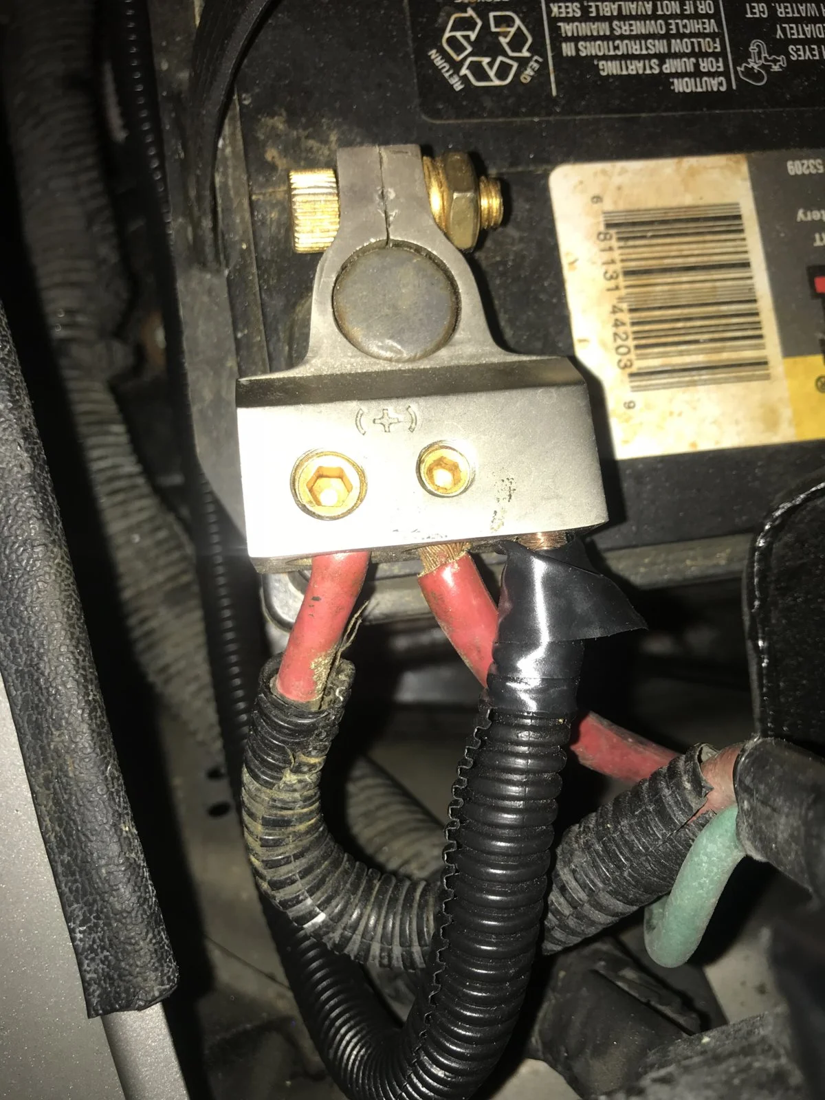

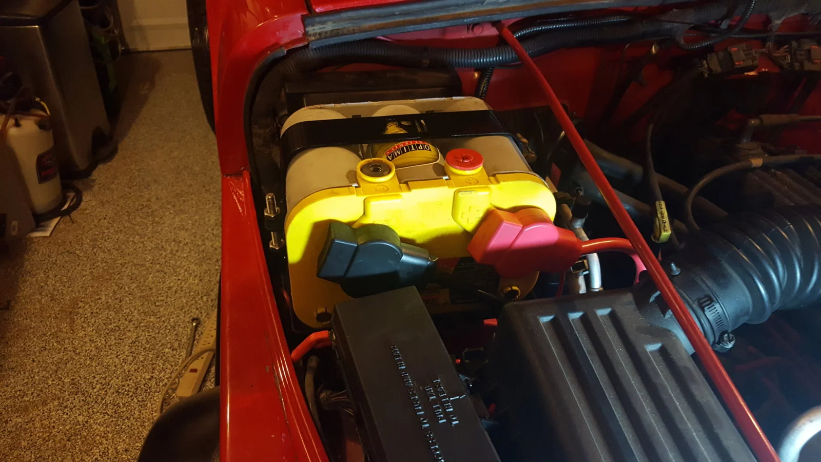

Here is my set up.
Terminals.
https://www.amazon.com/gp/product/B01LLWKXV6/?tag=wranglerorg-20
Cables
Came from EBAY from a store called genuinedealz
I would send a link but if I send Ebay links it only takes you to the front page for whatever reason.
I replaced all of my cables with two gauge on the primary battery and 1 gauge on the secondary used the terminals above for both batteries (both positive and ground).
The cables are quality and I buy all of my cables there. Never had any issues.
The cables are reasonable, but the terminals are expensive, but the look outstanding and they work good.
By the way same exact setup in both my TJ and my RAM truck.
